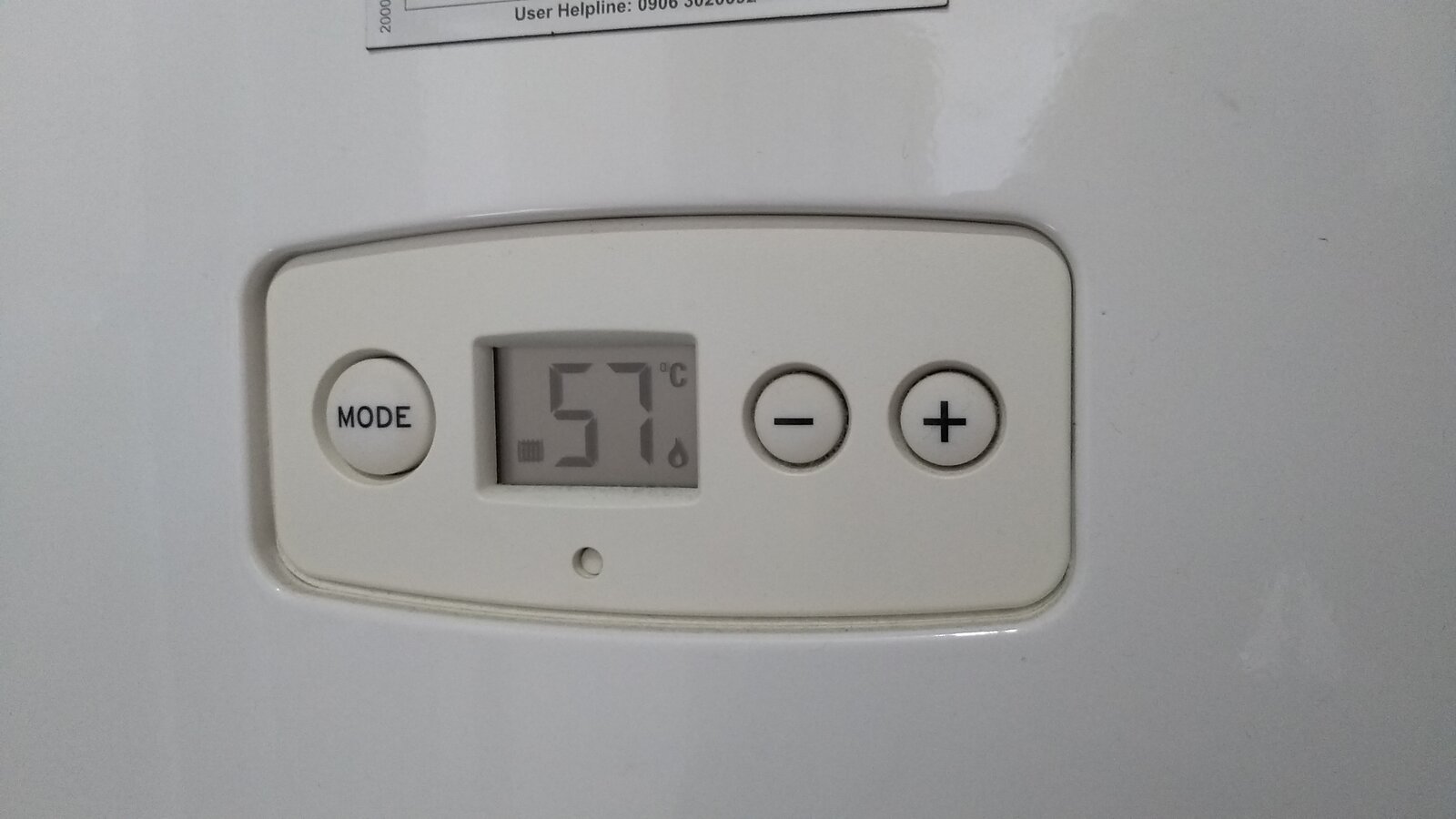

The room stat is in the hallway and is usually set about 25 but really never gets anywhere near that as the rad TRVs always kick in first. There is no stat on the boilier - only a facility to set the water temp which is set to 65. The Hot water is fine its the heating side, the boiler tells me the current water temp - either the hot water or heating water. The patten has been the valve gets power at between 29 and 31 degrees - heating water temp as read on the boiler but 3- 4 mins mins later the valve looses its power and closes - at this stage the temp read on the boiler has been anything between 39 and 55 degrees.

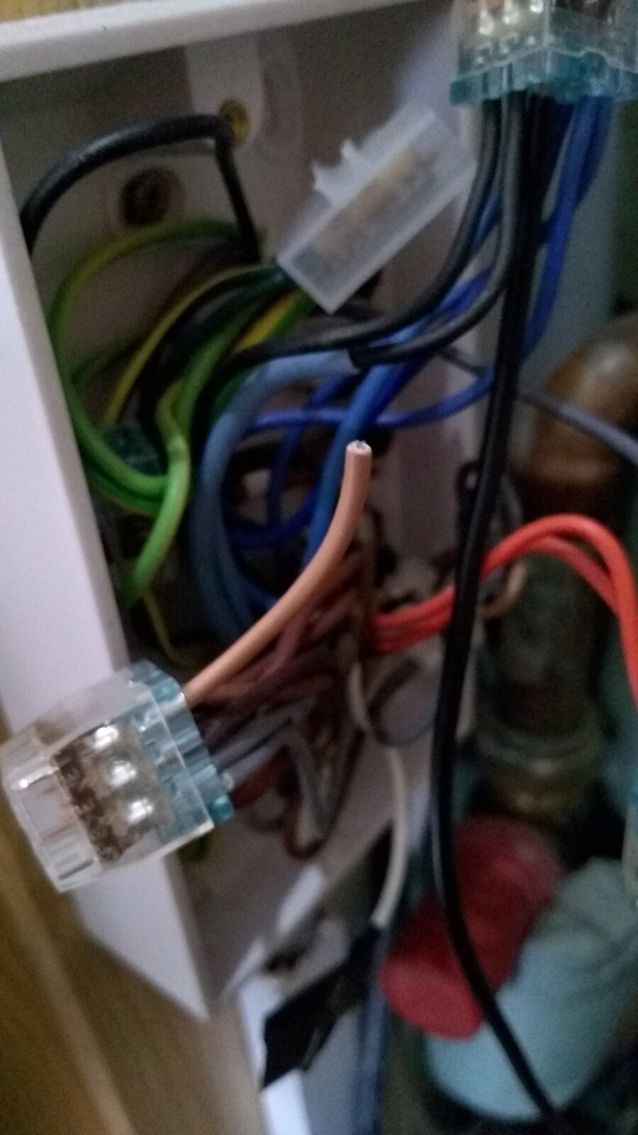

I have just noticed a rogue brown wire in the connector but cut off without any protection !
Although bad and I will sort it, if it was touching something I dont see how that would explain the behaviour where it would fire for 3-4 mins - cut off - and refuse to fire again until the heating water was down to 23/30. Also the box all the connections are in has not been touched in 11 years. Picture - yes you can see the inner wire and yes it is live and that grey needs pushing in a little more.
Also a picture of the boiler temp read out, which I think is the temp of the return water from the rads.
