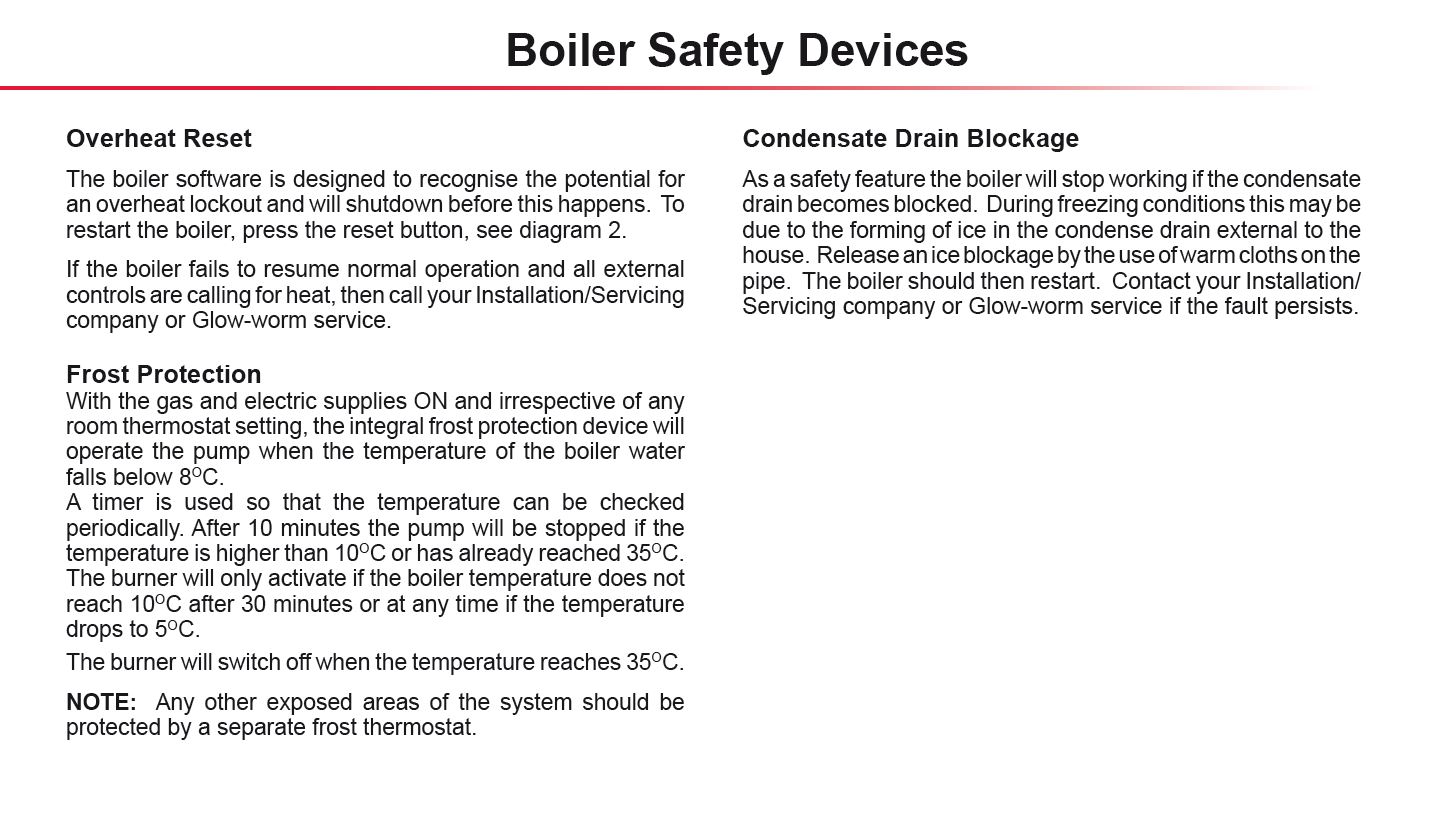

I dont know it its a factor but the boiler does have its own inbuilt frost protection.
Frost Protection
With the gas and electric supplies ON and irrespective of any
room thermostat setting, the integral frost protection device will
operate the pump when the temperature of the boiler water
falls below 8OC.
A timer is used so that the temperature can be checked
periodically. After 10 minutes the pump will be stopped if the
temperature is higher than 10OC or has already reached 35OC.
The burner will only activate if the boiler temperature does not
reach 10OC after 30 minutes or at any time if the temperature
drops to 5OC.
The burner will switch off when the temperature reaches 35OC
Those temperatures seemed impossibly high, until I realised the character before the 'C' wasn't a zero but was meant to be a degree symbol! :LOL:.
Yeh that's odd I copied and pasted from a PDF and that is how the extra 0 has been added for some strange microsoft reason. I have also took a screen shot of the pdf which is fine.
