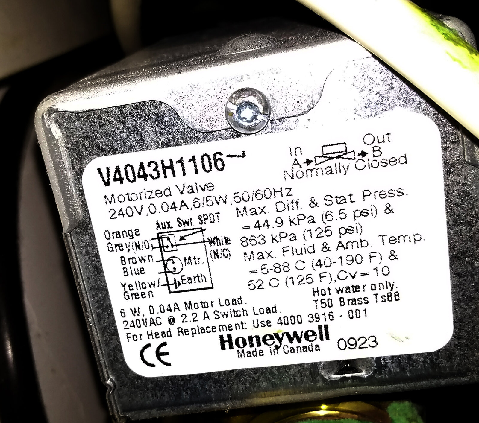

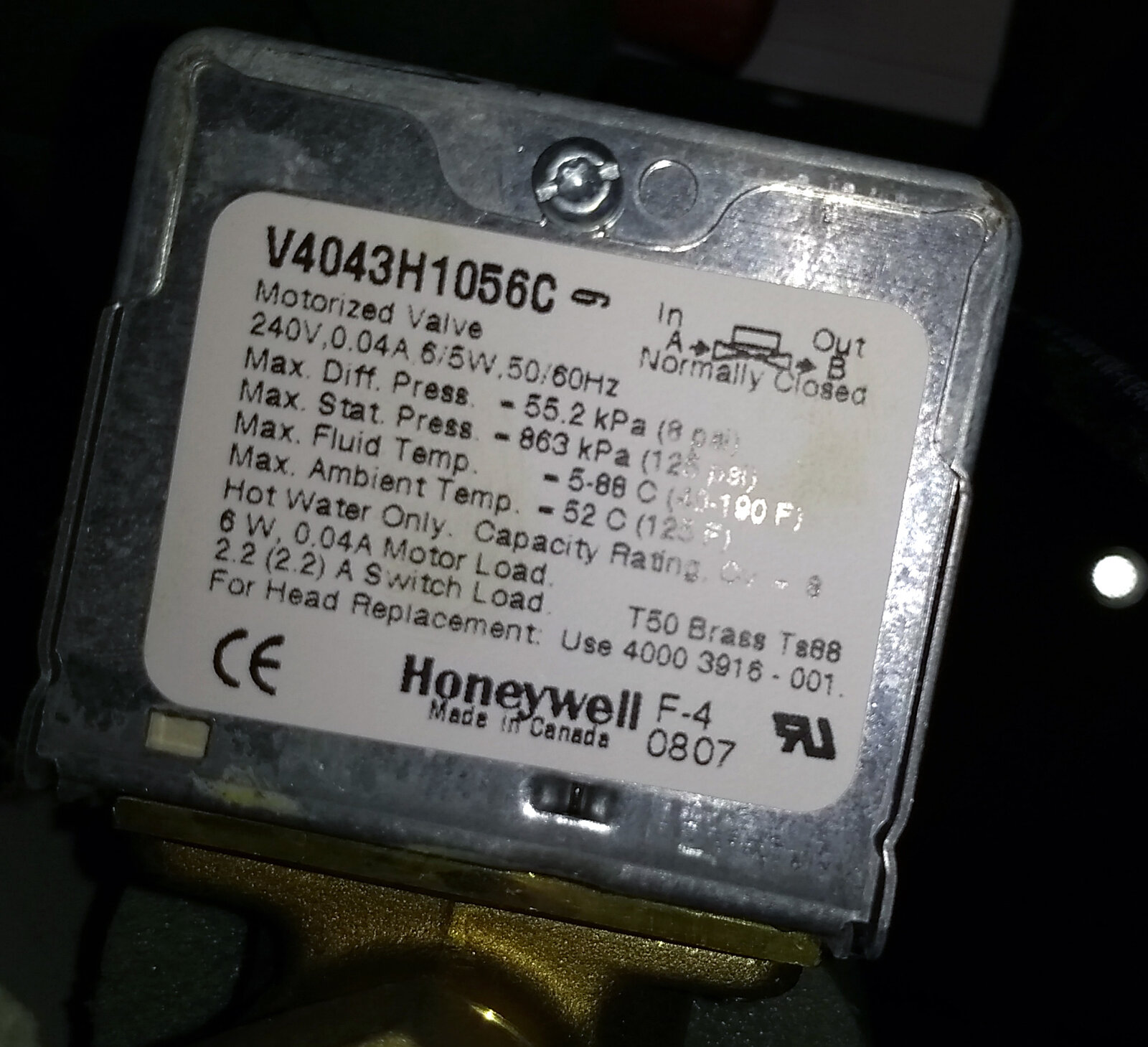

This is the label on the CH one
And this is the HW one
So the valve marked 'Hot water only' is on the CH pipe? Seems wrong. Does that marking imply the valve seal might be damaged by additives in the CH system?
They both say Hot water only - also the label says replace with the same 4000 3916 001
Perhaps it means Hot water only and not boiling water or steem

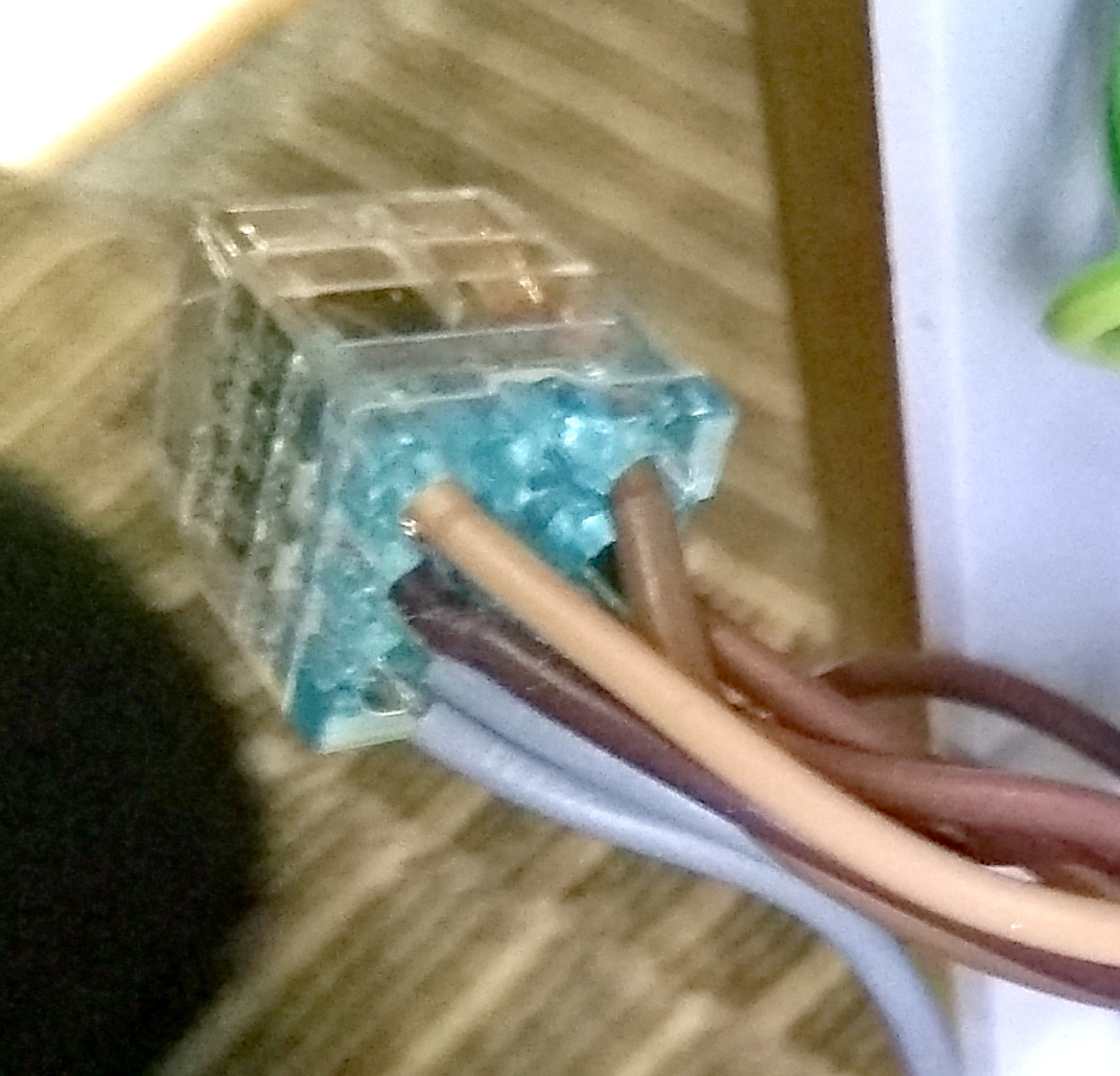

All this time I have been testing in the blocks in the terminal box but have been getting voltages because there are 6 wires in those blocks.

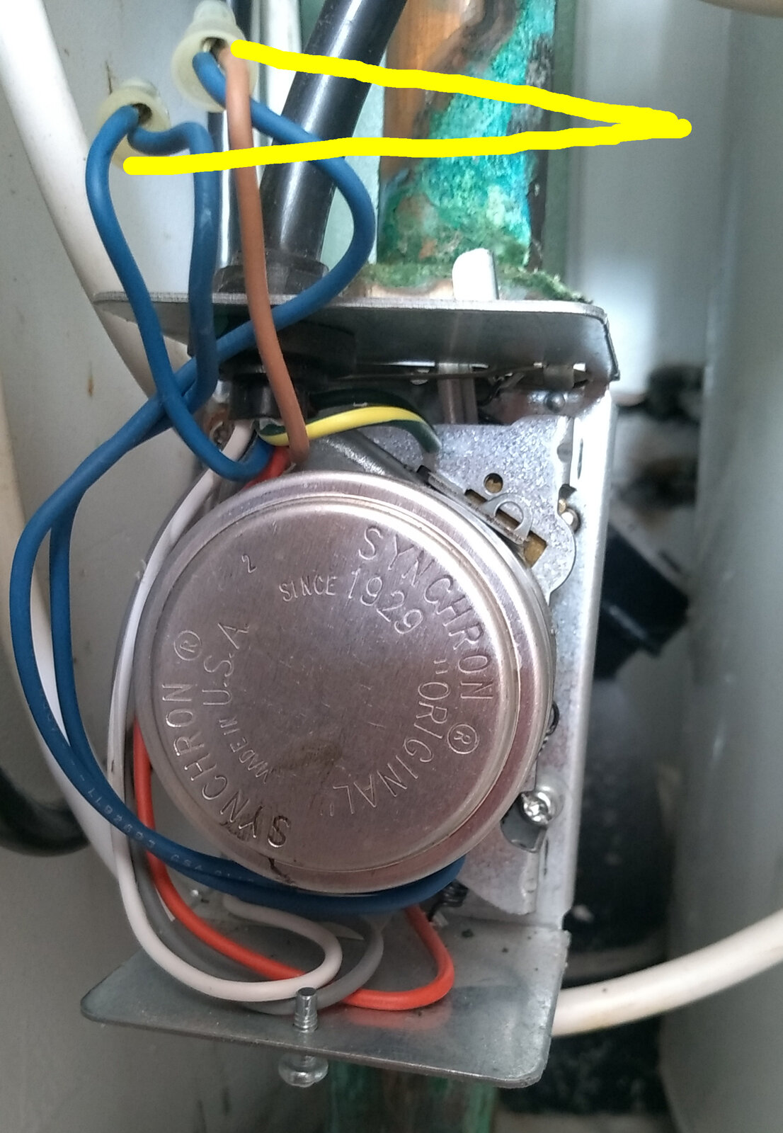

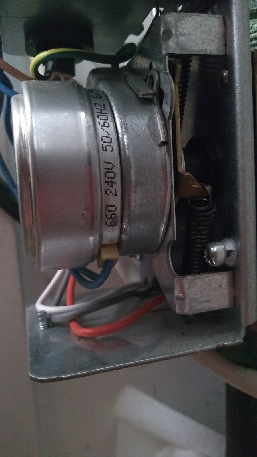

I removed the case off the motor and tested there and got 0V when heating was off and 240V when the heating is on -- so looks like the motor only want to work when it likes and only for a few mins but when it does work it fully travels to trip the micro switch.
Here is where I have just tested
Now where can I get a genuine Synchron ( not synchronus) one with the blue wires that they make for honeywell

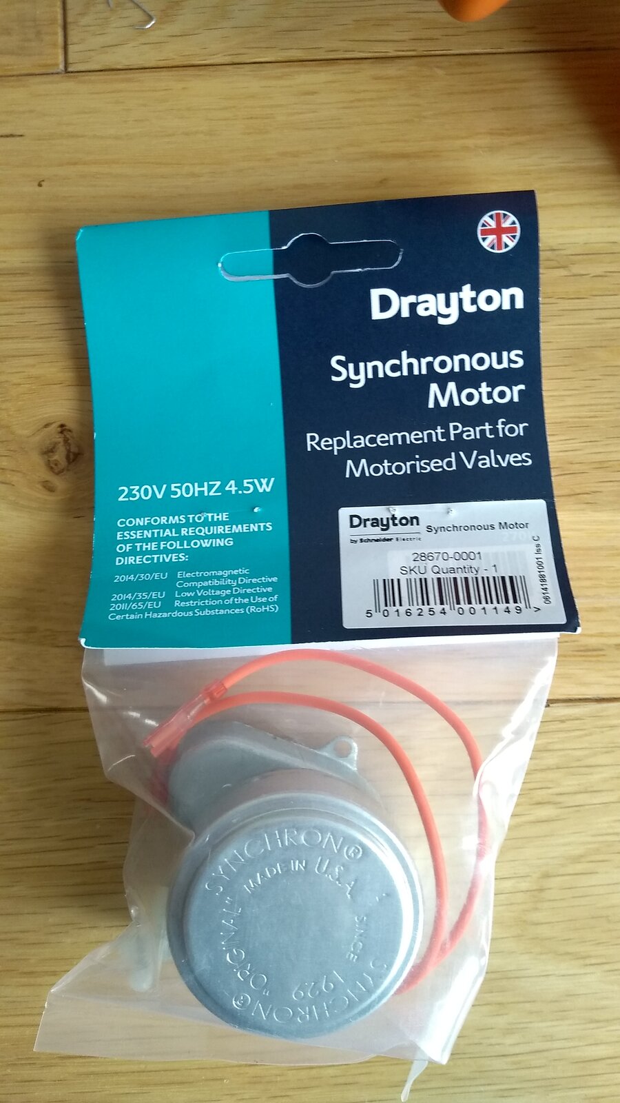

Srewfix 28670
Thanks. Came across that one and was confused by a reviewer talking about cheap Chinese ones. I understand what he was saying now. Cheap rubbish ones are labled synchronous but the OEM ach called Synchron. There is also an issue with replacements coming with either orange or blue cable. One website I found that was very helpful on the subject were saying that Synchron made for Honeywell come with blue wires and have a higher torque. https://www.freeheatingadvice.com/a...ve_motor_fault_Testing_a_Synchron_valve_motor

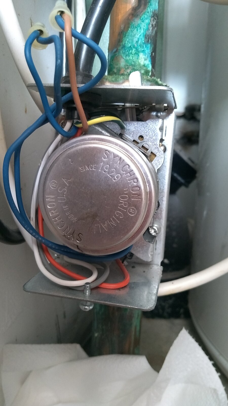

Without risking hijacking the thread or going off tangent: Check you don’t have a leak on the valve or near it too, your pipe appears green.
Yes it is a bit, I am fairly sure it is what happens when you do not wash off flux, possible plumbers maite on the threads also. I plan to give it a clean and will keep an eye on it.
An update. I have replaced the synchro motor and so far I am happy to say that it is working. Big thanks to all that helped.

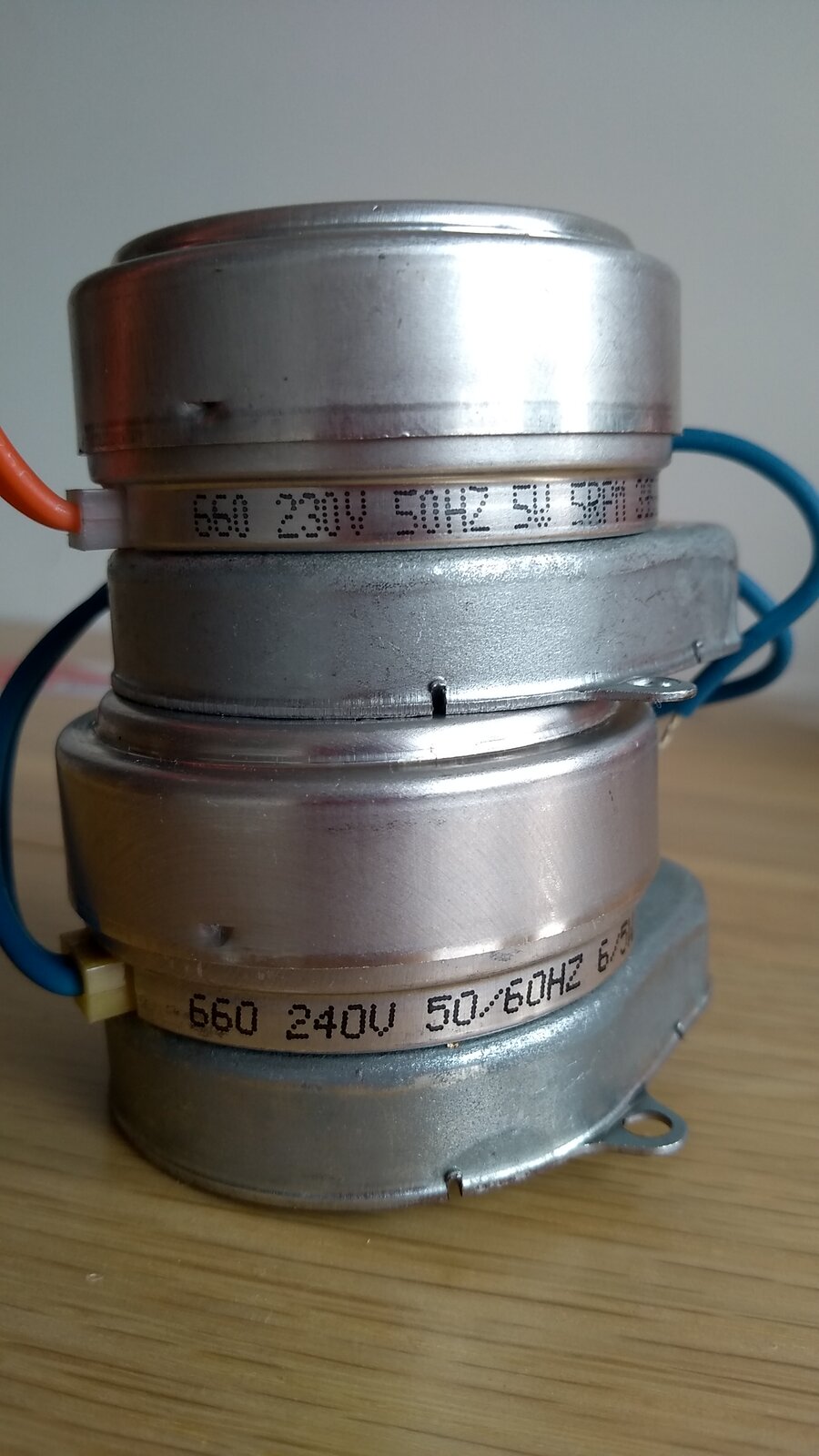

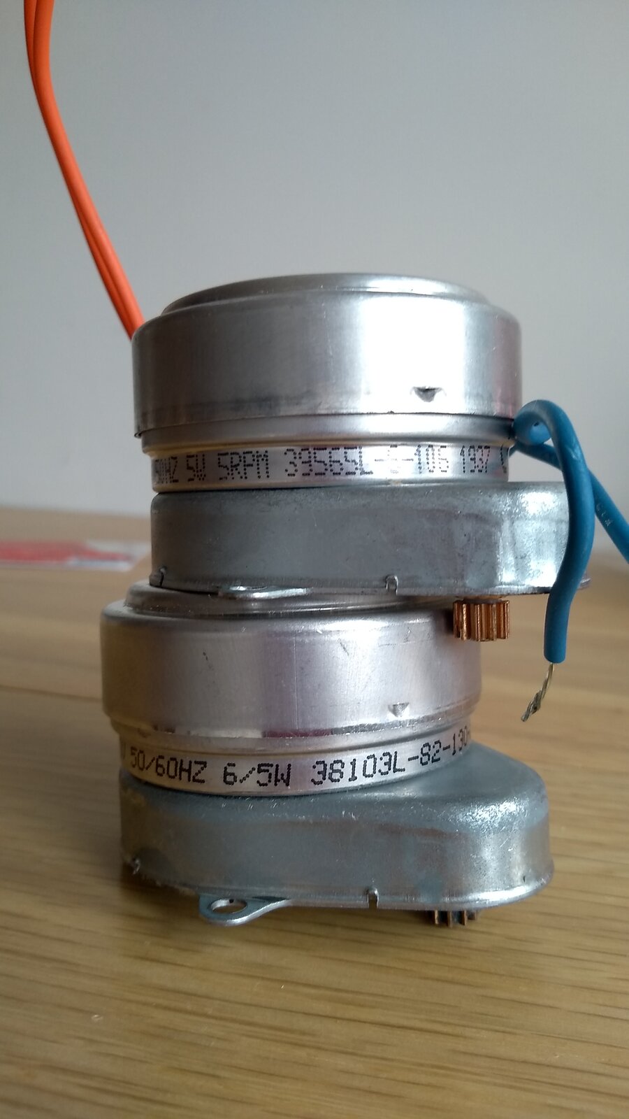

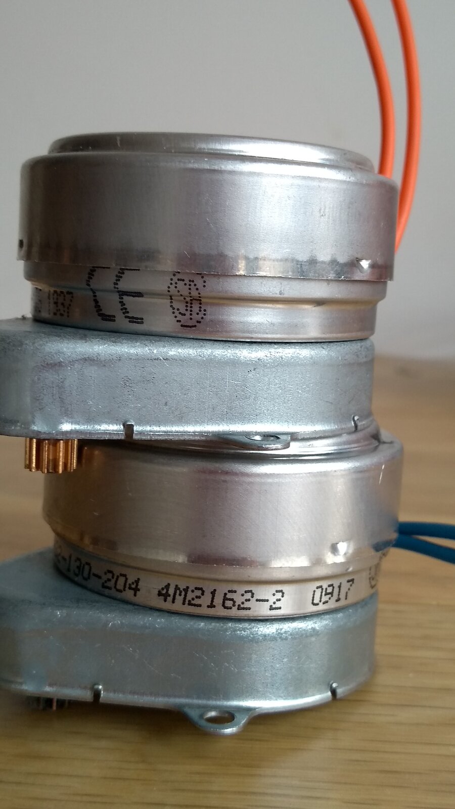

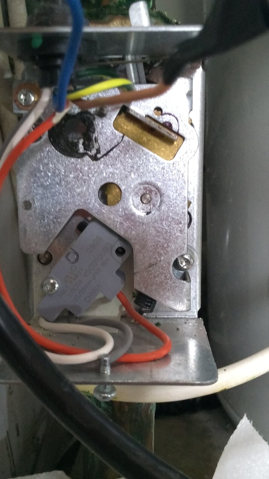

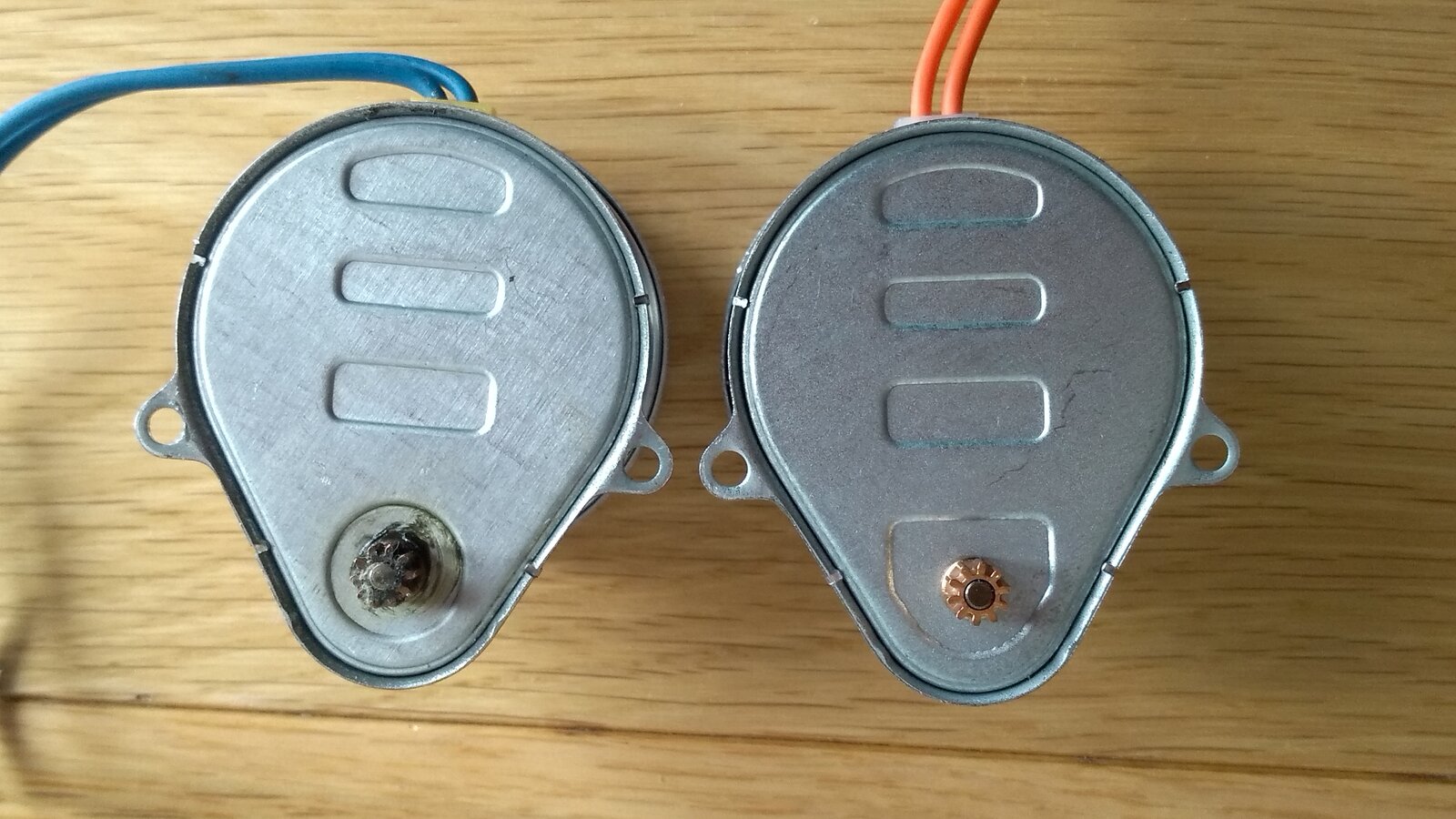

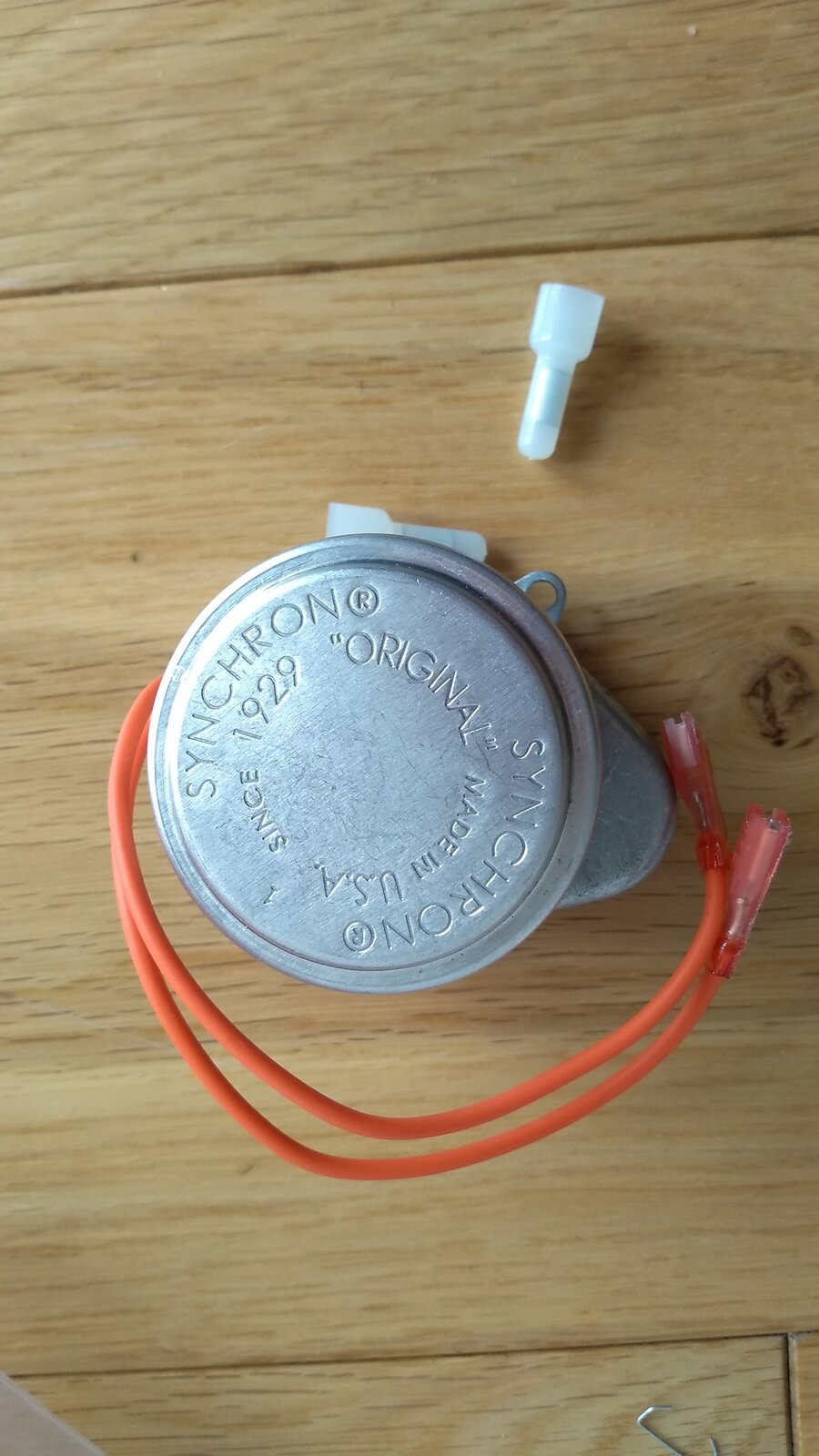

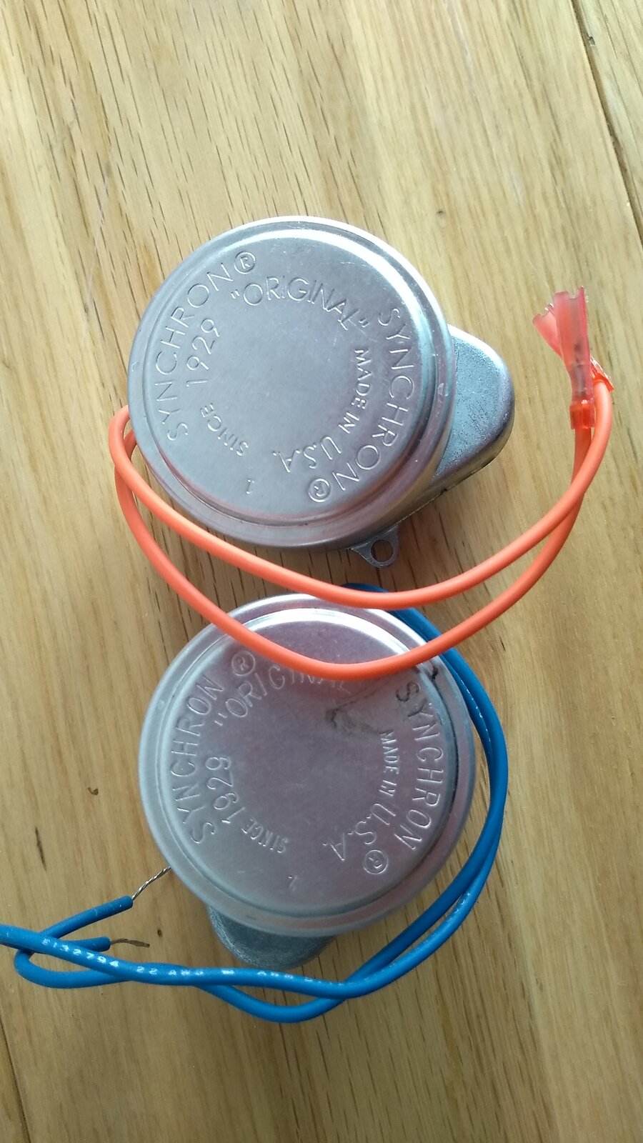

Turned out that my local supplier only had "synchronus" copy motors so I carried on to Screwfix and brought the proper Synchro one there. It is packaged as Draton but the motor I think is the same. Here are some side by side pictures that may be of use to others in the future, the old one has the blue wires. Last picture is the actuator with the motor removed, I did it with the unit still in place but electric off.
