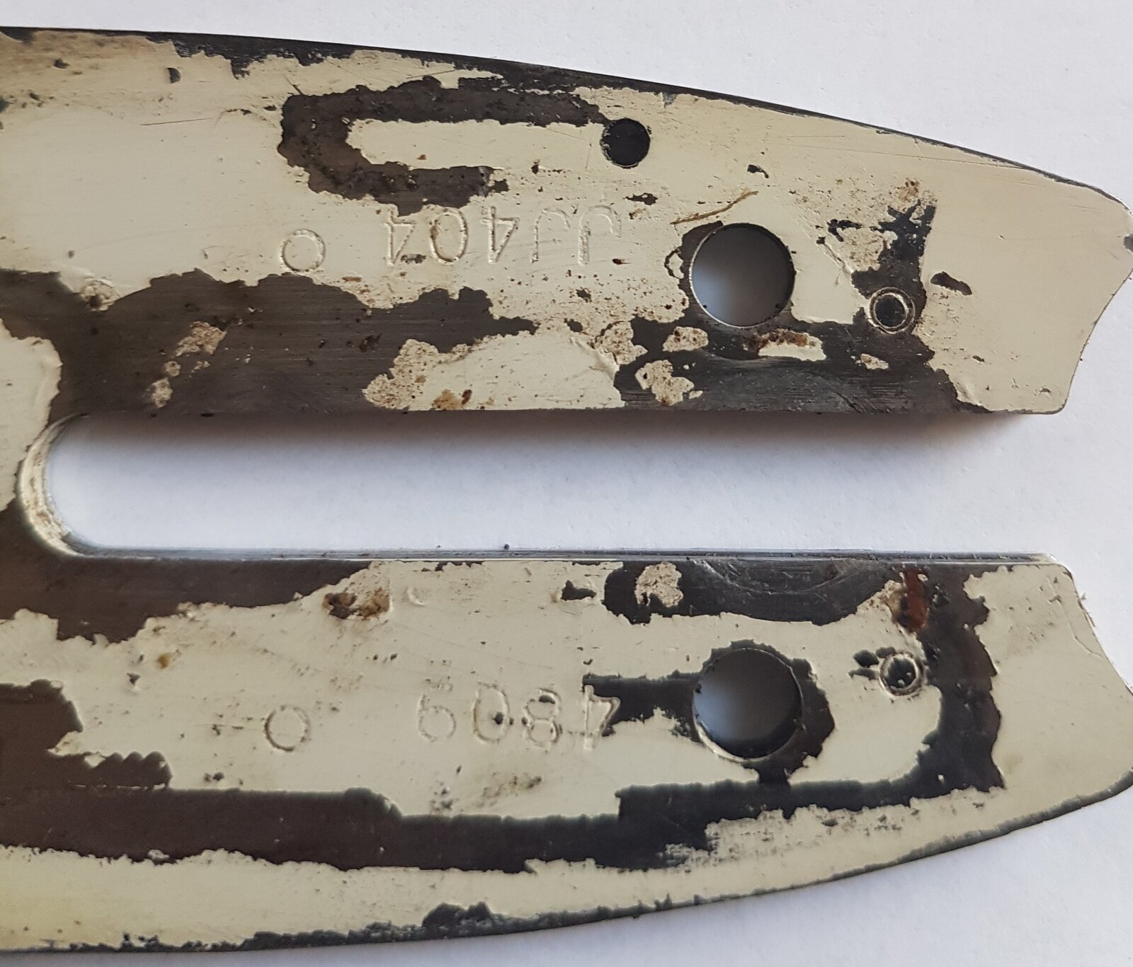

Here is a pic of my saw taken tonight without any proir cleaning, it is sharp and working well, it uses about 3/4 of a tank of oil to one of petrol, this chain has done a lot of cutting, it is not dripping with oil, the teeth are clean and shiny (they have not been overheated) and the depth gauges are about right. As I said earlier the oil is there for the bar not the chain.

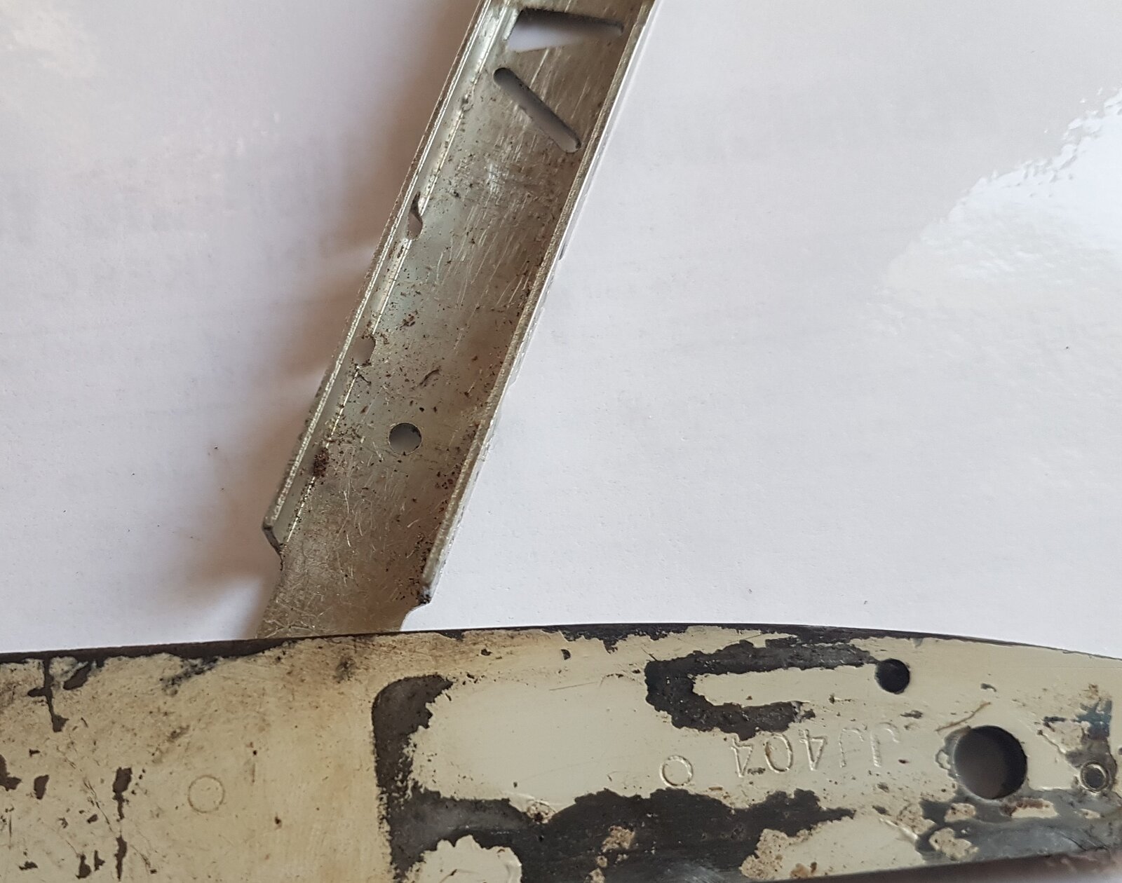

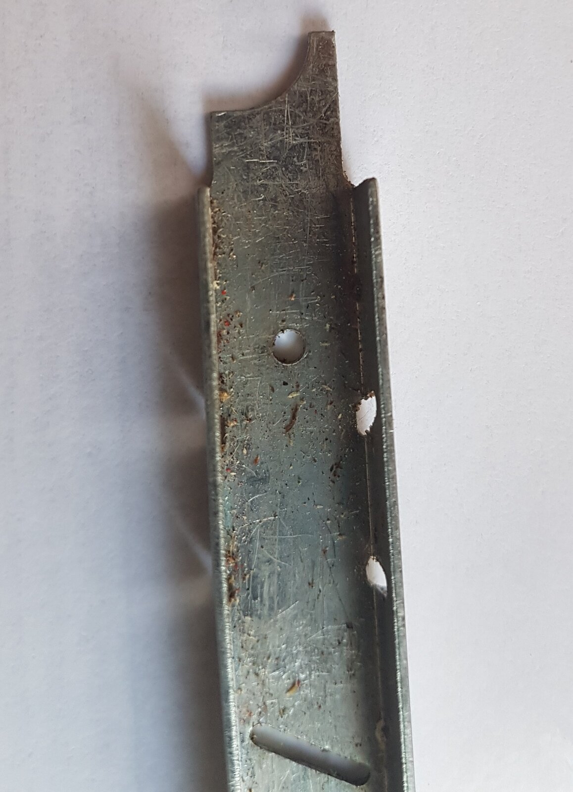

I can't see an oil feed hole in that bar!!. There should be one on each side opposite the oil feed from the crankcase, as in my photo. You should also have a multitool or a bit of broken hacksaw blade to clear the chain groove in the bar, otherwise even if there is a hole, the groove will become choked with sawdust and prevent oil from reaching the chain. There is an oil hole in each side of a bar as it is good practice to turn the bar over from time to time to even up wear from the chain.

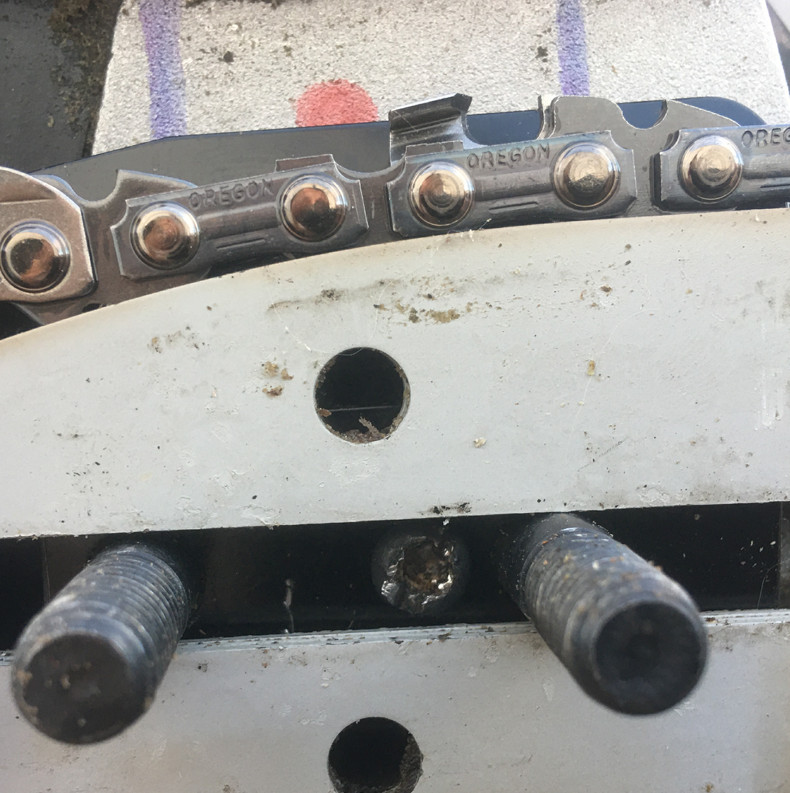

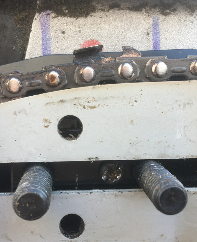

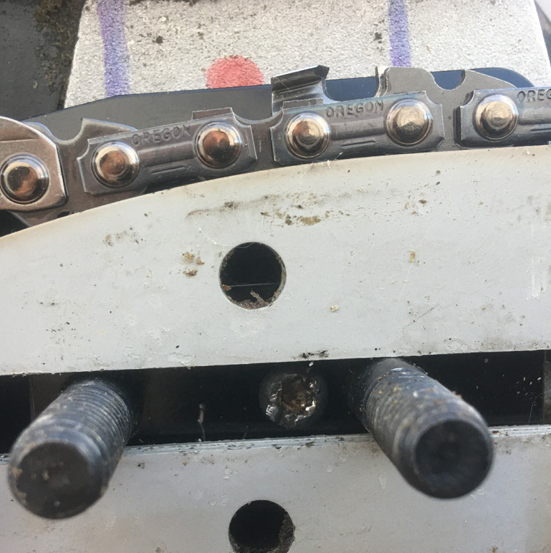

Blue is the space either side of oil hole.
Red is the oil hole.
Photos show 52 & then 53 link chain in place, do you see it ?

Take the bar and chain off and give us a picture of the area behind ?
The oil hole should be visible there.
