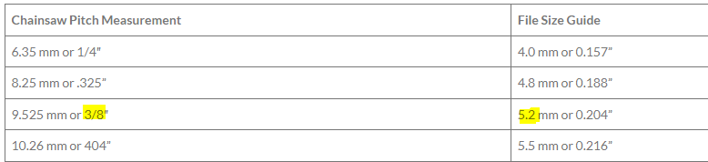

According to Husky website, 4mm is for 5/32 pitch.
Isn't mine 3/8? Then the correct size according to this chart is 5.2mm?
