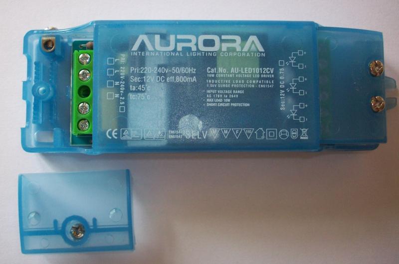

Do you accept this as an 'appliance', rather than 'accessory'?
I must say that I'm a little surprised that the flimsy bit of transparent plastic (hardly 'reinforced' to my mind!) protecting the 230V input terminals qualifies for Class II status - but, in any event, the point is that a terminal for terminating the CPC of the incoming cable is there. I'll see if I can find some better examples.

I've never said that it was. I have repeatedly stated that I was talking about a terminal (connected to nothing) provided for termination of a CPC - and it was in relation to that that you challenged me to provide an example.
Is it just me, or are there some mobile goalposts floating around this discussion?:)
Kind Regards, John.
So, what is it about that device that provides the Class II requirements.
The terminals are not double-insulated nor does the cover look reinforced.
In fact, it looks no better than the accessories which lead to the original query.
As we don't seem to have access to the standard (BS 2754) that specifies exactly how an appliance might meet the requirements, any criticism of it's construction is not much better than guesswork, really.
The manufacturer (Aurora) have stated that they have constructed it to meet the requirements of the standard (by using the Class II mark), and unless we believe it is a fraudulent claim, we should take their word for it.
If you do believe it is a fraudulent claim, it should be pursued with Trading Standards.
