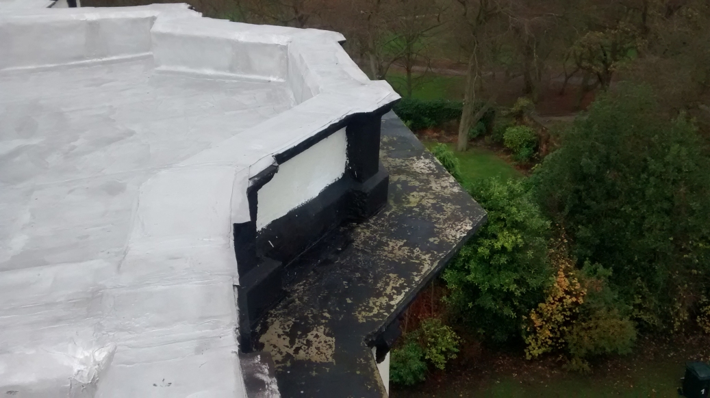

I'm preparing to spend some money on my roof. I've had 3 companies around and all 3 have said that my roof, when done back in 2014, should really have had lead put around the top of the parapet (if I'm using the wrong word there, forgive me, I mean the big chunky bit that is sticking upwards).
I've asked about this roof before on the forum (but, back then, I was focused on the horizontally projecting parts - the "projecting eave" as ree called it?) and only now have I progressed to doing something in anger / professionally about this (I did paint the horizontal bits with Thompson's One Coat Roof Seal).
I am not against them putting a lead covering around the parapet. It seems like a sensible thing to do, even if the parapet does not have questionable integrity, in my mind, a lead 'hat' should give it many years of sound protection.

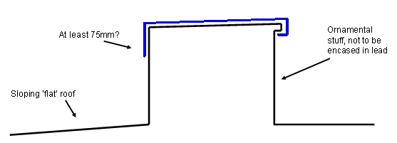

The capping should be done in code 5 or over : It should be fitted in lengths of 2m maximum. The sections should be joined together with interlocking welts, each upturned welt should be fixed down with either copper or stainless clip screwed into the brickwork.
The lead should be turned down the side of the wall by at least 75mm. Before turning the lead down a continuous lead or copper clip should be screwed to the wall , when the lead is turned down it should be welted around the clip to prevent wind uplift.
This is a cross-section of what my 'parapet' looks like, is this bit what you mean by "at least 75mm" and is the more I have here the better?
It seems crazy (to me) that the lead won't actually protect the outward-facing part of the parapet, but it cannot because that bit is all ornamental and the house can't look like it's sat in some kind of full metal top-hat.
