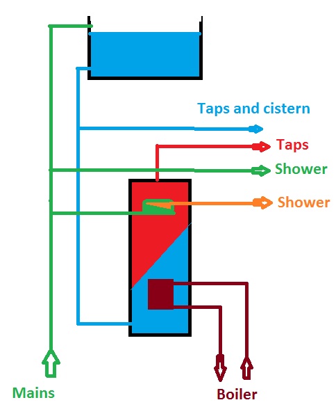

Mains pressure showers can be achieved without the cost and maintainance that an un-vented cylinder entails.
A second coil in the top of a vented hot water cylinder provides mains pressure showers and from the cylinder copious hot water at low pressure for basins and baths etc
This is an old sketch of my system
Interesting idea. However if replacing the cylinder anyway (which we are) I would be surprised if there was much cost difference in the cylinders or maintenance* and you get your loft back.
