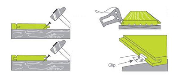

I want to put T&G wood panelling up in a loft room. I am looking for T&G wall clips. I have seen pictures on the internet, but I am unable to find shops / retailers that do them. Any ideas?
I have got another question. We did the loft as part of an extension with thick insulation, heating and loft windows. The walls are plasterboarded. Can I nail the T&G panels straight through the plasterboard into the rafters or do I need to put timber / lath subconstruction on first?
Firstly, have you considered secret nailing by pinning/nailing throught the tongue? You can also go through the groove as well (see below). Alternatively Wickes used to do them, although I'm not sure if they still do, although a number of timber yards I've dealt with still stock them because they sell T&G cladding. The main UK distributor for the stuff I've used in recent times (Silverwood) is Proctor's - you may want to ring them and ask who they distribute through in your area. Other makes include Simpson's Strong Tie (American but distributed in the UK through trade outlets)
