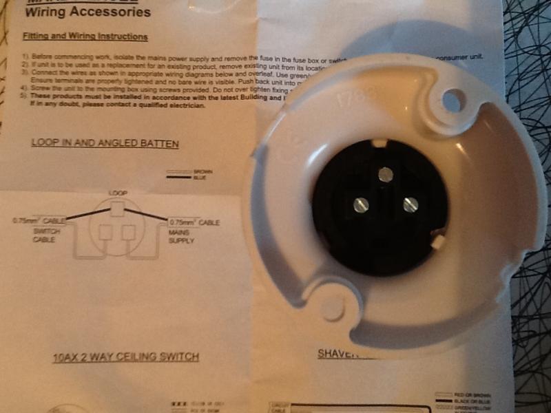

Now I look a bit more closely, I am more confused than I was before! This is my light fitting (sorry it's hard to get it to catch the light):
The wiring diagram shows a mains cable passing through the fitting, en route to a switch. Now, my school electronics tells me the neutral terminal here is actually not doing anything since a light is a one-wire affair - the live wire passes through the light to the switch, and the neutral comes back from the switch.
What exactly is going on inside this terminal - and can I use it more like this:
[code:1]FCU=========/switch/========light[/code:1]

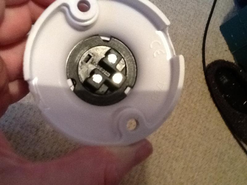

In my second picture I think you can see the middle terminal has an earth symbol, which doesn't match at all the instructions. Is this saying I can attach live & neutral across the light and attach an earth wire to the middle one? Then I could do what I want... but I want to be sure I understand how the fitting actually functions internally.
Are you sure that middle terminal has an earth symbol? It's a loop-in terminal for the neutral.
It seems to have both. In my photo you can see "LOOP" but to the right of it is definitely one of these:

Have a look at the Wikis. Normally the L, N + E pass through pendant part which is attached to the ceiling. They are often marked as loop. From this the live goes to the switch and back to the fitting (it may be marked L or SL). Although it is live it will be blue or black and is not neutral so needs a brown sleeve. One core of the flex to the lamp is connected to this terminal and the other is connected to the neutral in the pendant. The earth terminals on pendant loop and lamp are connected as you expected.
This wiring diagram was drawn by a dangerously ignorant idiot:
Do NOT wire it up like that, with a switched neutral.

A light can be wired like that, if you want.
No, I can't,
Indeed not, but the instructions were written (at least in part) by a dangerously ignorant idiot.
If it is an earth terminal then it's a case of must attach an earth wire, not "can".

It would work, but would be potentially dangerous (which is always the case when one switches a neutral). The 'why' is pretty obvious. When the switch is 'off', the light will go off because there is no complete circuit (the neutral connection has been interrupted - however, there is still live electricity going to the lampholder, even though the switch is off - you can presumably understand why that is potentially dangerous?
For this reason, switching (of anything) should always been in the 'live' (line, phase) conductor, not the neutral.

You can't see that the diagram shows the neutral being switched, but think you're OK to fiddle with electrics? That's rather scary.

Um, the live wire comes from the live terminal of the FCU to the live terminal of the switch, with the light fitting in the middle.
Then where does it go? If "nowhere", then what's the point of having it go to the switch? If "somewhere", then what is the switch going to control, as it won't be this light, it's already got it's live supply - the cable goes there first, you said.
The neutral goes, un-broken, from the neutral terminal of the FCU to the neutral terminal of the switch...
Ah - it's a double pole switch then? Better be, if you plan on connecting a neutral to it.
And where does the neutral go then? You don't say it goes to the light, so (a) where does it go, and (b) where does the light get the neutral it needs?
