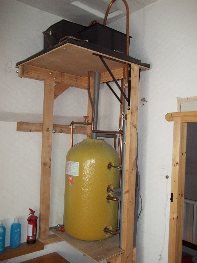

This is my cylinder, cold water tank and header tank. ( during installation )
Surface of cold water cistern ( tank ) is only 2.2 metres above the level of the bath taps. Plenty of flow, bath fills quickly.

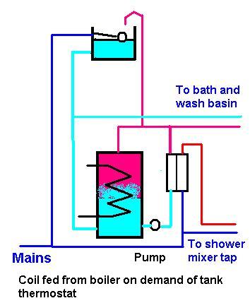

Have you got your HW cylinder almost setup like some type of open vent/thermal hybrid @bernardgreen? On one side it's acts as a normal vented cylinder with gravity HW out to the normal outlets but the top coil is used to provide mains HW to the shower?
How do you balance usage? If you've used up the hot water via the outlets then you need to wait until the cylinder recovers and vice versa? I take it it's a solar/HP cylinder with the 2nd coil like that?
I ordered the cylinder direct from the manufacturers as a standard cylinder with an extra coil at the top. The original plan was to use a pump
and plate exchanger.
I actually bought the plate exchanger before discovering the cost of the tank with the second coil was low enough to change the plan and avoid the problems that a pump and plate exchanger would create.
There is very little usage as the cylinder only supplies the bathroom and separate toilet wash basin.

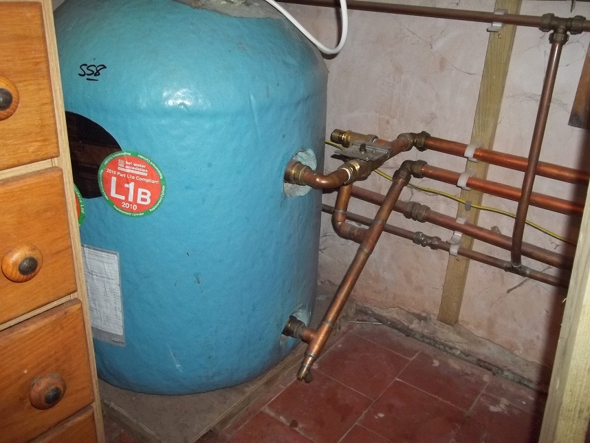

It is a second cylinder in the kitchen that supplies hot water to kitchen, utility and downstairs toilet. It is fed from the cold water cistern in the bathroom.
This "crazy" installation was necessary due to the layout of the cottage and it's kitchen "annex" making very long pipe runs between bathroom and kitchen.

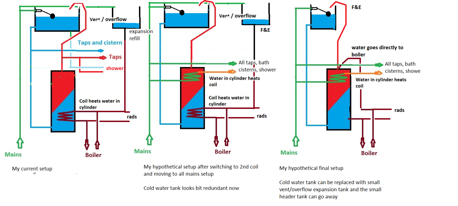

So this is my setup and planned changes in pictures, no part of the system is sealed.

Just posted drawings above that include the existing setup and planned changes with coil cylinder.
No part is vented. 10% F&E sounds reasonable.
