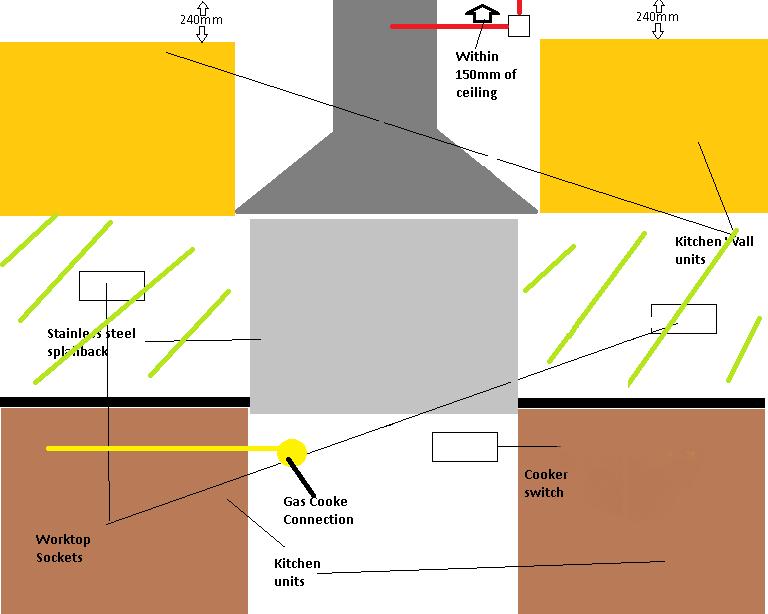

Please see the diagram below, showing the new proposals to ensure compliance as per the spirited discussions that have led before
Hope this satisfies all
Btw, I'd really like to know, how wiriing, embedded behind tiling and mostly behind a splashback (which will never be drilled into, does not constitute as a safe zone?
The even more puzzling thing is how can the FCU, to be mounted almost 2.5 metres above floor level, is easily accessible for easy isoloation in the potential event of the chimney becoming live or it sucking up a pan fire be acceptable? It just doesn't seem like that is a common sense approach. - Not meaning to say the advice being given is wrong or that I don't agree, I understand some of these things are out of our control, I just think it's very odd way of defining safe zones
Surely it'd be much better placed alongside a socket above the worktops ?

It is most unusual to run the cooker circuit directly to a point under the worktop; are you sure it is as you think?
From which direction did the cable come to the switch?
Please see the diagram below, showing the new proposals to ensure compliance as per the spirited discussions that have led before ... Hope this satisfies all
From the point-of-view of cable routing, that would be fine. In fact, the FCU and horizontal cable from it do not need to be within 150cm of the ceiling, since the FCU creates a horizontal 'safe zone' for the cable regarless of how far it is from the ceiling.

Despite the length of time taken & the extra work entailed I would prefer to do it 'properly' but now I'm getting conflicting info

So put the Cooker Switch above the work top, spur off the FCU and then flex from the chimney into the FCU, but then comes all the issues with the cabling, where would that go? the only place would be up through the centre of the chimney, but as we'lve already gathered it's not a safe zone, and also if I don't have enough 6mm cable left it would mean creating a junction in the 6mm wire, and I really don't want to do that, I can imagine the issues that could arise from that!

Could someone, PLEASE amend the diagram showing how it would be safe zone & compliant by having the FCU above the worktops & how the wiring would be done to ensure the cabling is within the safe zones & without going behind the wall units
I don't believe I have enough give on the 6mm cooker cabling in order to bring it up a metre or so
The cabling comes from the left, (from the Mains RCD under the stairs and adjacent to the kitchen) along the floorboards (soon to be under tiling), behind the worktops and up into the walls (chased) and then into the cooker socket as shown on the diagram
You really should have thought about cable routing before you fixed the wall units!
The new wiring for cooker switch was only done recently, well after the cupboards were put in hence the reason they are behind the floor units
Despite the length of time taken & the extra work entailed I would prefer to do it 'properly' but now I'm getting conflicting info ... EFLI says

I don't think there's really any conflict. Both are really saying that there is absolutely no point in having an emergency/isolation switch hidden behind the cooker, so there's no point in having such a switch there. Unless you were prepared to do without a switch at all, that would mean moving it to a conventional location above the worktops, with a cable going from it down to an outlet plate behind the cooker.
Both Simon35 (per my diagram) and BAS have indicated ways in which it can be done. However, given the wall behind the cooker is not a safe zone (other than in the eyes of flameport), the ONLY (as far as I can see) way of getting a compliant feed up to the hood from a conventionally-placed cooker switch would involve the cable going behind wall units - which you say you don't want to take off. ... which, unless you change your view about the wall units, seems to leave no options other the 'feeding from above' approach (which leaves the only means of isolation of the hood in a daft place).

OP, just take the wall units down, chop out for the cable and patch it up. They will go back up just as well as they came down....unless they have a pelmet or cornice round....

I would be happy to move the cooker switch, put a joint in it to ensure it's in the correct place and easily accessible but I really do not wish to take the wall unit off, I am sure they will not go up as sturdy and I can't afford to take that chance
If it was a new-ish kitchen or a full refurb I'd do it immediately but it's a partial refurb so will just stick to having the cable feedling from the bedroom above and have the FCU in a stupid position
When I come to do a full kitchen refurb / extension in a couple of years (at least) I'll rip it all up and get it all done properly

Do I take it that you can get at the wall behind the floor unit to do that?
yes as I mentioned before, I have a void of around 100-150mm behind the floor units, I will be able to pull out what's already channelled & move it across 5/600mm, then up the wall behind the units, channel in from where it becomes accessible from above the worktops & install the switch inline with the socket already there

I agree it is a pity as I am not one for taking shortcuts or not doing it the 'proper' way if it can be helped
I understand what you mean about the cupboard being 'iffy' but it is not so unsafe as I make out, the two main raesons are that my house is a complete mess, and taking on more additional jobs, when there are 'reasonable' workarounds available as I don't have the time to factor in things such as a removal of a wall unit which I never anticipated
Channeling and re-wiriing is probbably an extra couple of hours in the day but to remove all the dishes, put them somehwhere where they won't clutter a room or fall and break, then removal of a unit (single handed) just is too much of a headache to take on than I already am
