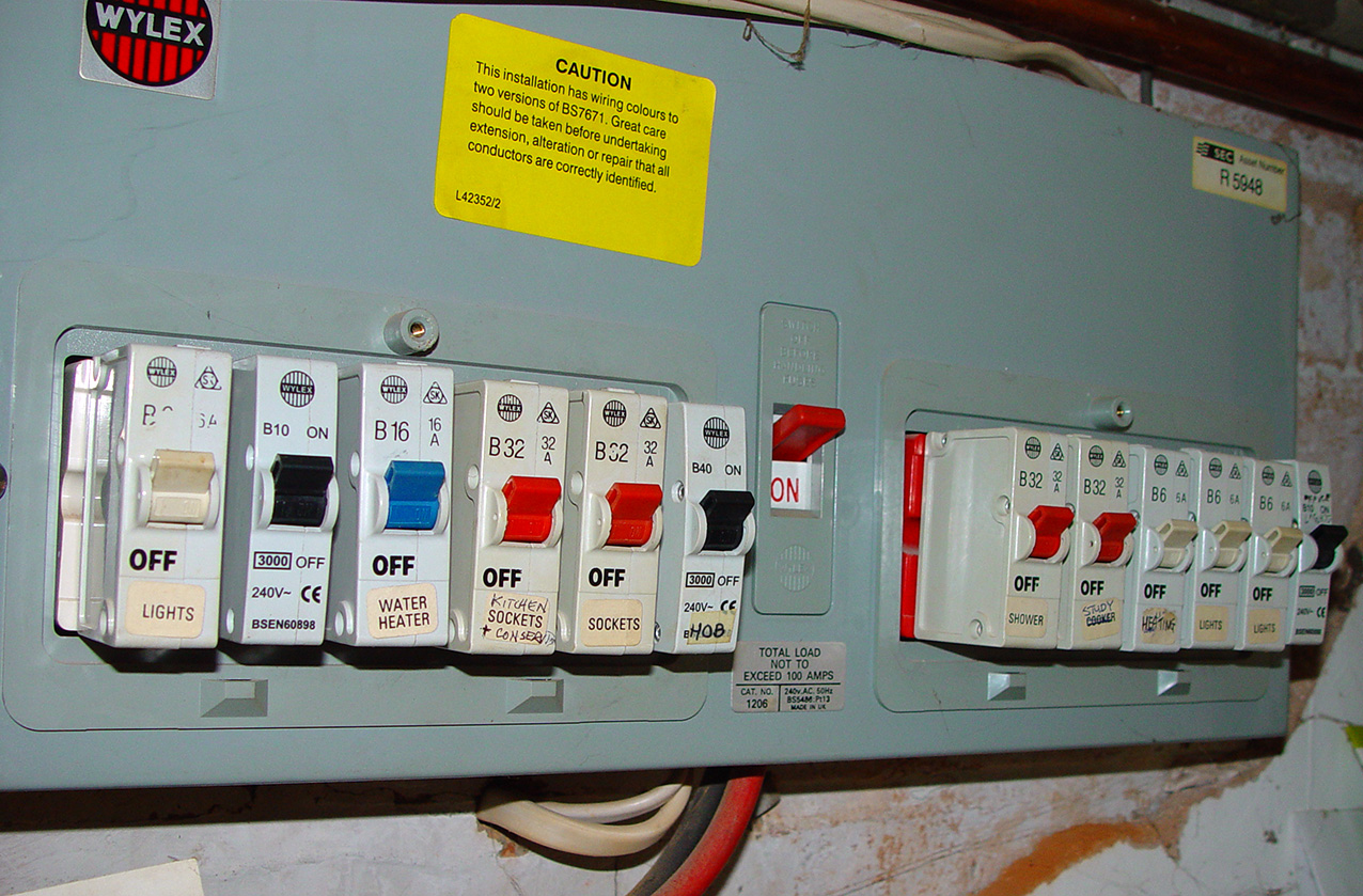

There is a 40A fitted to that, (and it's next to the switch, and so is the shower one), so unless the tab has been incorrectly cut off, it allows 40A ones in some cases
Thanks - that's a relief …and so I won't fret about upgrading my shower fuse from 32 to 40a.
But I'm getting confused about the different types - and prices up to £30+ - of Wylex B40 40 amp fuses I can buy. I've found this one at £5.40 but it sounds like it won't work in my old-school CU:

40A MCBs for that fusebox are obsolete. 6/10/16/20/32 are the only values available now, other than dubious used efforts from ebay and other vendors of tat.
Thank you - I wondered why they were hard to find.
It might be possible to use the 40A 'hob' one for the shower and the 32A for the hob, however that also depends on whether that particular fusebox can support 40A devices at all - many were limited to 30A maximum.
Those that can do 40A devices typically only allowed them to be installed in one specific location.

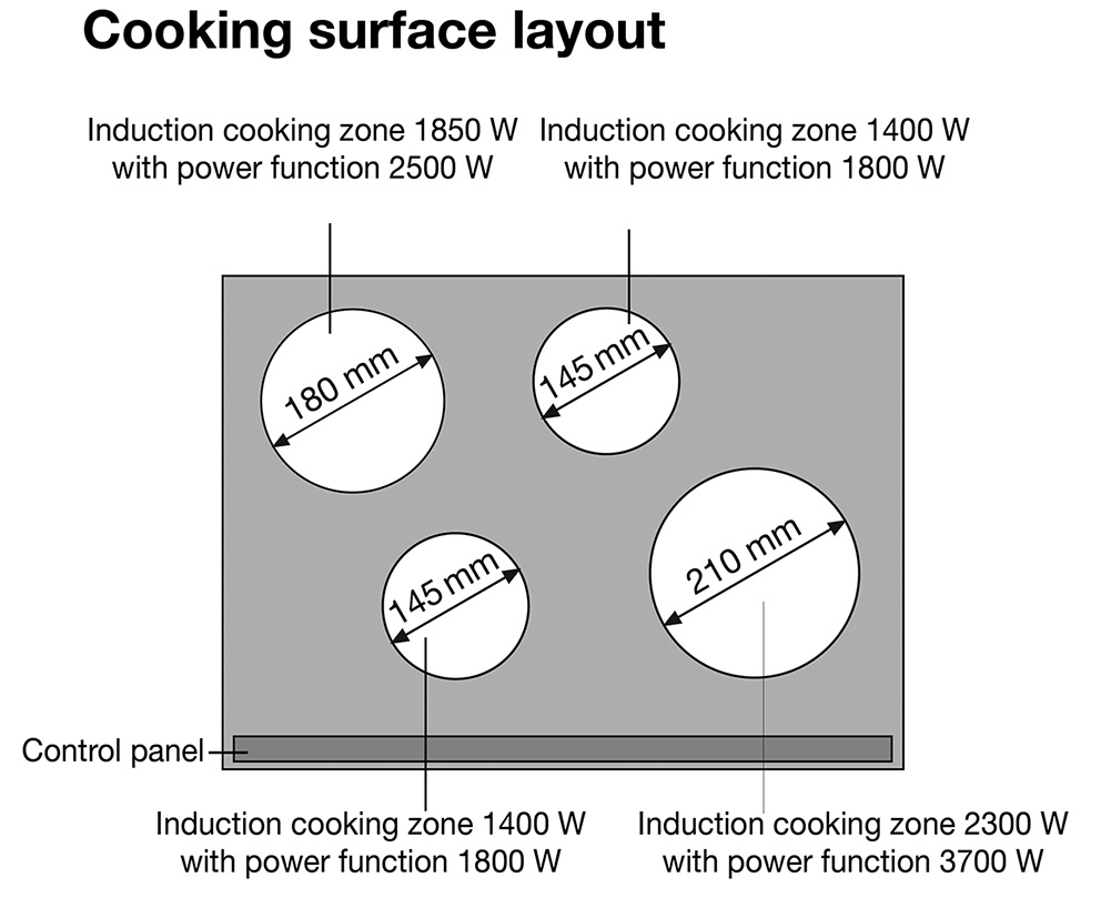

The one already on the board was installed by a qualified electrician so I can only assume that it is compatible. My Electrolux hob is rated 7.4kW and we do sometimes use all four rings - and they all have a power boost function so I would only switch this MCB to 32A if there were no risk of tripping the power in mid-cooking.

Although one has been mentioned, there is no RCD in that picture.
It's definitely there, just out of shot - and it works.
Ultimately that fusebox is several decades past it's replacement date, your existing 8.5kW shower is already overloading that 32A device, and the noticeable difference between an 8.5kW shower and a 9.5kW shower is somewhere between insignificant and none at all.

I have a master RCD attached to the consumer unit
Im still not sure if you have an RCD. And your shower circuit must have one*
*not a requirement back in the day that your ancient fuse board was installed, but it is an aboslute requirement these days.
Also, the shower MIs will require you to have an RCD.
