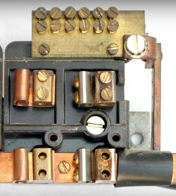

I used to fit a lot of Wylex and knew the technical guy who had worked there years. He told me that all Wylex boards are sub 100A unless marked.
And that the sub-100A boards are not designed for any circuit greater than 30 or 32A.
Some boards had a way to the right of the main switch which was designed for 35, 40 or 45A devices.
The fuse shields for these devices (orange and green) had a tab on the back, designed to prevent their fitting to an unsuitable board, which was often snapped off.
Yes I put some links to eBay on the previous page which shows the tab.
I removed from my house one of the wooden boards with the separate high current way, however I wouldn’t consider it a 100A board.
I note the OP board is marked 100A. But being 12 way I wouldn’t expect less
Fair point. The ones with a separate way can be any amperage.
Correct - without that, overheating and failure is inevitable.

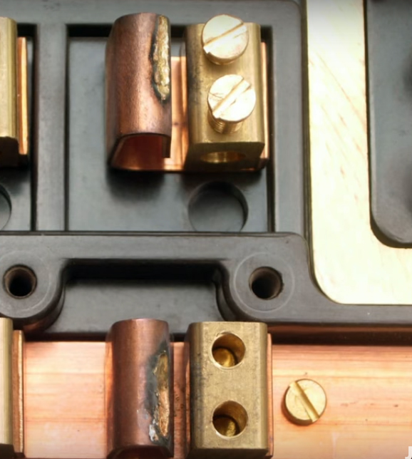

Thank you, I think these are your pictures, showing switch 60 amp rating,
showing standard contacts
With burning as not man enough.
And the uprated contact to right.

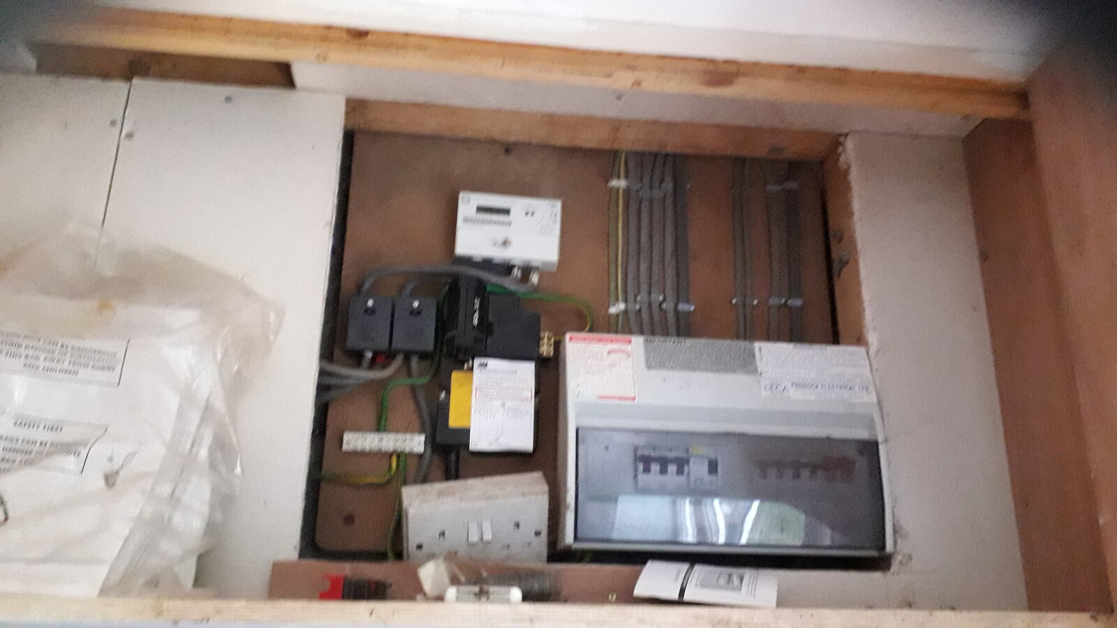

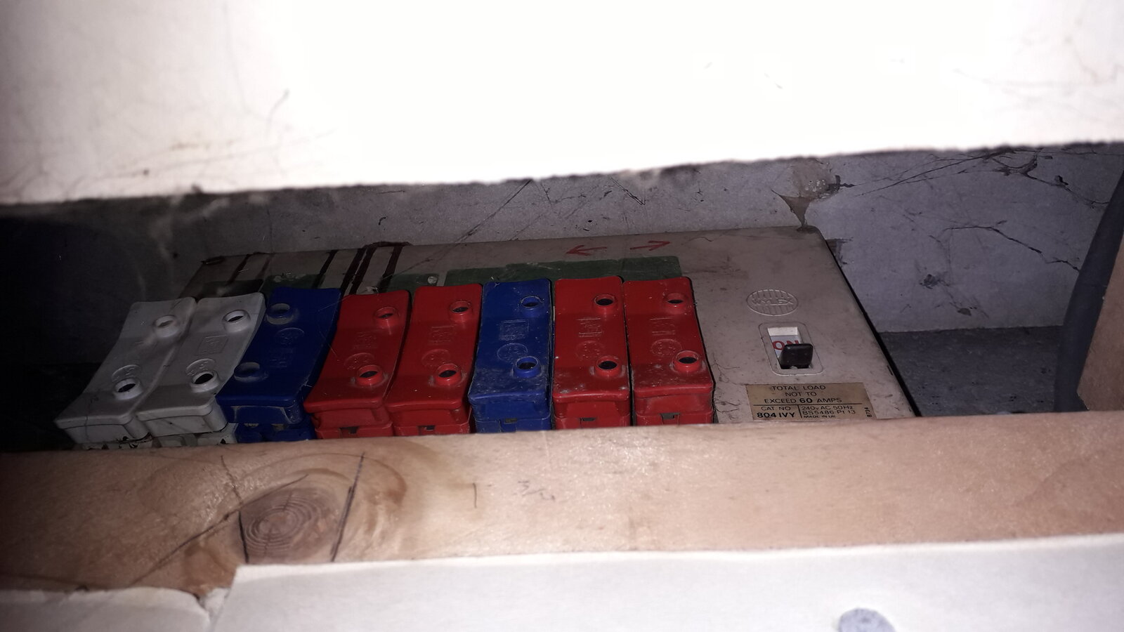

This 20190529_081332-1.jpg was my fuse box, it was trapped between the original garage ceiling and a new false ceiling, we had to cut a larger access hole to get to it and remove it, we at first did not even know it was there, 20190529_081240-1.jpg there was a second consumer unit for the flat, only when I turned off the power and it did not go off did I notice the little hole in the plaster board top left, and then saw the fuse box through the hole, so you have it easy, at least you can see the old fuse board, I realised I may have been able to get a fuse out, but getting it back in was unlikely, so had to bite the bullet and get it changed.
You know it needs doing the same as I did, and you have to stop kidding yourself it will be OK.
