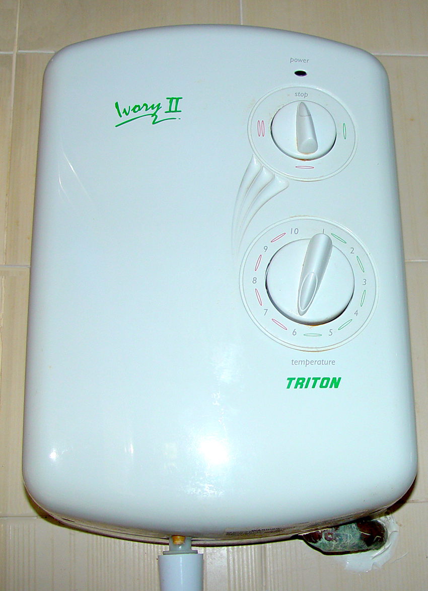

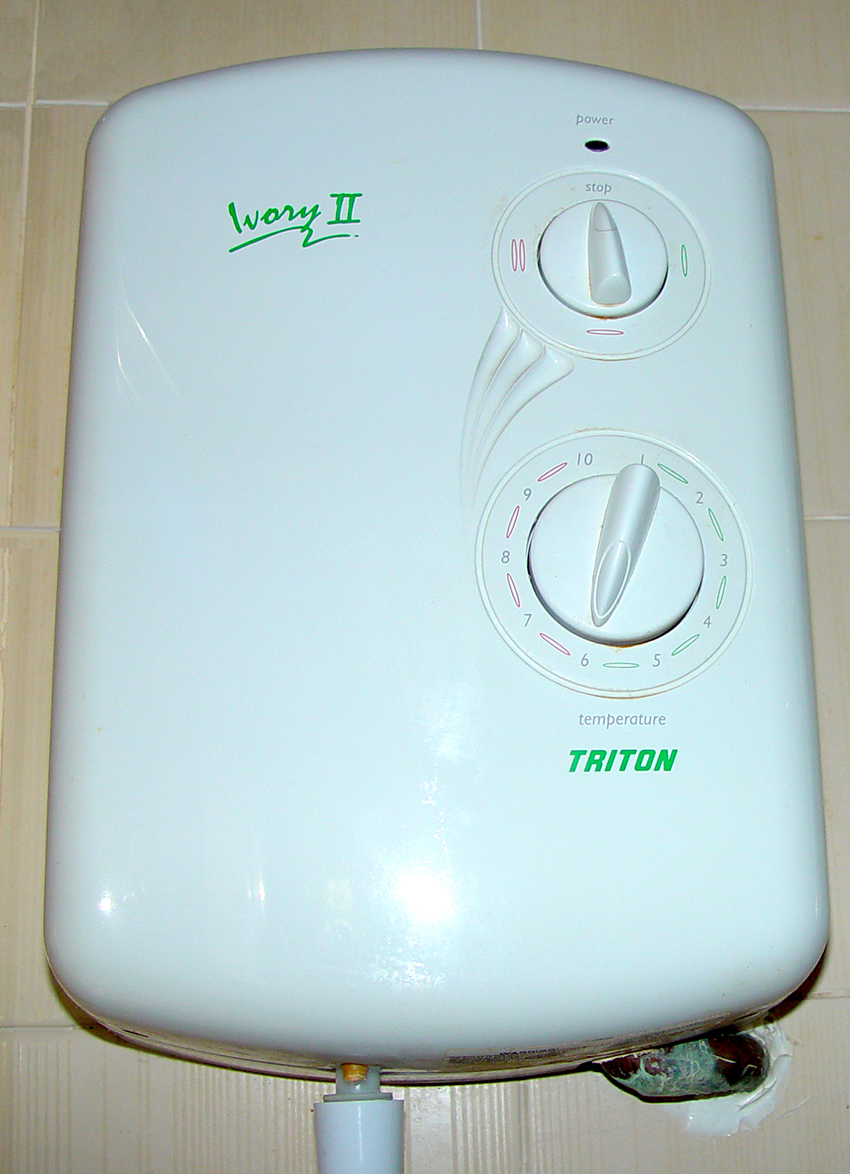

Photo shows the existing 8.5kW shower.

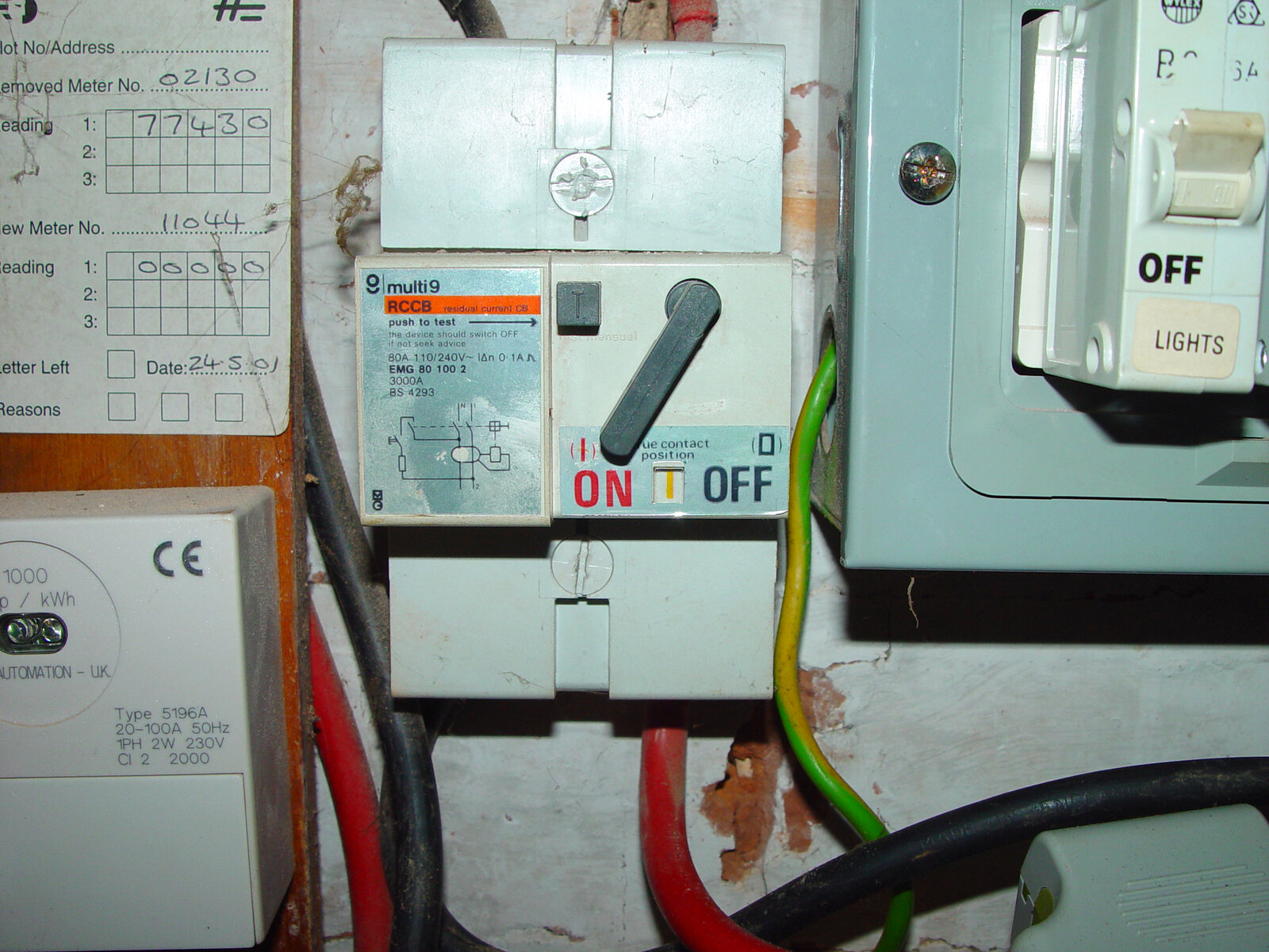

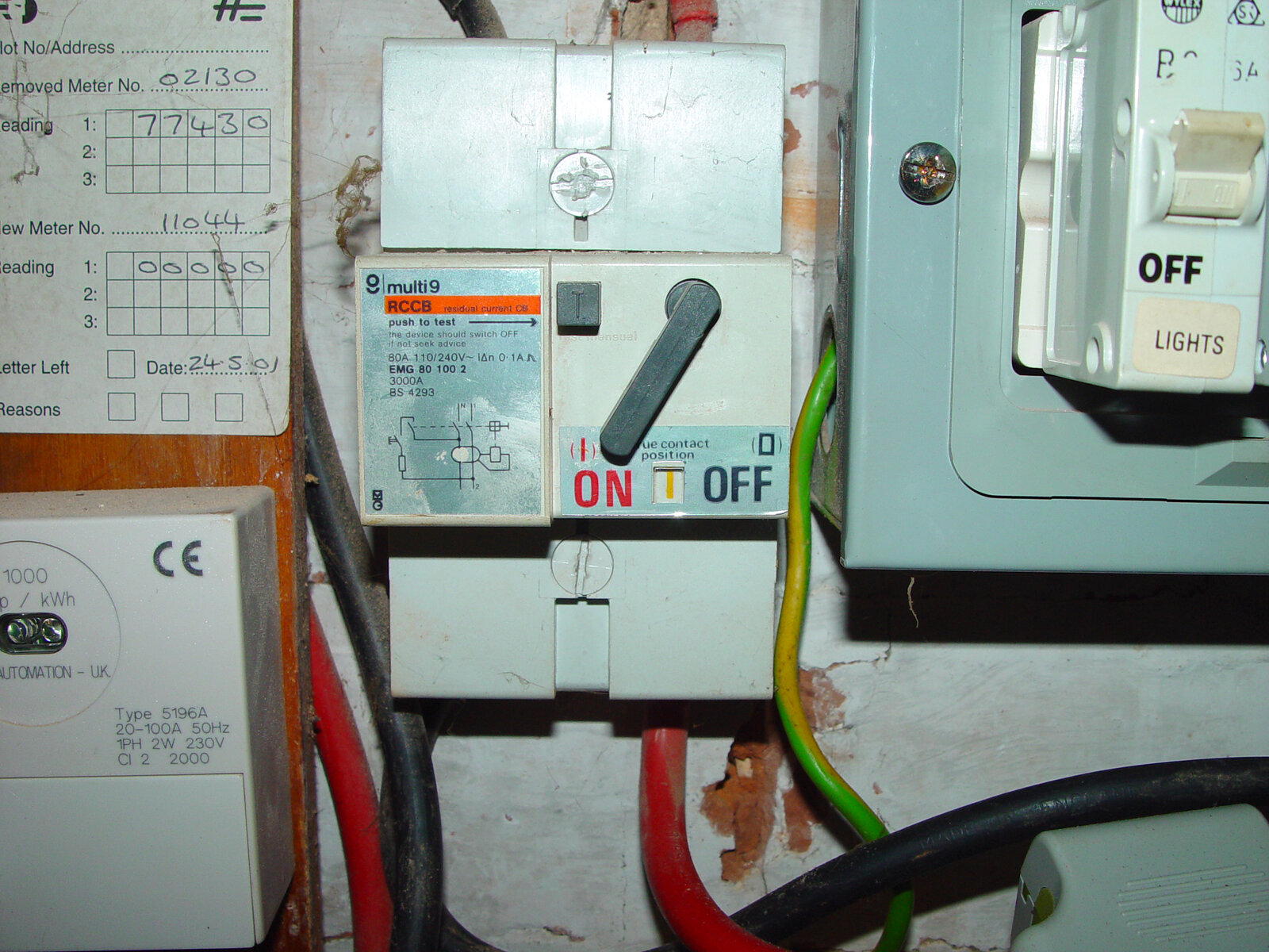

That is a 100mA RCD, the wrong rating for additional protection of socket outlets, showers and most everything else.
parts of the CU, meter, RCD etc were installed or upgraded in 2001.
Doubtful - that RCD is a 1980s part, possibly early 1990s at the latest.
Some of the MCBs might have been fitted around 2000, but the fusebox is much older.
A pumped shower won't change anything - they are only for situations that have low pressure cold water from a storage cistern.
The flow rate of an electric shower is limited by the power rating - the only way to get more flow is to either have a cooler shower, or to put a lot more power in.
With inlet temperature of 5C and outlet of 40C (temperature rise of 35C), the flow rates are
8.5kW = 3.5 litres/minute
9.5kW = 3.9 litres/minute.
0.4 litres per minute extra flow at the same temperature.
Even going to the most powerful electric shower of 10.5kW, which would require new cable and a new consumer unit, it's still only 4.3 litres/minute.
If you want a higher flow rate, then an electric shower is not the solution.
I looked for the instructions for Triton Ivory II and failed, but all the Triton showers I found said
Triton said:
A 30mA residual current device (RCD) MUST be installed in all UK electric and pumped shower circuits. This may be part of the consumer unit or a separate unit.
And the RCD is 100 mA so needs changing, it is well past use by date.
In real terms the 100 mA RCD is a good isolator so maybe leaving in place is a good idea as saves calling the DNO to fit an isolator. I did have a pumped shower at my parents house, until the combi boiler was fitted which made it illegal, and it had to be swapped for a simple thermostatic shower, it was a good shower, but it also required a 30 mA RCD to be fitted.
I found the instructions here. They say: "To enhance electrical safety a 30mA residual current device (RCD) should be installed in all UK electric and pumped shower circuits. This may be part of the consumer unit or a separate unit." Since their other electrical instructions all use the word "must", I assume that the 30mA RCD advice is not mandatory. In any event, after 20 years of electricity consumption, nothing has ever gone wrong - including the one occasion when I cut through a live cable and really did need the RCD to work and it did.
Well, that's what I've got. My shower water comes from the cold water tank in the loft.
It certainly doesn't sound impressive but 0.4L more would be a >10% improvement and that might just be enough to make the shower more fit for purpose. In any event, I won't be investing in new plumbing for a different shower…and the Triton with the internal pump might give me more than 10%.
Wylex have replied to me (see below), passively confirming that my old 1206 board does take 40amp MCBs and noting that they haven't stocked for four years. They also confirm that the aggregate draw of my active appliances should not exceed 100amps, ie less than half the aggregate max capacity of the installed MCBs. Since my 100amp RCD rarely trips, I assume that I don't normally exceed 100amps but that would be more by luck than judgement. Seems somewhat hit-or-miss but maybe I shouldn't mess with it. It's not uncommon for me to be using concurrently: the hob; the oven; the microwave; the kettle; the washing machine; the tumble drier; the shower(on its 32amp MCB); and a couple of dozen or more small appliances such as PCs, an electric heater, lights, phones, battery chargers, routers, POE switches, security lights, etc, etc and it handles that load without complaint. But maybe I should steer clear of upgrading my shower.

The rating of the switch on that is 100 amp max, so when everything is fully running it should not exceed 100 amps, it would be up to the electrician on site to do their calculations, apply diversity etc to see what rating of circuits would be ok.
The B40 would be hard to find, Wylex haven’t sold any now for about 4 years now and there is no stock left of them now, I am afraid.

I have an old 1206 Wylex fuse board (see photo) in my house. It continues to work well and has been inspected regularly by my local electricity supplier but I have no documentation for it and would be grateful for an answer.
Could you please tell me if this board supports one, two or more 40 amp MCBs? As can be seen from the photo, there is one 40 amp MCB installed in the board but since the protected device (an induction hob) only requires a 32 amp MCB, the 40 amp MCB may not be operating at its full rating.
In particular, I’m thinking of upgrading an electric shower which would require another of my MCBs to be upgraded from 32 amp to 40 amp (assuming I can find one).
I will take it as read that you would advise me to replace my CU with a modern one.
Many thanks for your help.
It doesn't work like that.
The number and rating of MCBs connected does not cause power used to increase or decrease
It doesn't work like that either.
An RCD does not trip on current usage.
he doesn't "passively confirm" that. He did not answer your question. he just said they are no longer offered. Your CU might have been designed to accept one or more 40A MCBs; this would be seen by the presence of (I think always only one) MCB-socket that was larger than the others and was capable of accepting the intentionally-larger (green?) 40A MCB used at the time. I don't see such a position in your pics.
At the time your CU was made, the MCBs were a different design, with two push-buttons. Yours has the (much) later switch type and perhaps when they were offered the B40 no longer had the protrusions. B40 were always very rare on Wylex Standard CUs.
I might have an old 12-way metalclad on my scrap shelf. If I have, I'll see if it looks like it was designed to fit the 40A MCB. I don't think so, because I've seen Wylex standards where it was separate and clearly identified.
