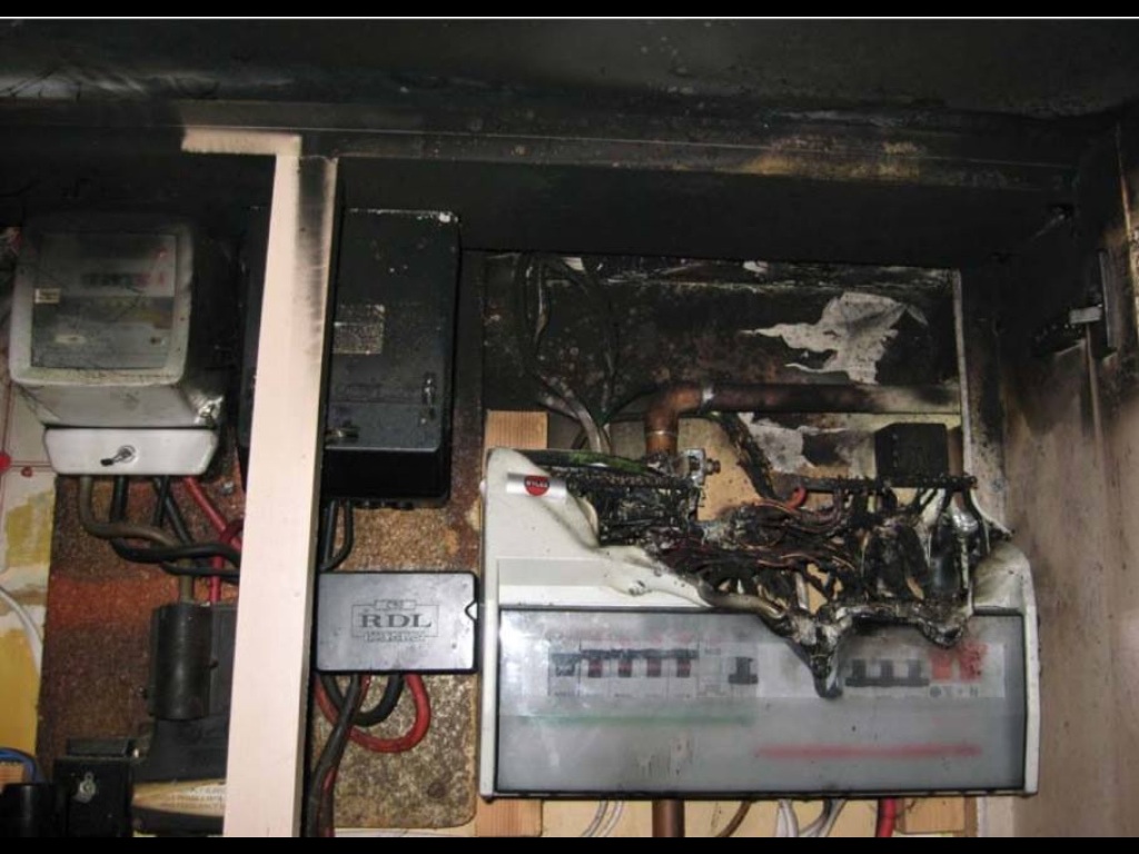

We all know the reg was introduced to stop this sort of thing happening:
They may have thought that, but it probably won't.
BTW - that plastic CU didn't burn very well, did it.
While I've never been much of a fan of plastic boards... most of them bend and flex about far too much for my liking. I cant help think that this issue has been brought about by several different issues, and I'm not sure that the solution can be seen as much more than a sticking plaster and is poorly thought out and has been used as an marketing tactic by manufacturers (I do wonder how much input they had at BS7671 committee meetings...)
Anyway, issues resulting in boards looking like the picture above:
1) manufacturers using plastics which barely scrape through the fire resistance criteria
2) Cage terminals which are less than ideal on the 25mm² 7 strand tails we favor in this country, and that you can miss a busbar 'stab' with
3) Installers who do not tighten said cage terminals properly
4) Meter fixers who move tails about without checking for tightness afterwards.
Perhaps if main switch terminals were re-designed with a brass tunnel with two brass grub screws that might be a better solution. After-all... burnt out henly blocks are almost a non existant issue, where as consumer unit main switches....
