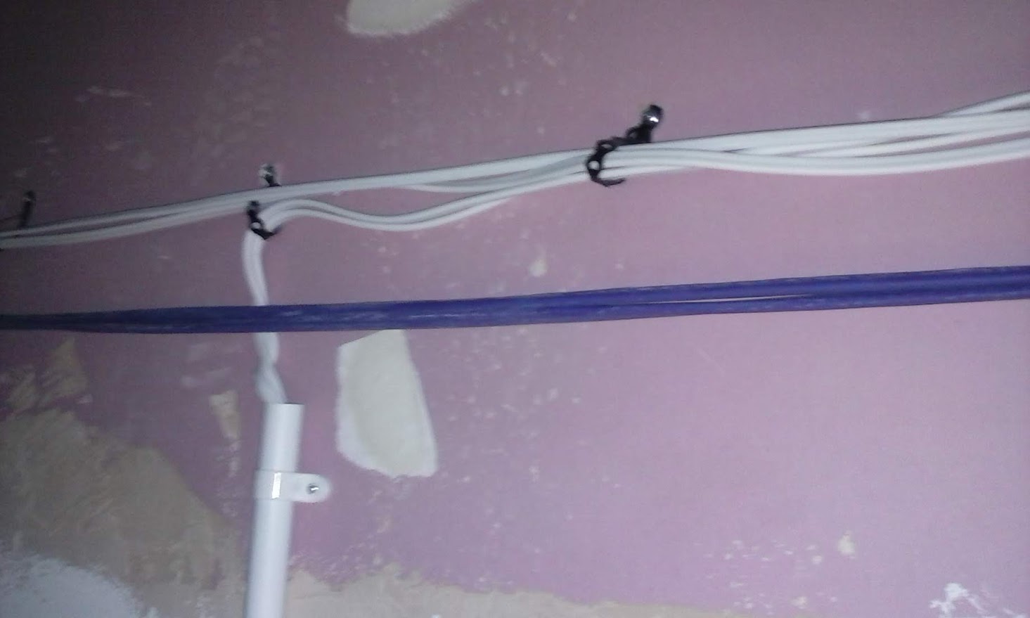

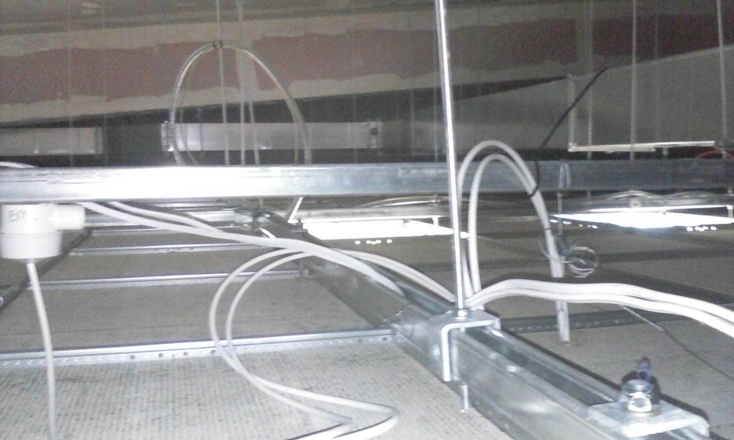

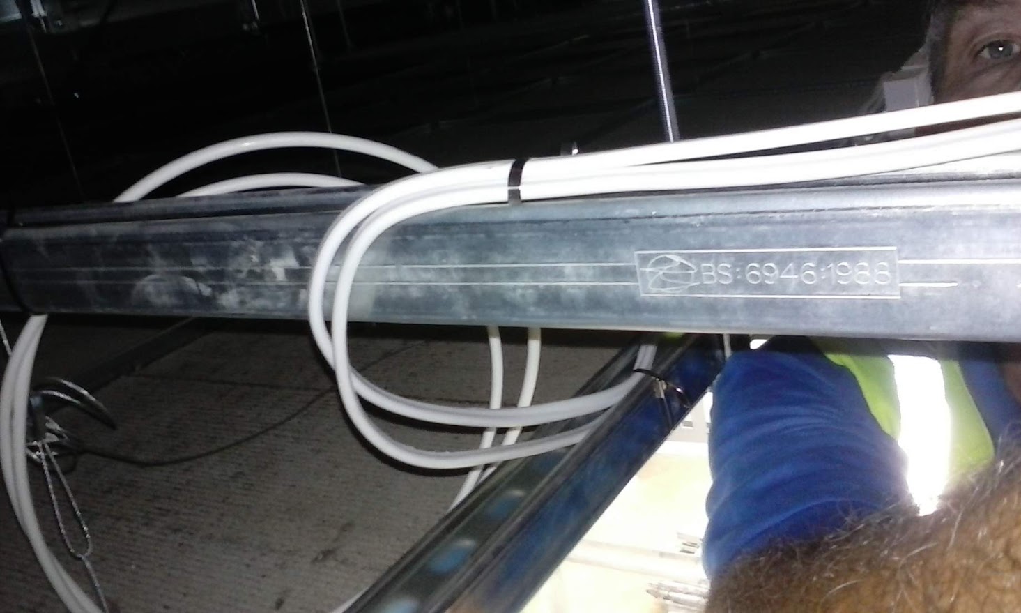

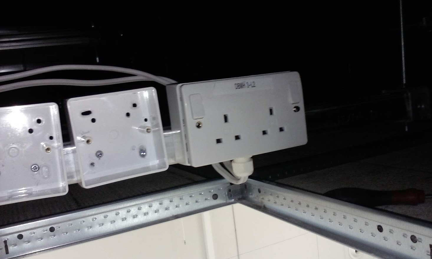

LSF cable is likely to be used in schools alright, although T&E type cable isn't. Singles in galvanised containment is the norm in schools.
I think your out of touch there,:) pics from a new school building 2017:

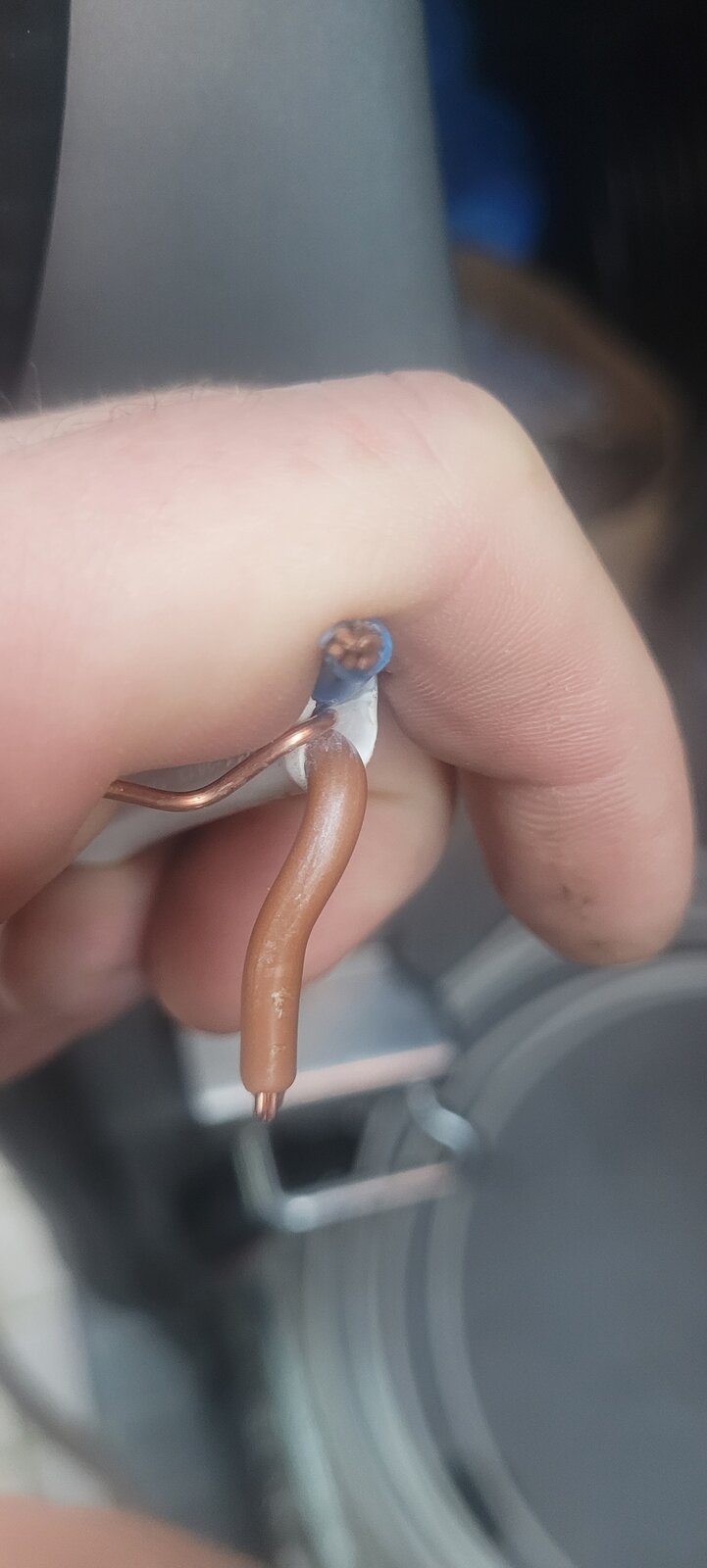

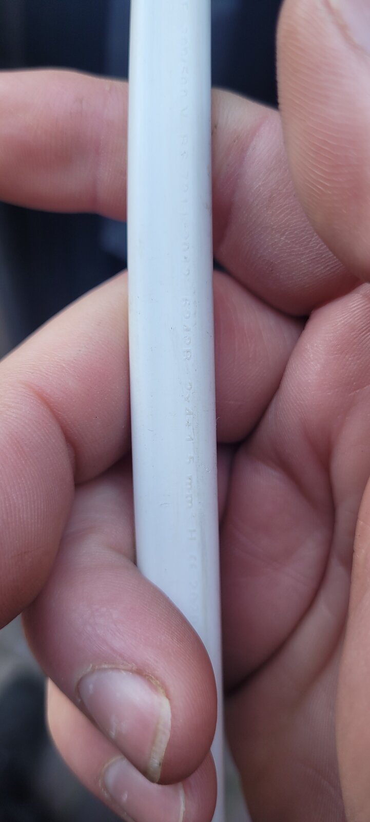

Hi all.
My can someone tell from this picture ,appreciate your help

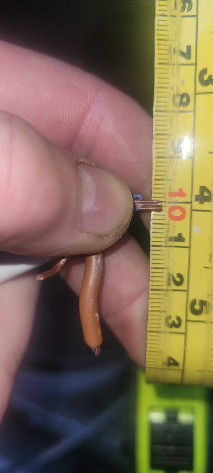

So popped my glasses on and looked at the cable, ran some muck round it and numbers appeared, its 4mm grrrr.
My swapsy has gone wrong .

Thanks all , I'll have a chat with him later, if you guys think it's alright I'm sure he will.
It's going on a 16a mcb that's rcd protected too.
