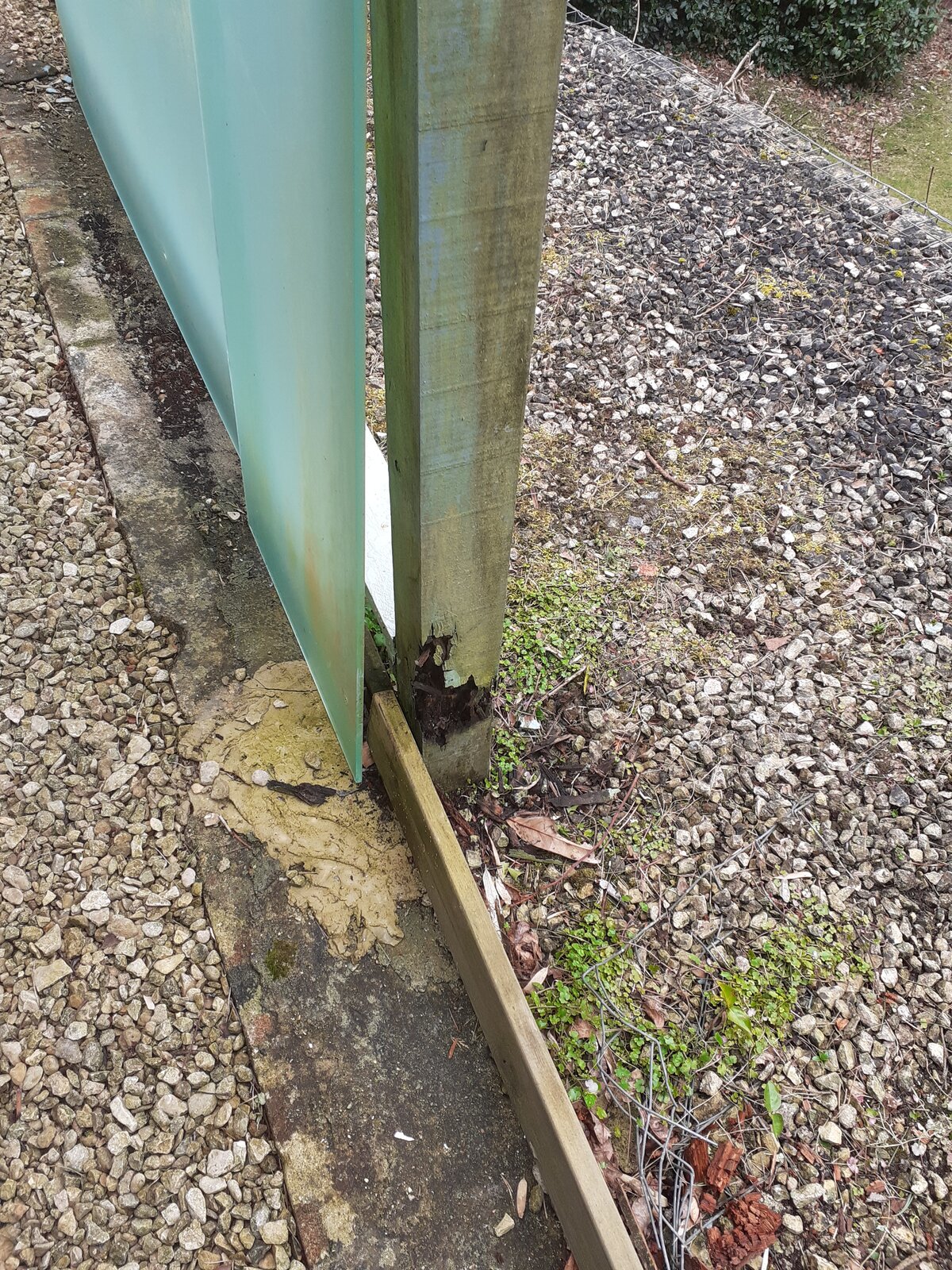

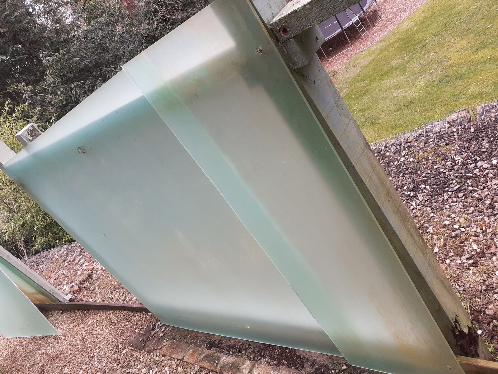

Got some 10mm perspex, which needs cutting. Is it best to use a circular saw and if so what blade?

the wind loading on sheets that size will be huge
at least the posts are proper solid

Got some 10mm perspex, which needs cutting. Is it best to use a circular saw and if so what blade?View attachment 266110View attachment 266111

If you are using the perspex in lieu of glass, I was under the impression that UV light will degrade the perspex, making it more brittle.
Toughened glass will shatter in to tiny bits if someone falls in to it. Perspex creates large shards which could (potentially) puncture an organ.
I have no idea if 10mm perspex suffers the same fate.
Perhaps others can clarify...
The perspex in the pics is "glass look perspex" & unaffected by UV light. Or that is what it looks like to me.
