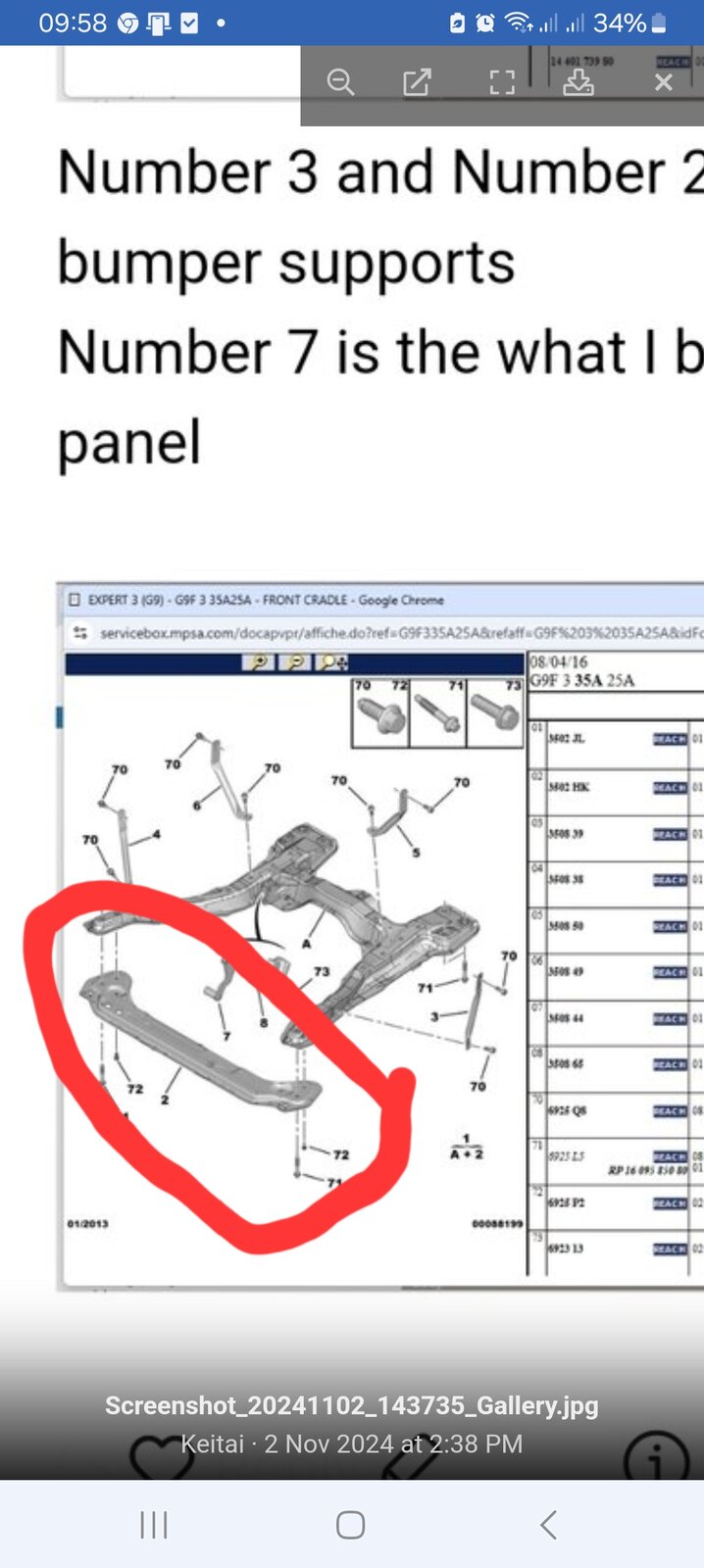

So should be much cheaper to just get part no.2 than whole subframe? If I get it from Peugeot I guess less hassle to return it if wrong. I can go to my mechanic and check with him. This circled-?ìView attachment 361497
I doubt you need whole subframe (A in your diagram). They're available as seperate items so part no. 2 should suffice.

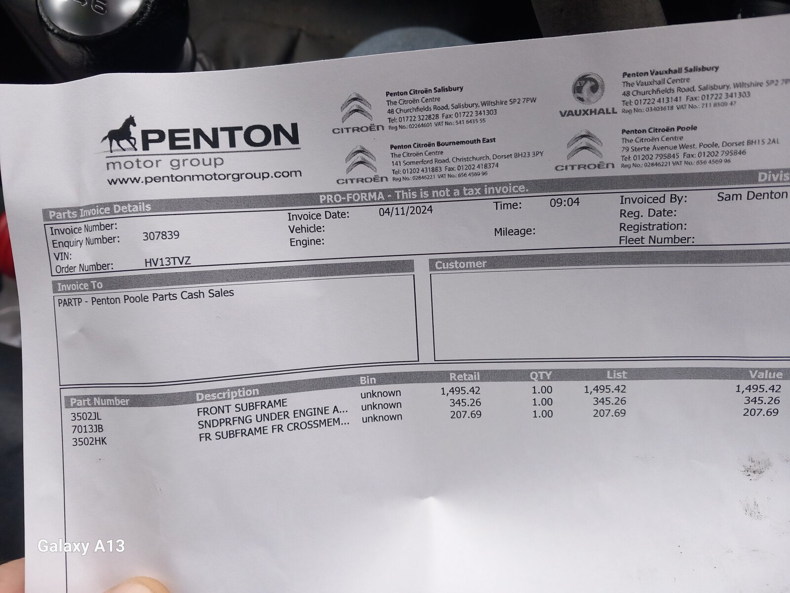

Got these quotes for the parts from Peugeot. Think I can put the part numbers into Google or call the breakers yards with them.

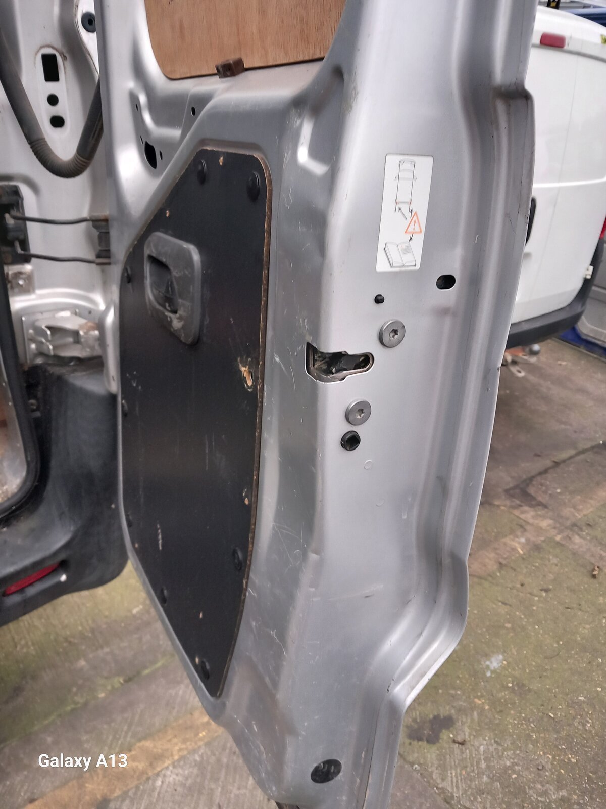

The jaws in the lock in back door lock sometimes lock and I need to fiddle with it to open. Worth getting the mechanism (not barrel) off this scraped vehicle for £20?
And a new remote key as doing it manually the key sticks and won't turn in passenger door and back door. Works OK in ignition? Is the easiest solution just to get a new remote fob to stop manually sticking key in lock and wearing it out?

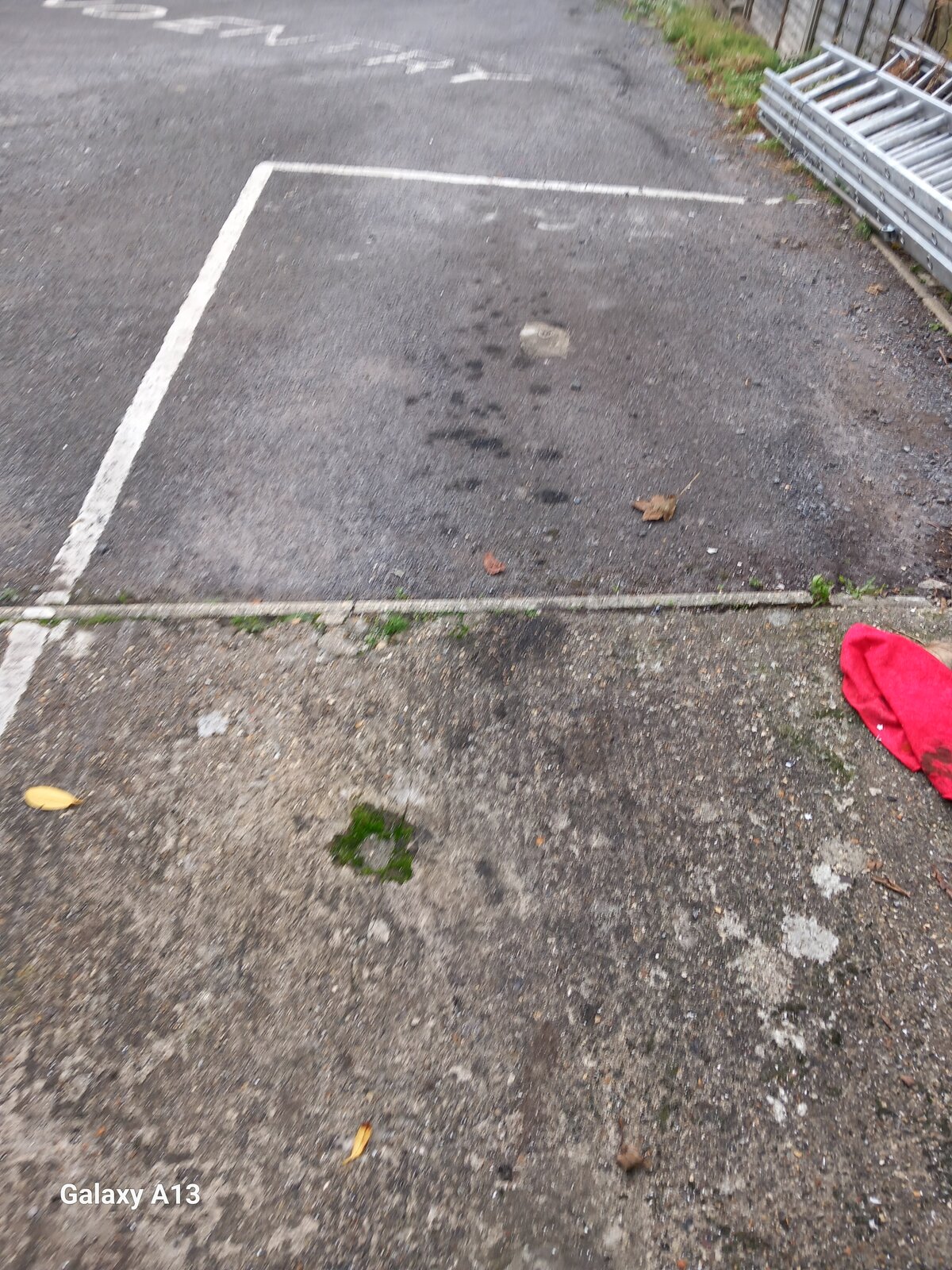

This is my parking space in my block of flats. Is this oil?
Sure looks like it!

I've no idea how long it's been there. Thinking of putting some wood underneath to see if there's any new drops. If it is oil, what does that mean? How serious? It's going into my mechanics next Friday to repair damage from hitting bollard.
It’s hardy a desperate situation unless you get a complaint!
Likely causes are a damaged sump plug washer, a drip from the oil filter housing ( unlikely), or maybe a crankshaft to gearbox oil seal. This is a big job!
Rusty and porous sump pans aren’t unknown either.
Find out where the leak is coming from, but don’t worry or panic about getting it fixed.....looks like it’s been there a long time!
John
Be careful swapping locks and remotes. The back door lock might be OK to swap, but some cars (for security reasons) have locks "coded" to the central computer that looks after the remote door locking and immobiliser. The remotes will almost certainly be similarly "coded" so just swapping one won't work.
John

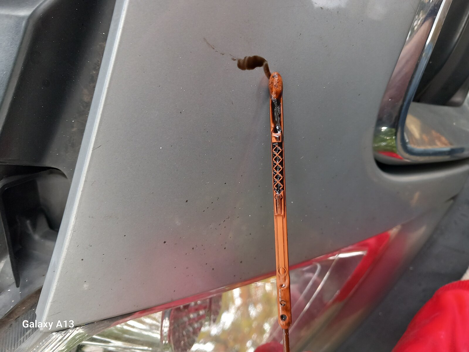

Oil looks ok, doesn't it?
