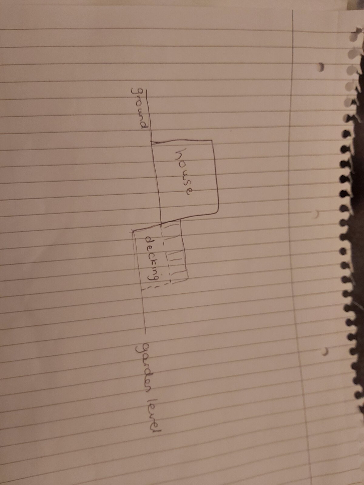

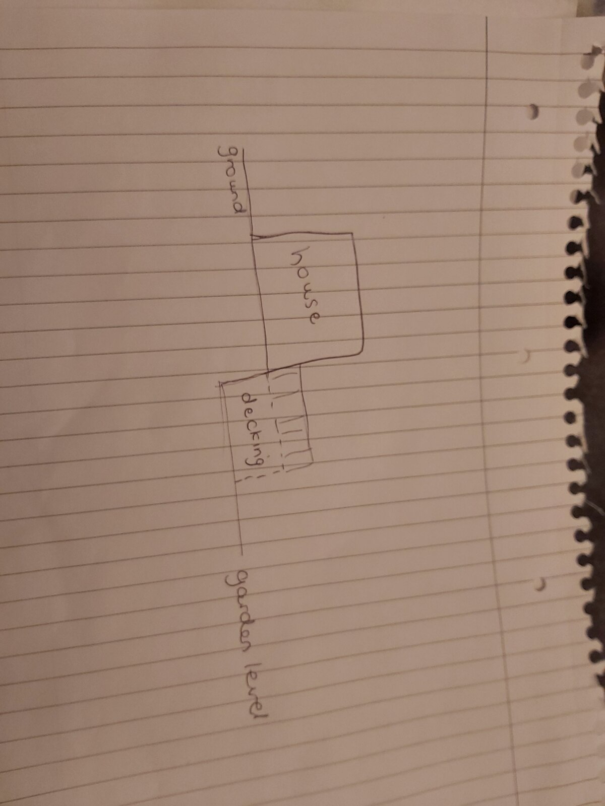

This is a rough sketch. The decking is attached to the house.
Is it really a 90degree cliff edge or a bit of a slope?
Can I see photo?

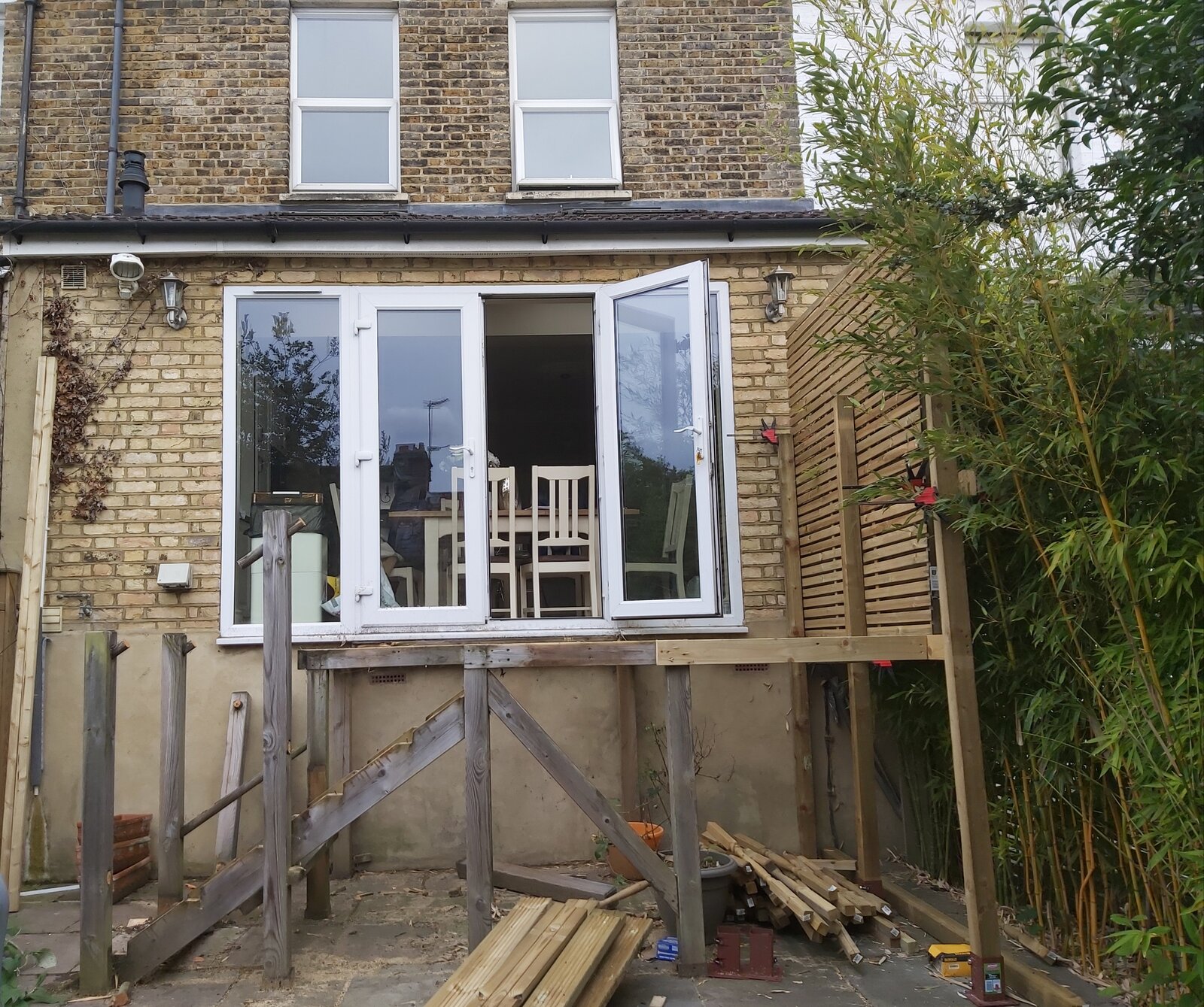

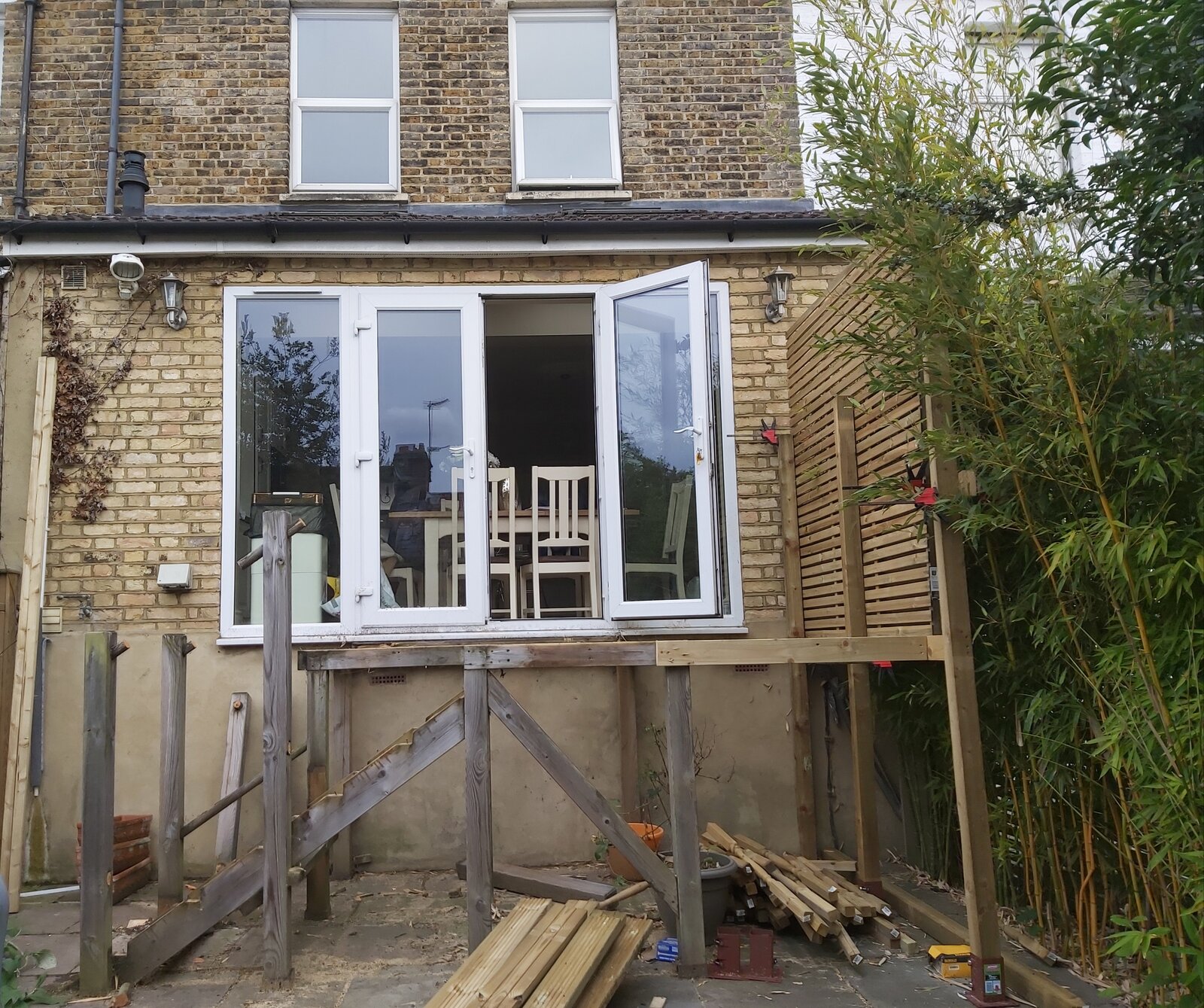

Here is the decking mid-construction so you can see the drop. It is a 90 degree one..

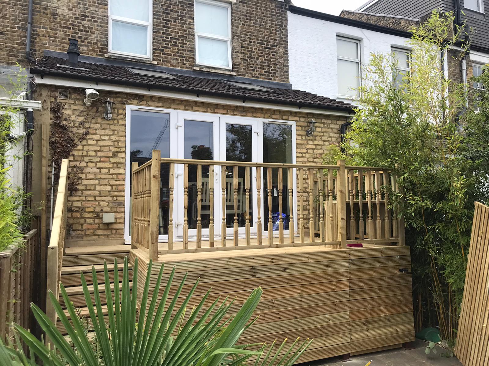

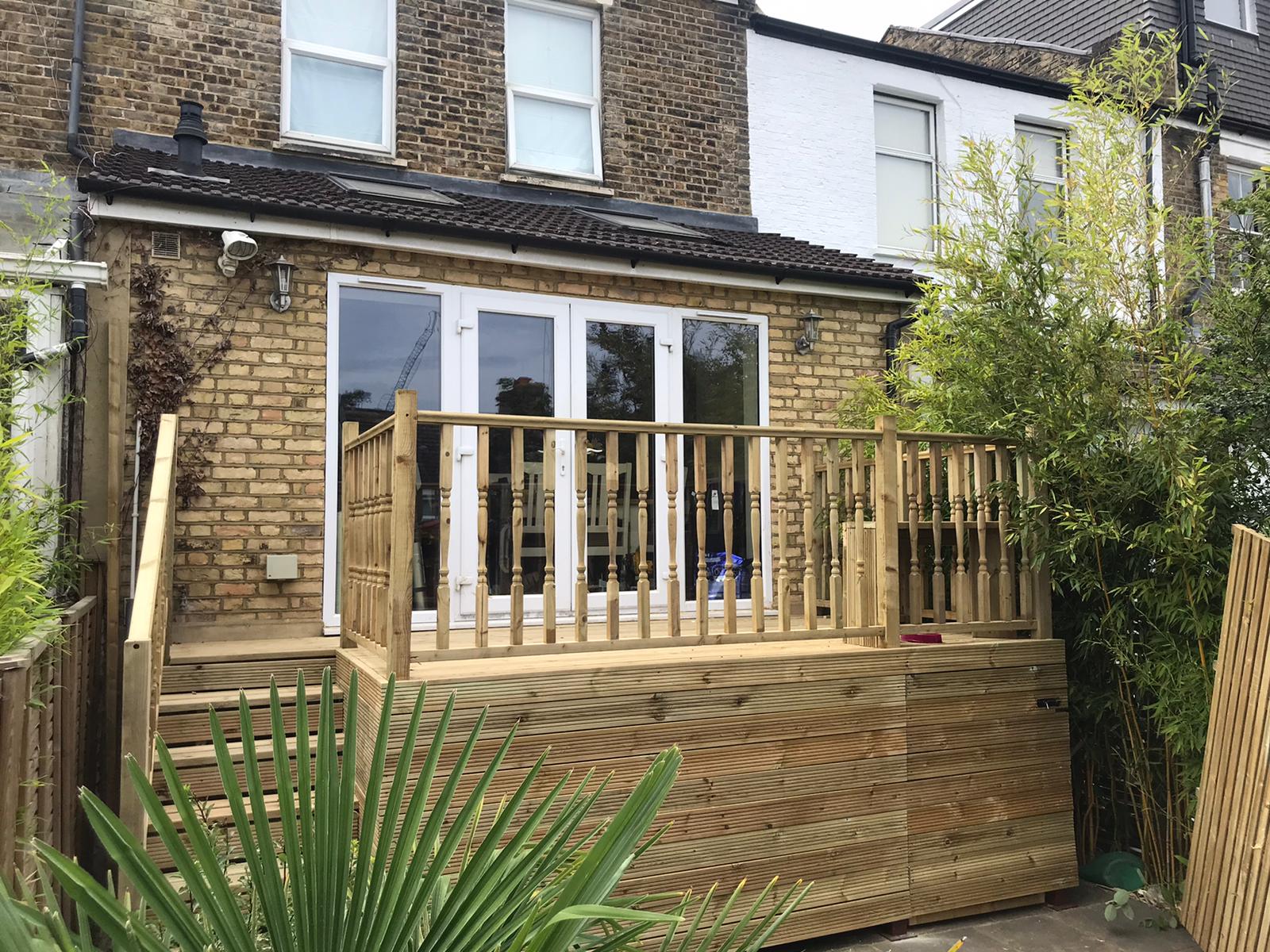

Here is the finish..
Erm. I'd assumed a slope with a ground level and a drop. There doesn't look to be anything you could take the 30cm measurement from.
Hopefully someone with more experience can advise, although to me, that doesnt lool to be PD.
Happy to be wrong
Okay thanks! That's where I'm a bit confused as technically the highest natural ground level adjacent to the structure is the ground near the front door (given the decking is attached to the house). I'm not confident on this though..
Any other opinions?
Yes. I have read all the previous stuff as being decking just off the ground, possibly slightly higher, or designed to level out uneven ground.
You might have got away with a set of stairs to a ground level deck.
Surely that bit is the highest natural ground level adjacent to the structure?
