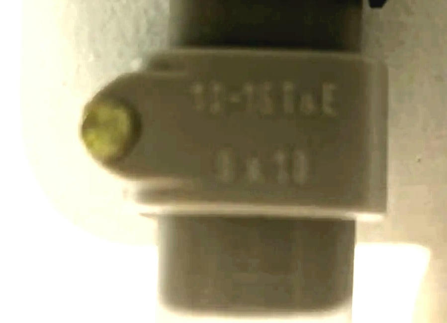

Determining the size of already installed cable
Looks like 10mm² . If you look at the cable inside the shower ( turn power off first,before removing front cover) and look at its earth conductor ,if it is stranded copper it's 10mm cable. If it's solid single copper wire it isn't it's more likely 6mm.
