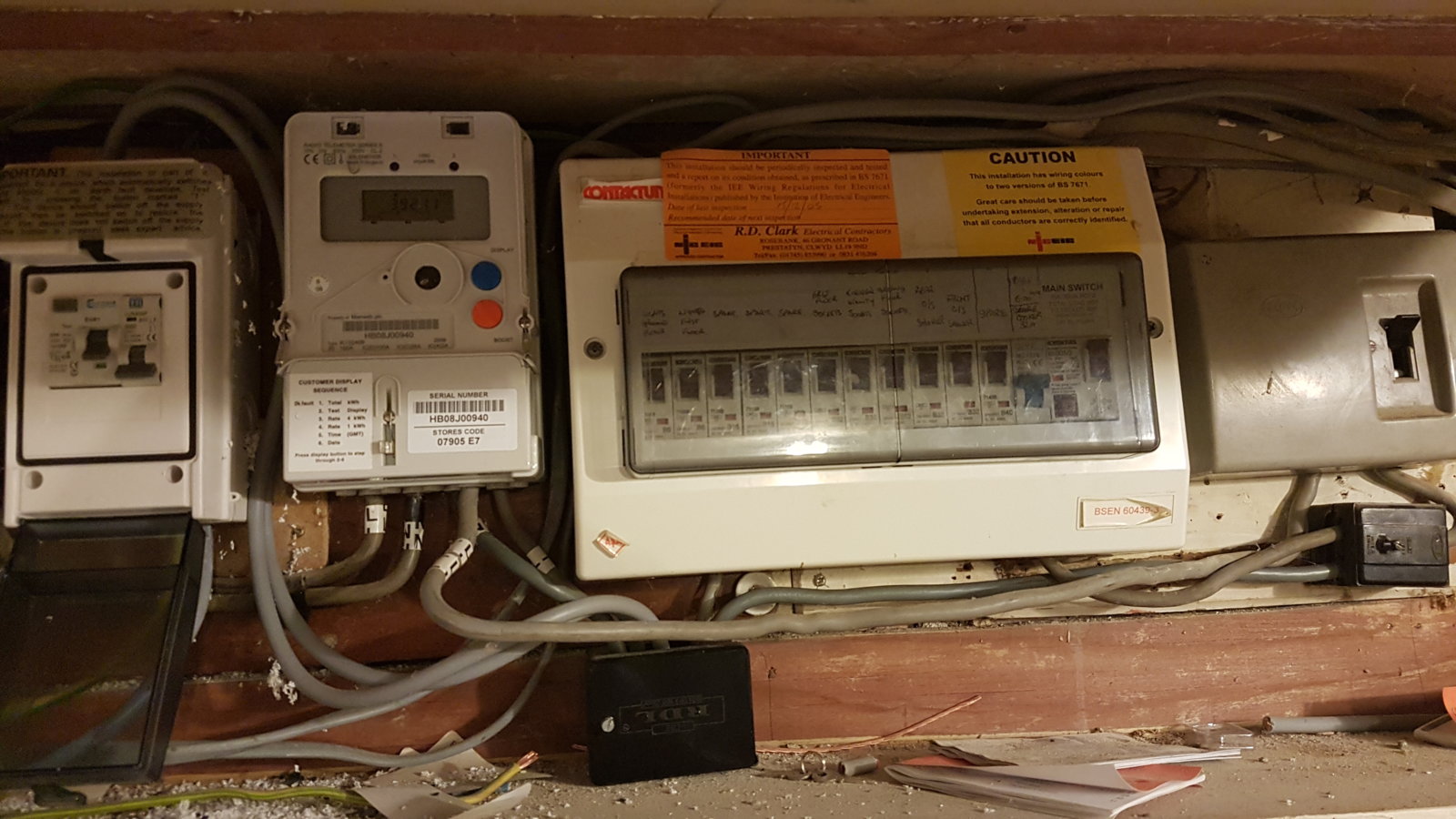

Anyway, back to topic... I had an electrician have a look, he said remove existing showers from those 32a rcds from the main consumer unit, then for the new shower suggested a separate rcbo (I think he said rcbo, or did I get that wrong?) with at least 45a rating off to the side with a 10mm cable up to the shower via an isolator switch.
Sound ok? Or does that existing consumer unit need to go full stop?
