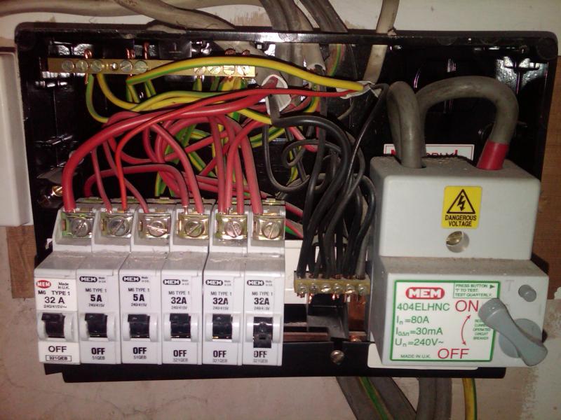

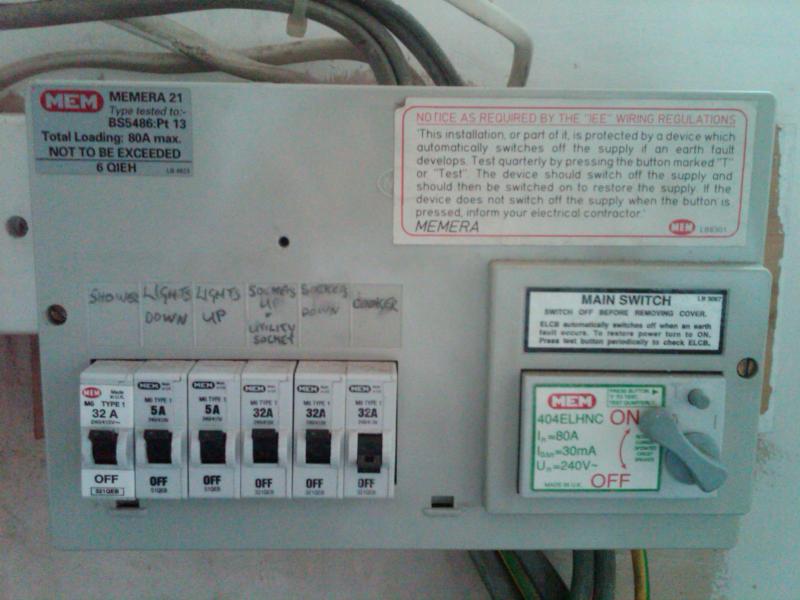

Here's some pics of CU with and without cover removed...
Is this CU suitable for the upstairs lighting trip unit (3rd from left) to be replaced with a suitable 6amp 30amp RCD? If so could someone point me to the item I need to get?

All your circuits are protected by the up front 30mA RCD.
Ahhh... :oops: and so a separate RCD isn't require for the bathroom electrics?

No, it would be pointless using additional RCD's though you may want to have your existing RCD tested to ensure it's working within spec.

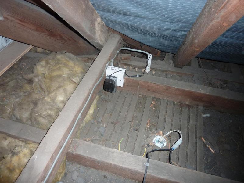

Quick question - the set of 10 LED's that I intend to use (IP54, Zone 1 rated) have a transformer built into the plug itself therefore making it impossible to wire directly into the light circuit unless I spur from the light circuit a socket in the loft to be used for the LED's only (and appropriately/clearly marked).
Based on regulations/safety only, is this acceptable?

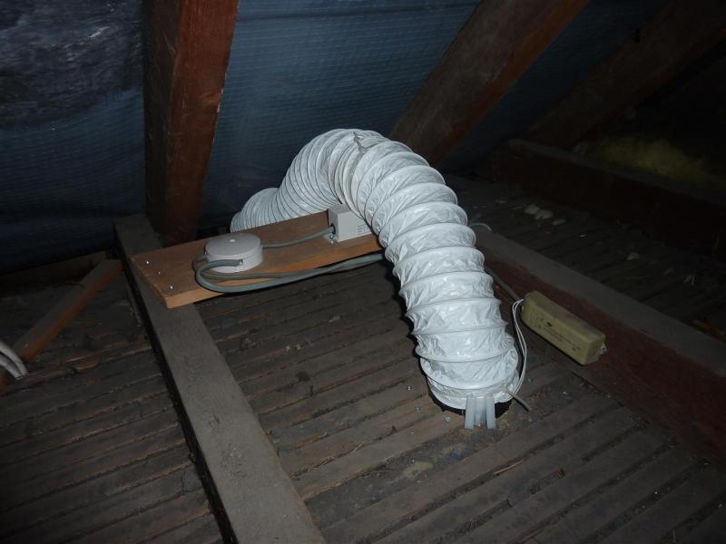

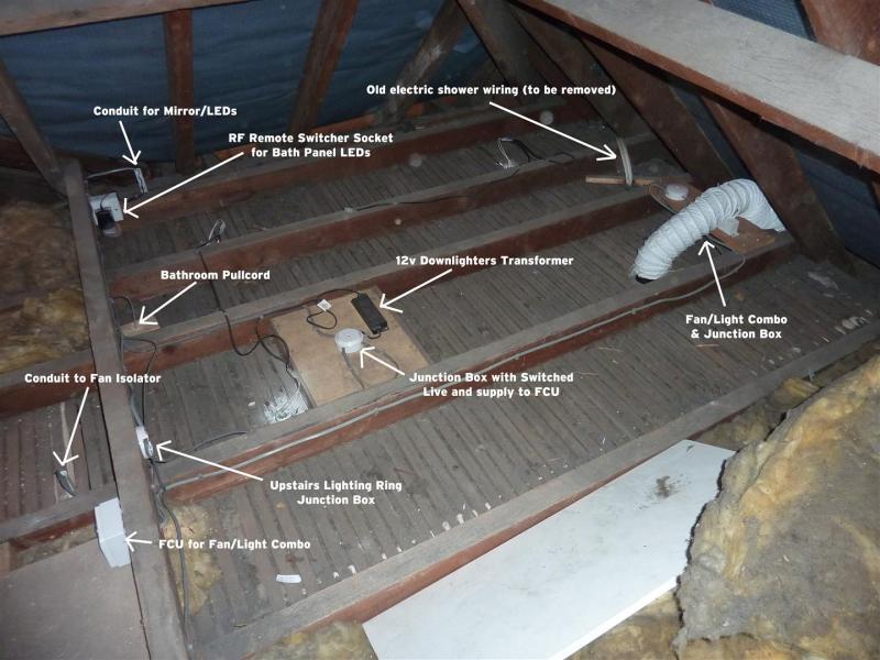

Here's the loft overview plan with guide notes:
Here's some closeup detail pics for the electrics geeks :D

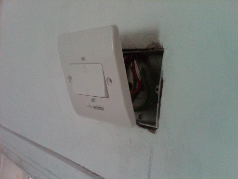

The Fan Isolator above the door of the Bathroom outside:

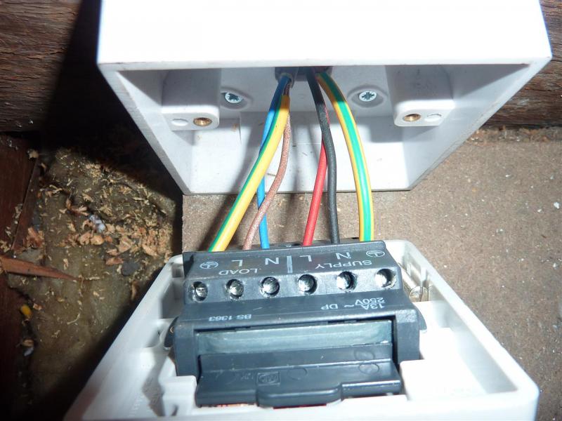

The FCU for the Fan/Light Combo:

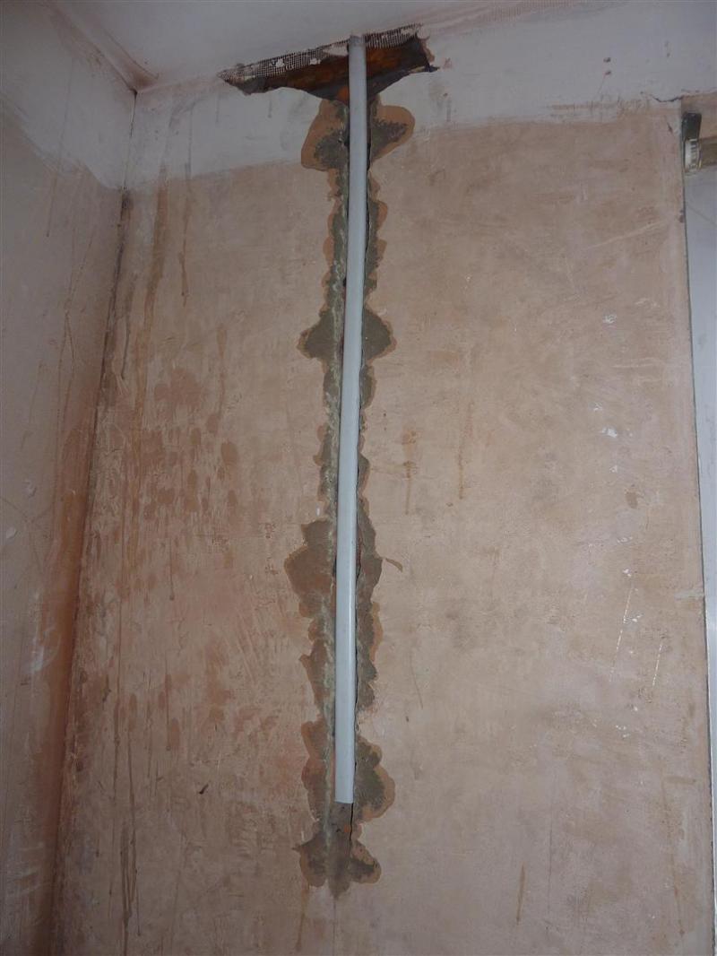

The duct for the heated mirror and Bath Panel LEDs (duct actually continues down behind the wall:

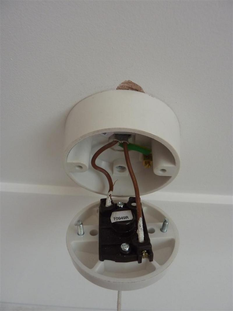

Bathroom Pullcord switch

Single socket on light circuit (marked 'For Lighting Only') with RF plug connected to it to power Bath Panel LEDs:

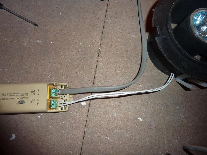

What's the white area on the insulation at the terminations?
Have you used side cutters to strip the insulation?
The rear termination doesn't look too great.
Its paint...accidently painted the insulation. The terminals are clean and I always use proper electrical wire insulation strippers, it's just a bad photo.
