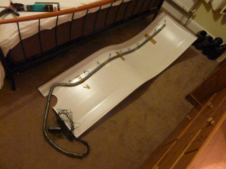

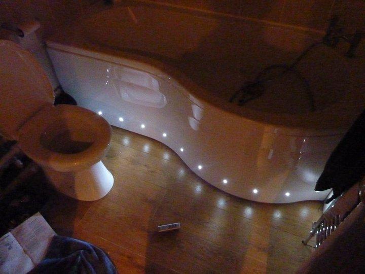

The LEDs around the bath are remotely controlled via a battery remote control and a receiver unit in the loft.

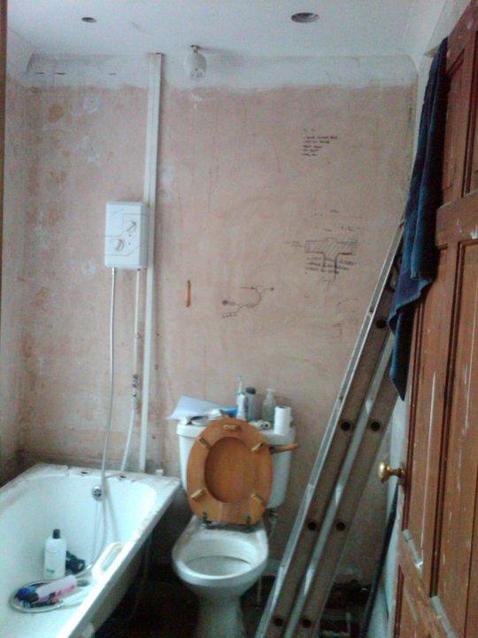

How it looked when I started...

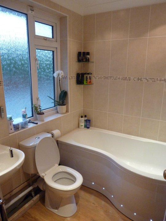

How it looks now...
Looks very nice but FFS, put the bog seat down!! :D
Lol thanks Gary, I'm really pleased. Regarding the seat, do you mean in the photo of the original bathroom? I daren't touch that manky seat, let alone move it :D
Think he means the lid, and in the new bathroom :)
Looks nice though, (the bathroom, not the lid!) :D
Yes, the lid!

Very rewarding isn't it guys, took a long long time to get there but well worth it. Overall cost of materials for the bathroom (everything you can see) is £1770, if I had paid someone for the labour I think I would be looking at well over £3k.
I had to strip of all of the old plaster from the walls, then reline with concrete board prior to the tiling, well worth the effort as the walls now feel solid.
Schmill RE your PM, the LEDs are just a basic set from B&Q, 10 x 15mm LEDs for about £25 in blue or white, really good value, the transformer unit actually allows you to mix/match so you could alternate :D They're IP44 rated for zone 1 too so safe to use in the bath panel, plus they're only 12v anyway.
