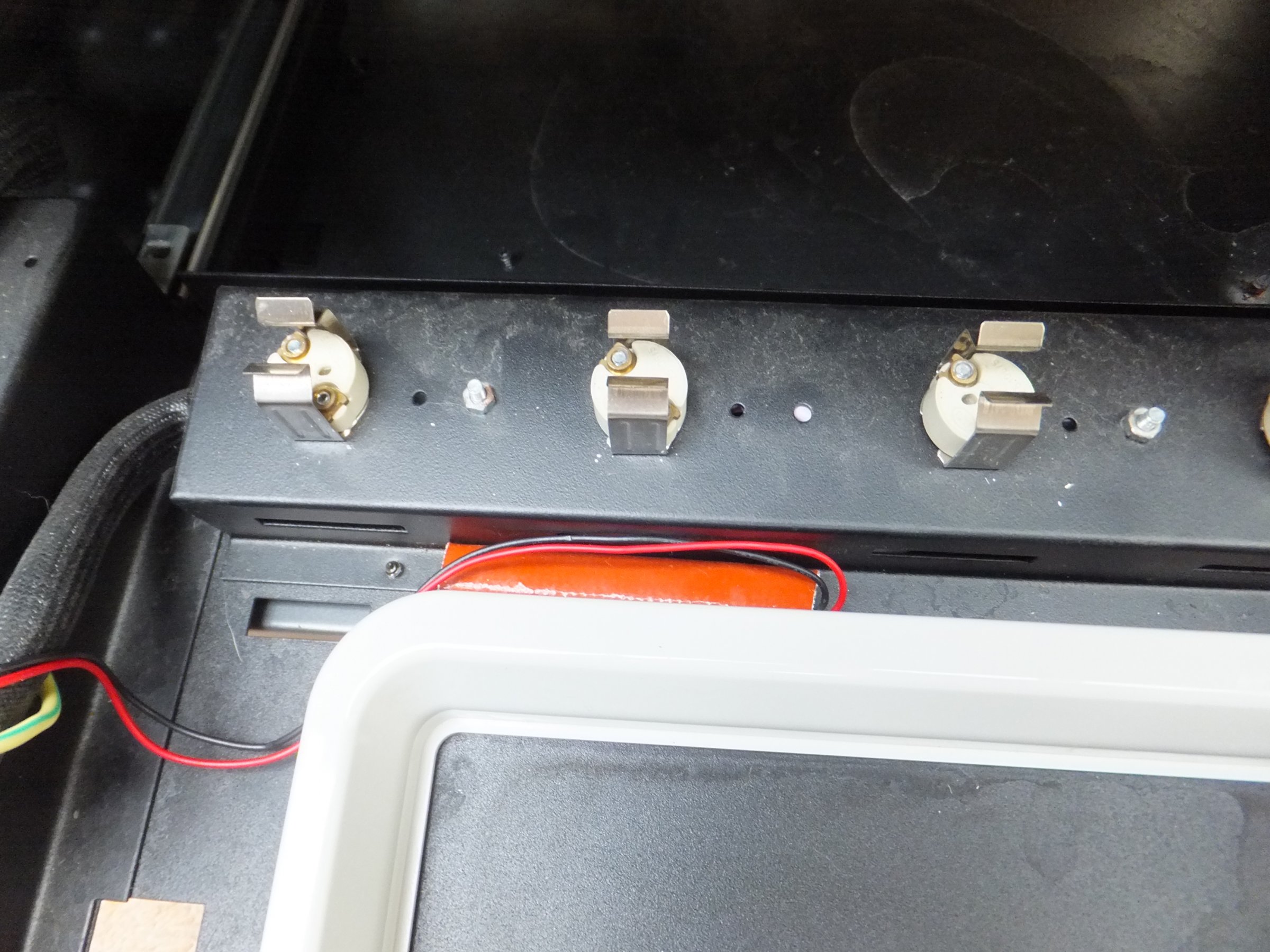

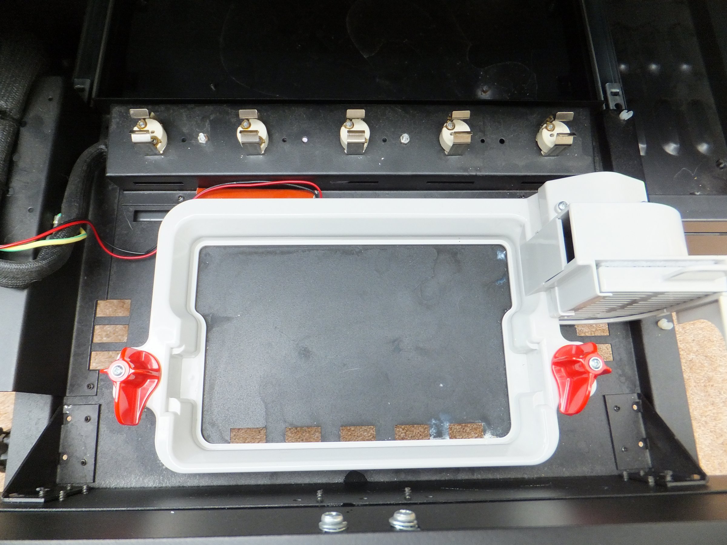

Hi AlastairE .
Not sure how to get the screws out as they are inserted from underneath and the lamp holders are not individual that I can see. Hope these photos show what I mean.
The drawer is out as far as it will go

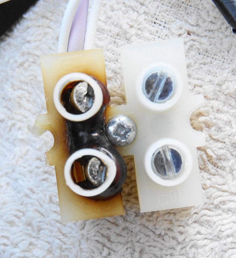

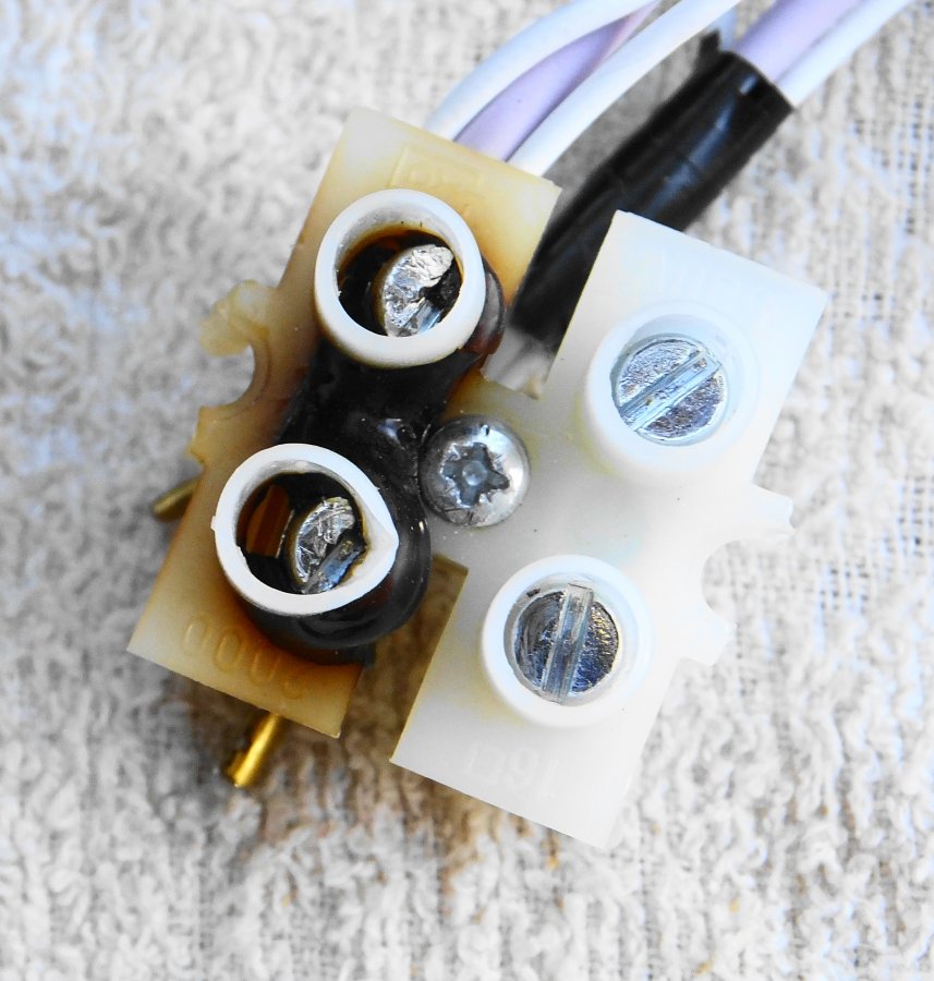

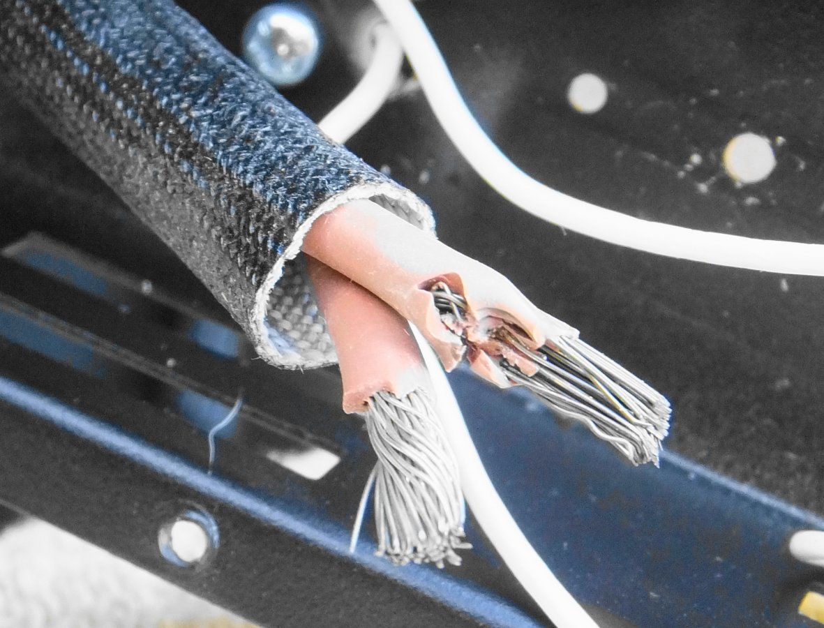

Thought you might like to see this. After taking out the lamp holder unit I discovered what is hopefully the only reason for the lamps not working. I haven't got any further just yet but will let you know the final outcome.
It's obviously a manufacturing error as you can see that the insulation has been clamped through and this resulted in meltdown of the connectors. . This is actually the second manufacturing fault I found as when I originally took out the transducer there was a similar problem.
I shall be sending these photographs to dimplex but don't expect a good reply, if any. I have found their customer service and after sales service to be appalling.
