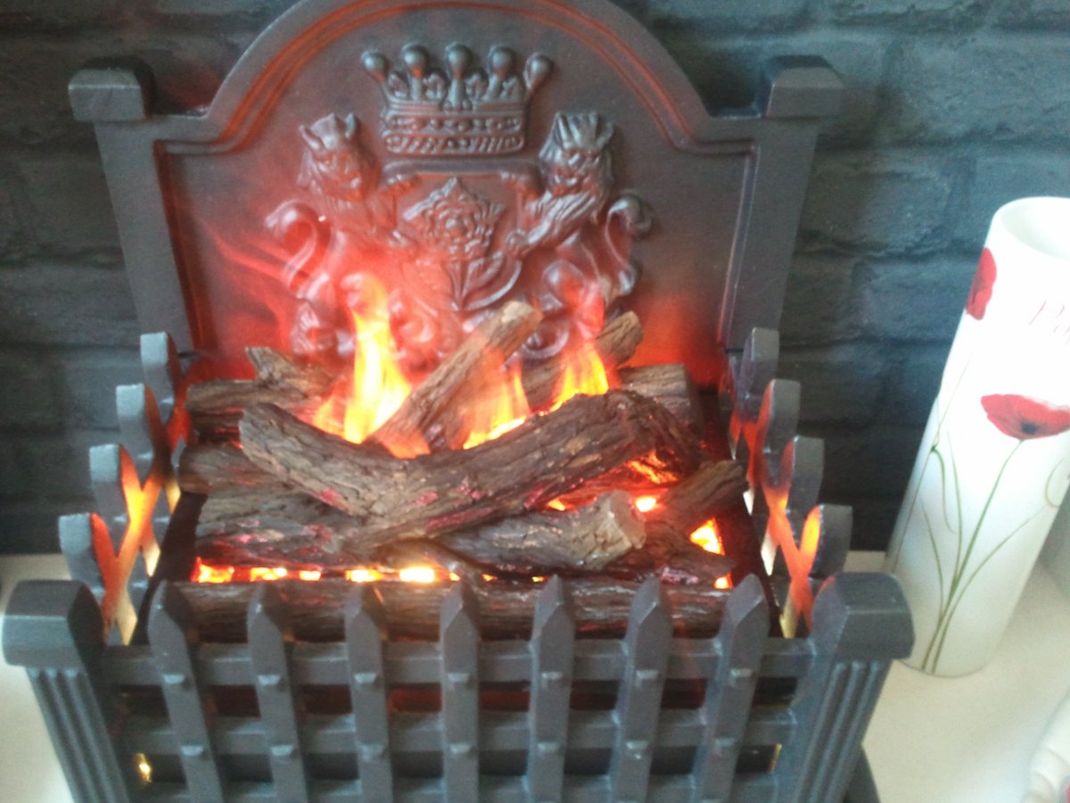

Thank you again AlastairE. We now have a working Cassington once more. No faulty light bulbs, no faulty lamp holders, just the burnt out wires & connectors as previous photos.
Now I can show you the best photo of all, the fire working! Can't see flames very well but they are certainly there.
Couldn't ha
ve done it without your help. cheers

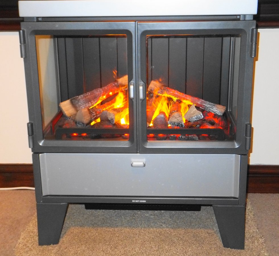

Hi! I have been interested in the Opti-mist and how they work, I have made one of my own, it uses only a 24v 2.5amp max DC transformer,this is because I had one doing nothing, 4 x 5w 12v vehicle capless bulbs designed in a unit to give off enough heat for mist to rise, I am using 24v LED's red and amber, 1 x 24v transducer, (and you can buy these for just under £3.00) I have designed a different way of making the mist rise with a minimum of heat used, no need for high watage halogen bulbs, ON/OFF switch for the transducer, so can just have light, and with my design I can regulate the mist, I would like to talk to someone who is able to help me out with some electrical solutions as regards a circuit board, have a video but not able to uplaoad
