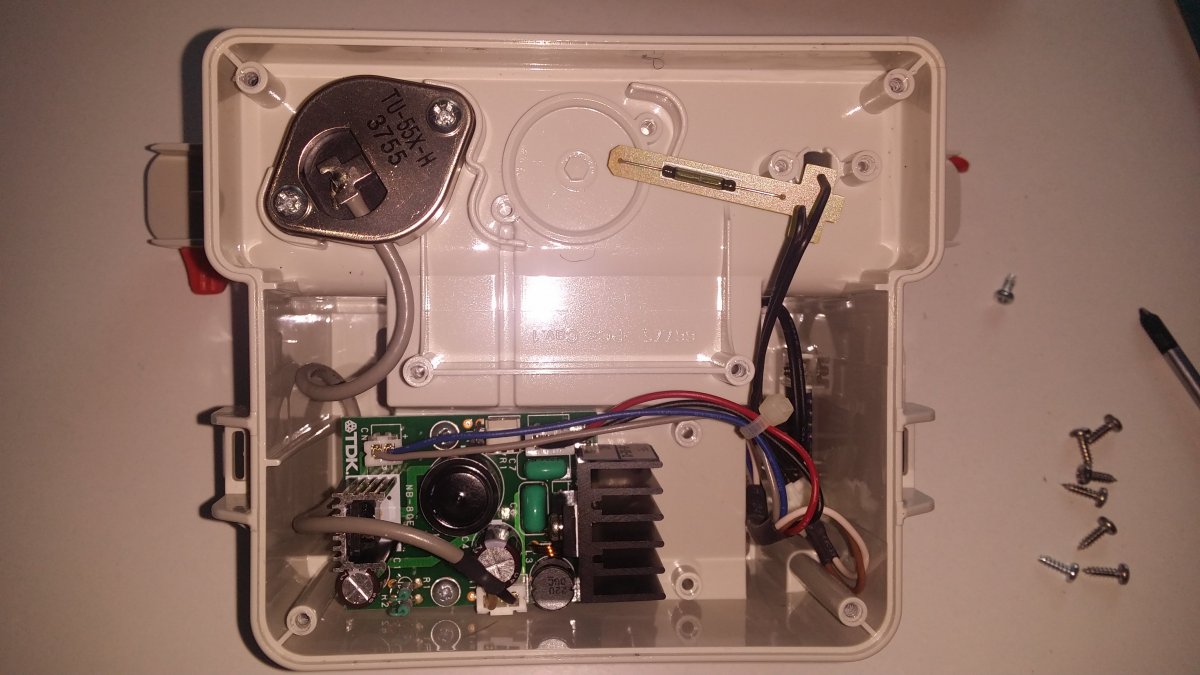

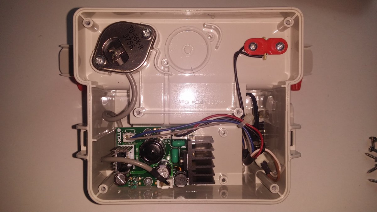

Following on from the recent posts, I have a Cavendish CHS20 (grey sump and blue water container) which has been repaired 3 times by Dimplex (under warranty). Now it has broken down again and the warranty has run out.
The problem this time is that when the fire is switched on there is a "beep" and a flash of the LED lights under the logs then nothing for about 4/5 seconds. Then another beep and flash and then nothing. This continues until the fire is switched of at the mains.
The sump has been cleaned and electrical connections checked, all to no avail.
I would be grateful for any suggestions as to what the problem could be.

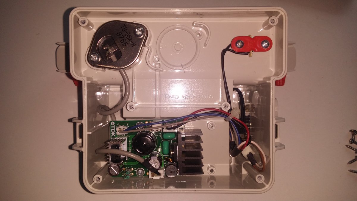

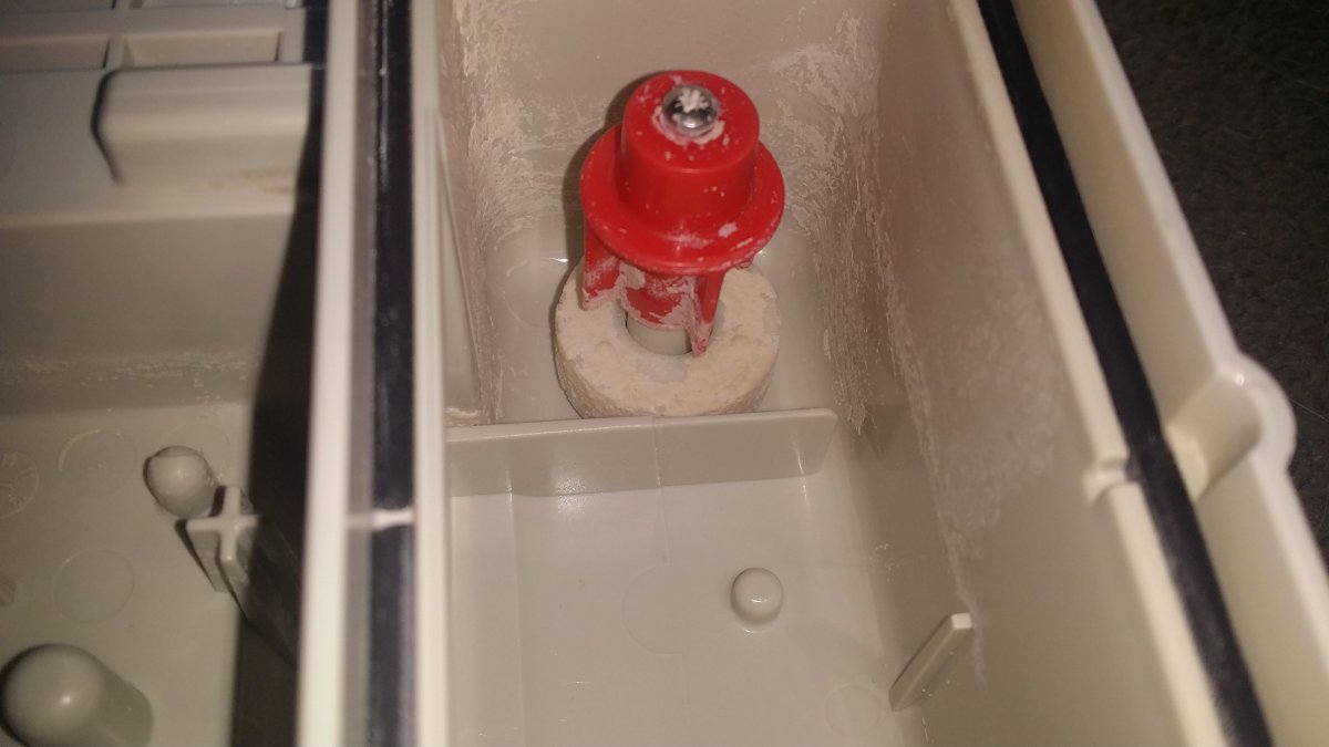

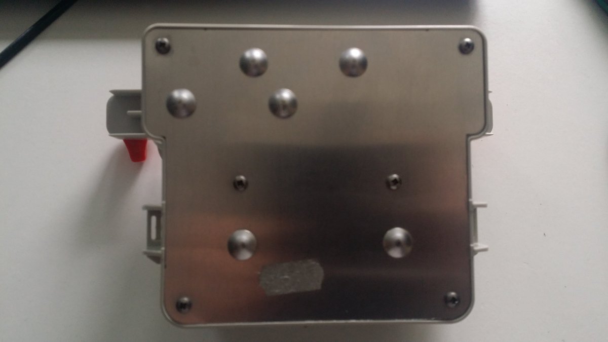

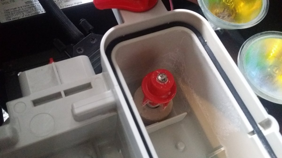

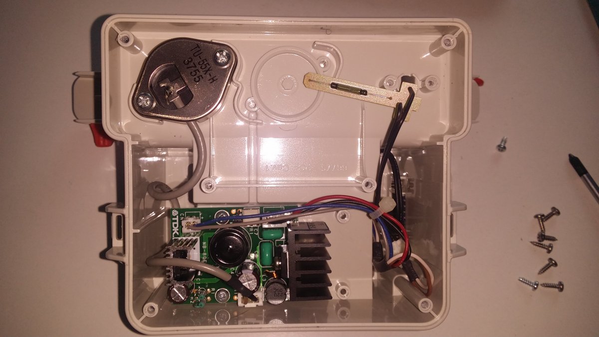

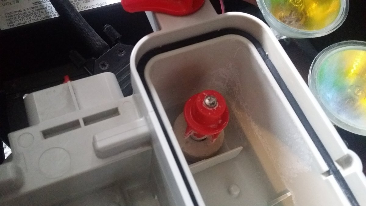

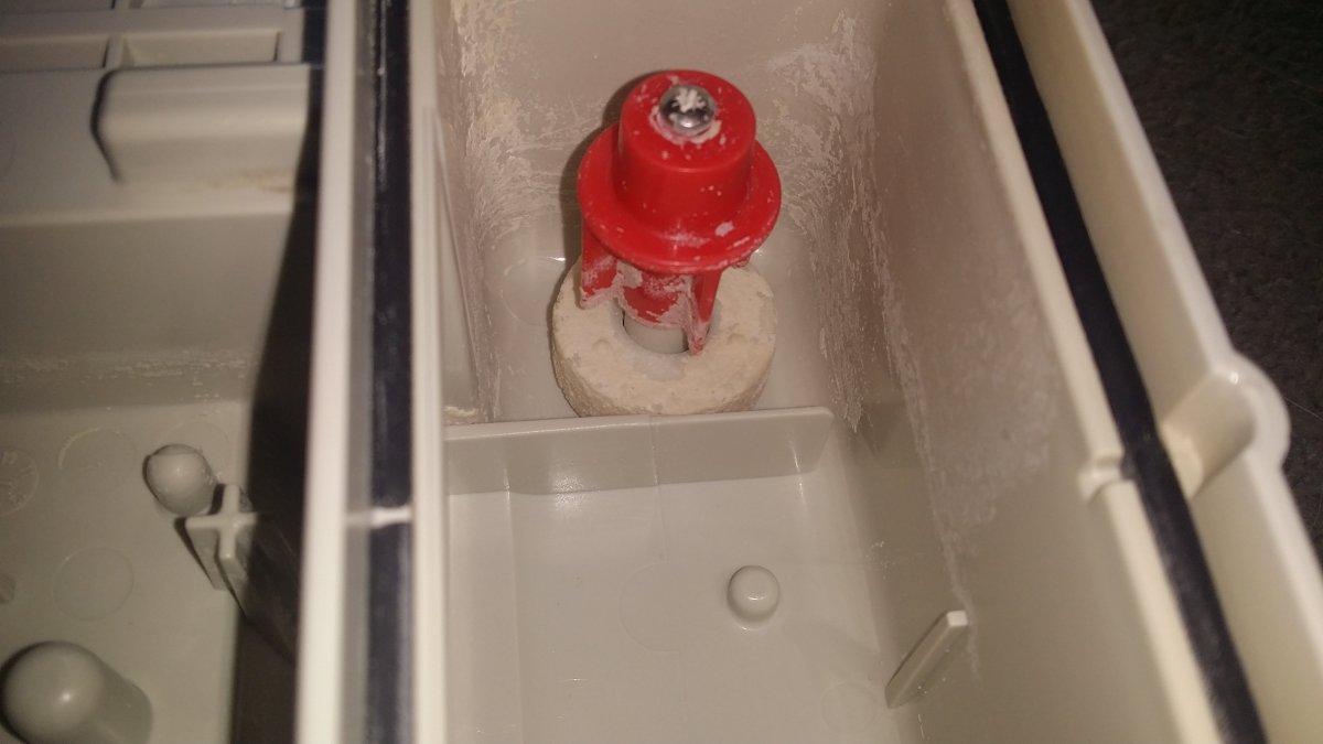

Hello Sam's Engineer. Your problem sounds very similar to a problem I experienced earlier in the year. What I thought was an electrical connection issue turned out to be sticky float around the reed switch container. I believe that limescale had managed to jam the float in the "water empty" position after I had finished cleaning it, which fooled the electronics into believing that the sump contained no water, thus preventing the system from "firing" up. It may also be that the reed switch itself could be faulty, in which case, the underside of the sump will need to be removed to gain access to the switch. Once the switch is removed it can be tested for correct operation with a magnet.
Hope this is of some help and that I haven't told you something you have already tried.

Many thanks Privateer for your interest, comments and very useful photos. Unfortunately the suggestions you made did not work. The float moves smoothly with no evidence of any deposit build up. Everything was thoroughly cleaned and I even made a direct connection across the "switch" wires - all to no avail. Again thanks for your help.
