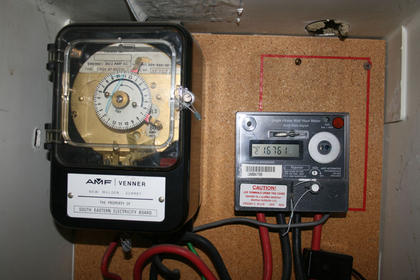

The supply switches from peak to off peak, how do the heaters know when to turn on and off? I cant find any sort of timer etc.

Is this via the clock on the meter? Ours is half an hour behind, so if the off peak is say 1am till 8am. Will ours be coming on at 1.30am and going off at 8.30am therefore running 30mins at peak rate?
It's a long time since energy suppliers had timeswitches in common use to switch the rate over. They were mounted next to the meter and look something like this. And yes they didn't keep time very well. Usually there are two arrows to show the time, an hour apart to reflect the change from summertime to wintertime. Or maybe yours has been set midway between the two times.
Generally now, a timeswitch isn't needed. The meters themselves are switched from 'peak' to 'off peak' by a radio signal.
In either case, the storage heater CU will automatically be switched 'on' when the change takes to 'off peak' takes place, and switched 'off' when the rate changes back to 'peak'
I used to have one of these and timekeeping was very good. It used a synchronous motor so was locked to the mains so as good as any electric clock. There was a clockwork backup to cover for short term power failures as well.
