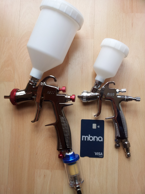

Since the r500 can be adjusted to have a fan height of 10cm or slightly smaller, the r100 is more or less redundant for panel painting. One use I can put it to, along with the air brush, is spot repairs. Here's a guy who's rather good at it and gives plenty of good tips.

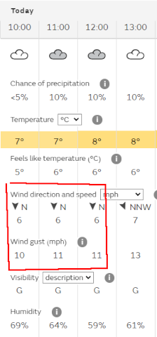

Another spraying window. A little cool but ok for base coat because it is the thinnest fluid and easiest to evaporate.

Usual problems arose, wind and dust. The dust was less of a problem because the 1k primer and base dried quick, allowing me to shave/scrape stuff off with a blade between coats. Dust is going to be a major pain with the clear coat because of the slower drying.

The R100 gun is in. The compressor could sustain it at 2 bar spraying indefinitely. The pair is basically a match made in heaven. The conclusion is, yes, this is suitable as a first gun for anyone dipping toe into painting with a 6L compressor. The gun has small fan pattern and needs more passes to lay down paint. It also has a small pot that is less convenient when dealing with large panels.
I rate it a good buy. It will allow me to spray on the driveway without misting up the entire neighbourhood. With a 1.0 tip, I could probably get the pressure down to 1 bar. I held back on buying the 0.8 tip. So, I have more options on reserve.
