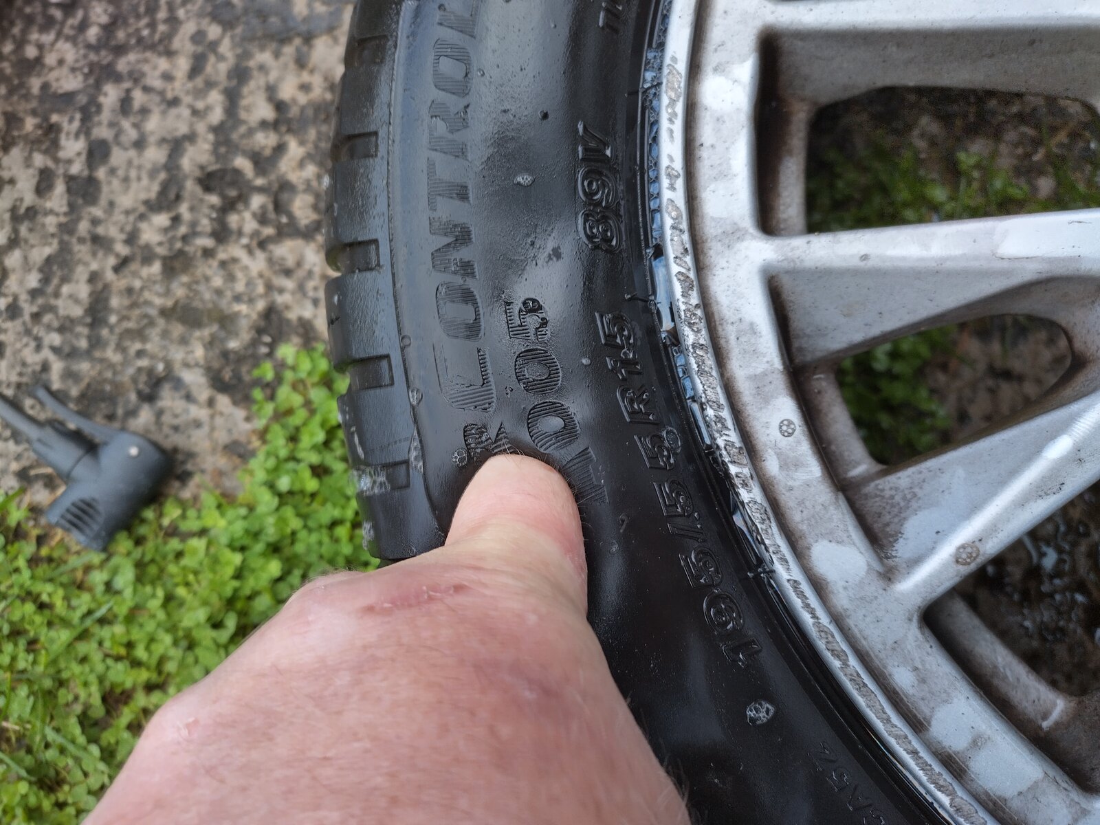

There's a difference between unidirectional tyres and ones marked "outside" (like mine). With the latter, you can't turn them round on the wheel (to equalise wear) but you can change them from one side of the car to the other.
The breakdown guy said this was dangerous and the car should not be driven until it is sorted.
Not true. My lad had directional tyres on his Audi Black Edition. He questioned this when he had a tyre fitted and was told it isn't a problem, but you won't get the full benefit of the tyre design. When he told me that I didn't believe it so we looked it up - and it turns out to be completely correct. Not dangerous.
Asymmetrical or directional.
Agree. Mot manual is slightly confusing but differentiates
Directional will fail if wrong. Asymmetrical will only be an advise
At worse, it will only be affected in the rain. If concerned, treat it as a temporary spare like you would with one of those temporary skinny spares and limit your speed to 50mph like it says on the side of those temporary spares.
