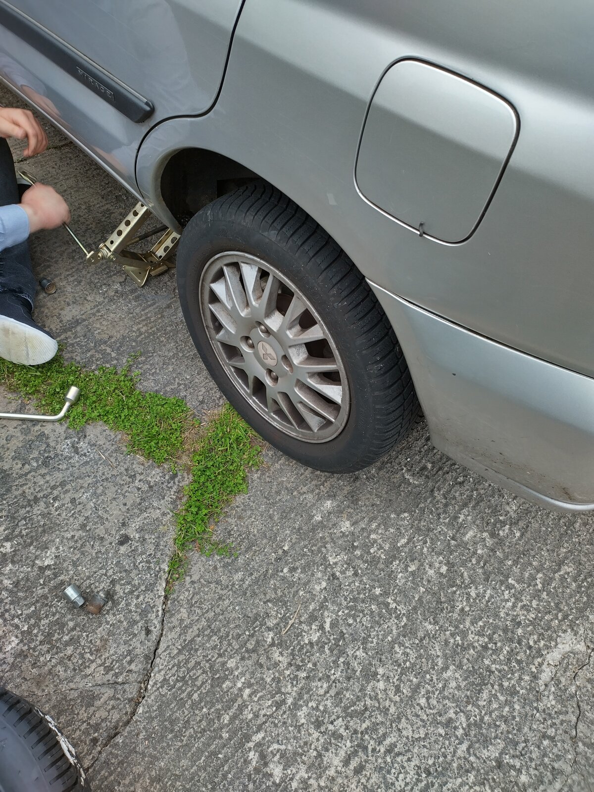

Me and number two son went out and swapped some tyres around.
Sadly the wheel locking nut key cracked and will not loosen the last one, so we gave up on the last one.
They're a pain the arse.
Then we went to correct the pressures.
So he's had a good lesson, including tightening up wheel nuts in a diagonal pattern and putting new tread on the rear, not the front.
There's usually a local mobile "locking wheel nut removal" service in the phone book.

In fairness I would say that unless you have a long breaker bar, a breakdown service may be needed if the wheel nuts were last air wrenched on. The standard wheel brace supplied with the spare often doesn't give enough leverage. A long breaker bar is a useful addition to the list of extras carried. I try to remember to crack my nuts :oops: after visiting a garage/tyre centre and do them up to a more sensible torque. Then if I need to change a wheel at the roadside, I'm in with a chance.

I had a locking bolt that had rounded so the tool kept jumping off. I parked next to a wall and used the jack sideways between the wall and the top of the wrench, to press it horizontally hard onto the nut while I turned the wrench. I got it super-tight, then slackened slightly to give just enough slack so I could turn it, then kept slackening a bit at a time while the bolt came out.
They hammer a socket over the buggered wheel nut.
Watched a vid on YT of the same. I am considering bashing them all off and replacing the original nuts. Are people still nicking alloys these days?
Alternatively, could a tyre fitter use the broken locking wheel nut key with an air wrench to a greater degree of success?
