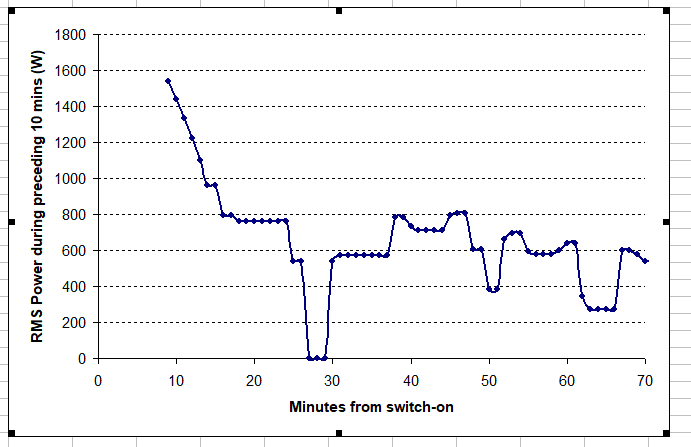

I have to say I was suprised at just how far off the mark the maximum demand calculation described in the onsite guide was when I applied it to my house installation compared to real life measurements - even in worst case scenario of christmas dinner.
Real life loads on most circuits are far below those assumed in the recommended calculation.
I have to say I was suprised at just how far off the mark the maximum demand calculation described in the onsite guide was when I applied it to my house installation compared to real life measurements - even in worst case scenario of christmas dinner. Real life loads on most circuits are far below those assumed in the recommended calculation.
Indeed, the OSG guidelines are generally over-cautious and, in a good few cases, totally outdated.
Sockets circuits are probably the worst. When the guidelines were written, the common domestic situation was probably just one 30A ring. However, recent new-builds and re-wires will commonly have at least three 32A rings ('upstairs', 'downstairs' and 'kitchen') and to have to count those as 57.6A (32A + 12.8A + 12.8A) is really pretty unrealistic (ridiculous?) in most cases.
Albeit fairly trivial in terms of the big picture, the OSG figures for lighting circuits are obviously ridiculous with LED lighting.

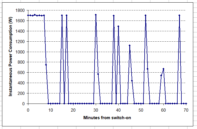

Even the 'standard diversity calculation' for cooking appliances is perhaps unnecessarily cautious, particularly for 'small appliances' such as ovens - a 2kW-3kW oven will cycle 'off' a lot once it has got up to temperature, so it's probably unnecessary to consider all of the first 10A. I don't have any electric cookers but a while back undertook (and posted here the results of) some experiments with a 1700W deep fat fryer. As you can see, it starts cycling on/off in under 10 mins and within about 15 mins settles down to an average of well under half (nearer tio a third) of its 'on' consumption....

I have a 7.2Kw induction hob and 5.2Kw double oven. If you get the timming perfect in a non real life situation I can get them to draw their maximum load for a relativley short time (a few minutes). Once Ovens are up to temp and pots on hob have boiled and reduced to a simmer the draw was a lot less than half maximum (Can't remember exact figure of top of my head but it was suprising).
The draw on the kitchen ring with a washer dryer and dishwasher running was also much lower than expected. The on/off duty cycle of the heating elements as shown in your deep fat fryer is applicable to a lot of appliances.
Quite so. Averaged over any reasonable period of time, the current draw is always going to be well under half of the theoretical 'peak' figure.

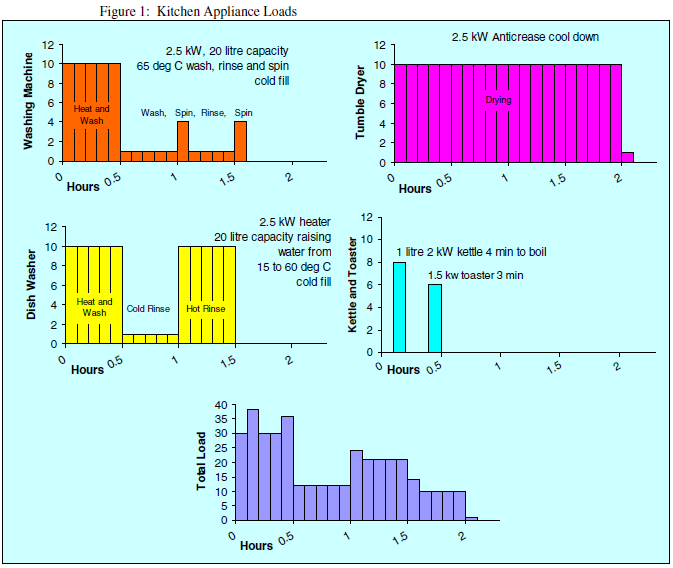

Indeed. It's probably time to wheel-out the oft-posted extract from 2002 'Wiring Matters', showing the current draw following the simultaneous start of a washing machine, tumble dryer, dishwasher, kettle and toaster (the later two staggered) - the total hardly ever got above 30A, and was half, or less, of that for much of the time...
