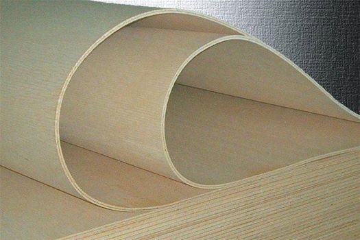

Next time (if there is a next time) try it with a router and a 60º v-groove cutter which will allow you to bend to a tighter radius. I also find soaking the outside before bending it into shape helps reduce snapping - doesn't always cure it, though.
The alternative is to buy some Bendiply, Superform or the like. The one problem with that stuff, apart from the fact that it isn't cheap, is that it does need to be glued to shaped (copy routed) formers to retain its' shape and being only 9mm thick so you do need to glue two layers together to get 18mm. I've used it quite a few times to make the fronts of curved reception desks, counters, refectory units, bars, etc. Amazing stuff
