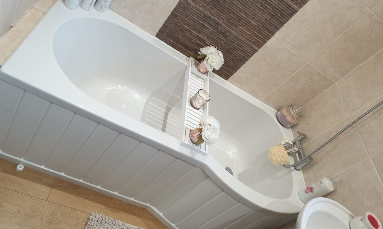

Hi, I’ve had this problem recently, removed our old p shaped bath panel thinking a replacement would be easy to come by! This one looks great, can I check how the plastic is fixed at the top. Is there some wood used around the top of the frame? I understand how’s it’s fixed at the bottom but can’t work out the top, both on the straight bit and the curve.
Thanks, I’m still not quite sure just slide under slot under the bath edge means? Our bath has a curved edge, then a lip so there is somewhere for the boards to go (behind the lip) albeit not slotted in. I am wondering if the soffit boards are just held in place by being in contact with the underside of the bath which would suffice? I was thinking a piece of timber of timber to hold them in place but this maybe difficult on the curved edge
The bath panels where I am currently working are simply held in place with silicone, then siliconed neatly with the same
Just sorted one for my nephew, used soffit pvc, its twin walled so ripped the rear every panel to reduce it to single thickness which bends easily.
Lay ply or board over top edge to mark shape of curve , cut this out and fix to floor inline to hold the base of panel and finish with pvc trim to form a skirting. water proof and easily cleaned.
White silicon to seal all gaps.Best of all just £10 for plastic.

Ideally, you drill thru tile and screw to timber below unless you have solid floors in which case some adhesive like Fixall should hold it.
I screwed the panels to the timbers at the base [small screws] and glued on a cover trim, then infilled gaps with silicone.

As previous post , baths have a lip at top to accept panels , small screws to secure to ply , trim from same uvpc suppliers as soffit panels.

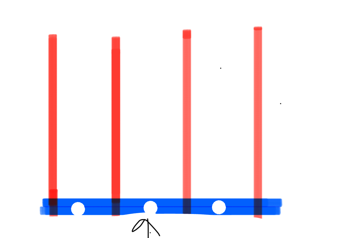

@foxhole Thank you for replying, it’s much appreciated. Sorry to ask more questions - I get very brain foggy at times. Am I right in thinking the screws go through the bottom of each ‘panel’ and into the ‘side’ of the ply, which will be secured to the floor? Then the screws will be covered by the trim? Like this..the blue represents the ply attached to the floor, the red lines, represent the plastic panels and the white dots represent the screws?
Yes screws go thru a narrow points (groove)on the panel ( only two per panel required ).Doesn’t have to be ply just any timber wide enough to be able to mirror bath shape .
Thanks again it really is appreciated. It all makes sense now!
