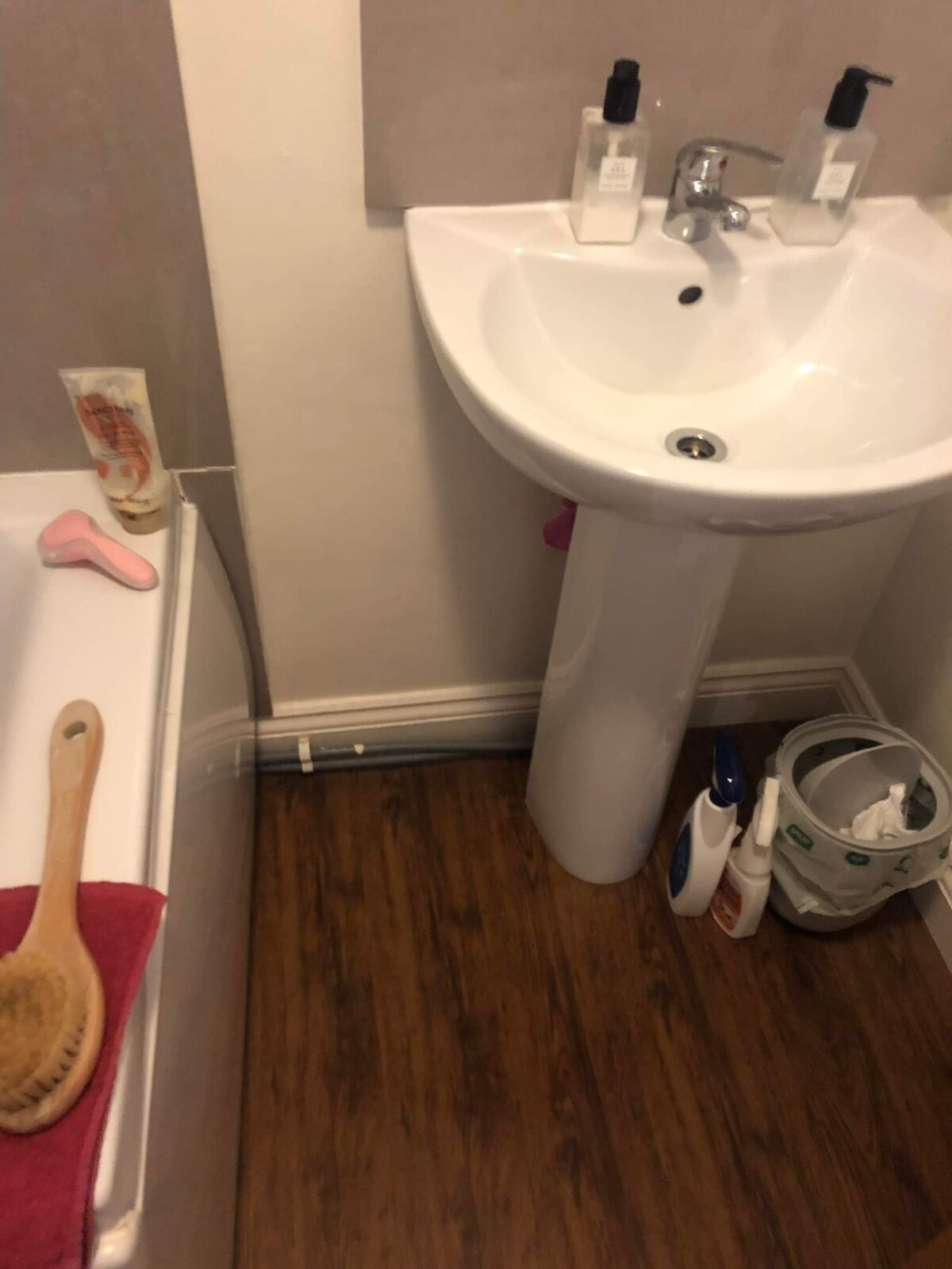

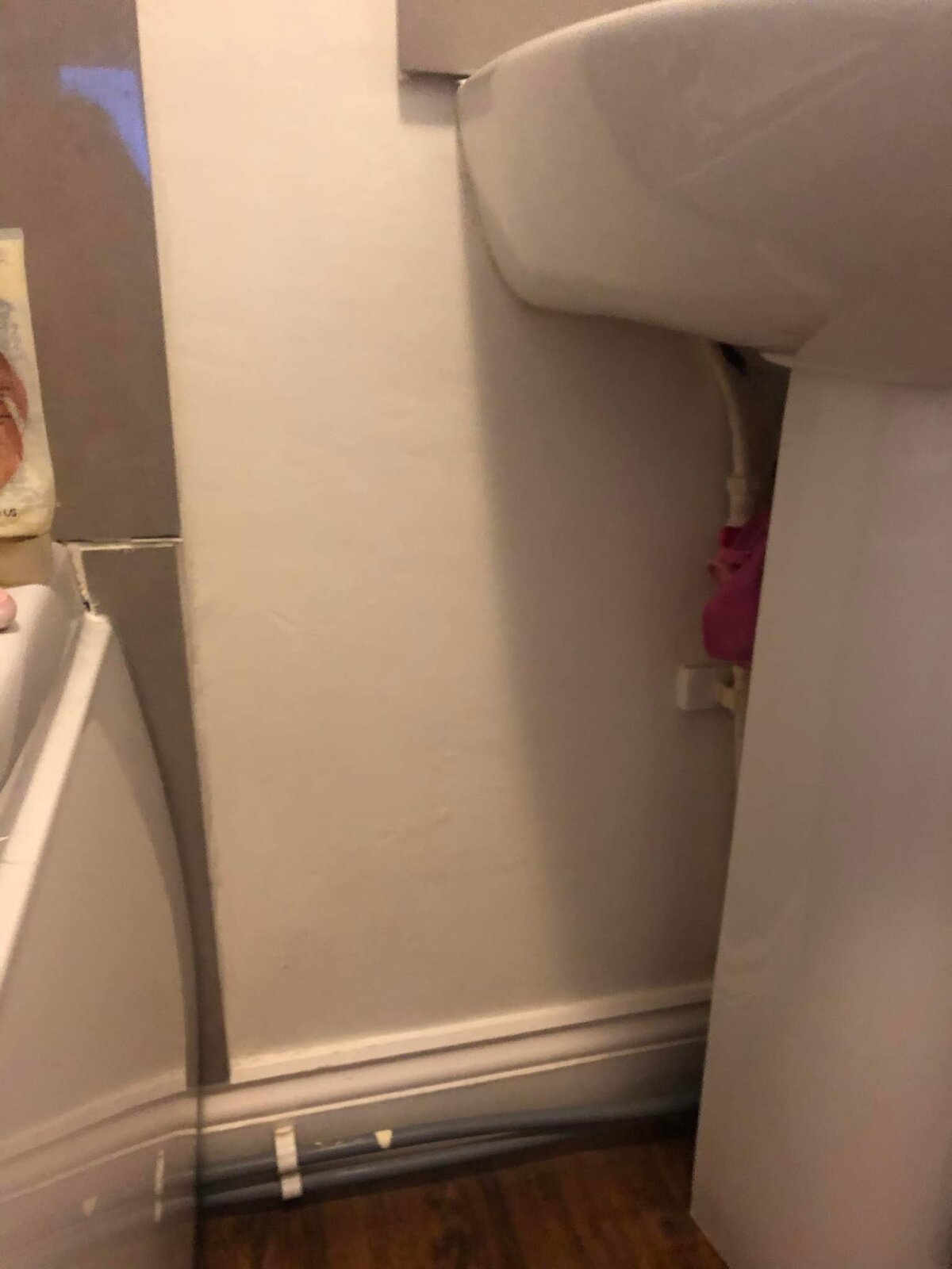

Photos. The pipes behind the pedestal go down to the floor.
Doesn't look too bad as is tbh.
I imagined waste pipes, etc half way up the wall.
Try some white pipe covers over them. Might make them 'disappear'
Are the pipes flexible? Look plastic from the pics.
Some trunking skirting board might do the job
The ones on the floor are easier to deal with. When you're in the shower the ones behind the sink are really noticeable and have decades of gloss paint on them.
You know what it's like once you know something's there
I’d just paint the horizontal pipes to match the skirting. Maybe the same colour for the verticals.
or paint the verticals the same colour as the wall.
Yes, you’ll see them, but you can’t make them disappear no matter what you do.
I can see my basin water supply in front of the tiles and behind the pedestal.
I painted them white but they can’ vanish.

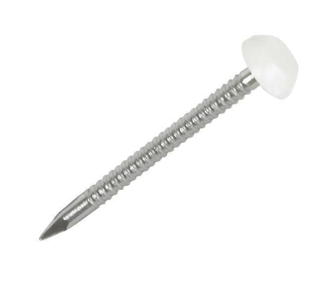

how did you fix the plastic trim along the bottom where the curve is? Pins or glue? We've got some 2 part strong as s... t mitre adhesive but you only get one shot at a job Thinking the trim's flexible but will always want to go back to straight . Thanks
or you can screw and use white screw caps, or a blob of white silicon to hide countersunk screw head.
only requires one each end of curve and on ends.
