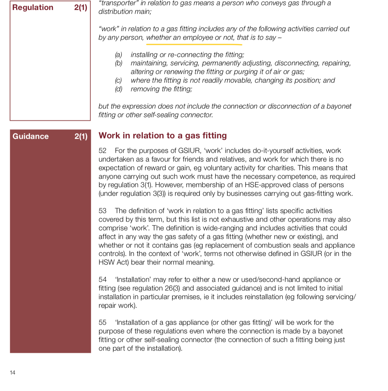

what law is that in?
The "Gas Safety (Installation and Use) Regulations 1998" which doesn't discriminate between at work or at home. Which the previous 15 pages have demonstrated. Hopefully.
ah, do you mean where it says "any person, whether an employee or not"
Perhaps, I'm just stating the law as it is, not how some people want it to be. I am actually enjoying the discussion but realise you could bring it to an end if you want to.
I've seen a document that says
"Under Regulation 3(3) of the Gas Safety (Installation and Use) Regulations it is an offence for any employee or self-employed person to carry out gas work unless the employer or self-employed person is a member of a class of persons approved by HSE for the purpose. The Gas Safe Register™ is the only body approved for this purpose."
which is not the same

Not the same as diy activities though, this probably relates to people at work.
Have a look at this - a screenshot from gas regulations, highlighted yellow and paragraph 52:
Edit: The wording of “work” is in relation to gas “work”, not being at work btw.

If work, as deemed in the gas regulations was carried out on an appliance, then a suitably qualified gas safe registered engineer with knowledge (ccn1) and ckr1 would be required. No ckr1, can’t work on a gas cooker/hob.
A common sense approach is often overlooked, if say for example it was the glass in a grill door - anyone can replace this as it’s not classed as work on the grill. Flame failure/detection & combustion related stuff is gas work.
