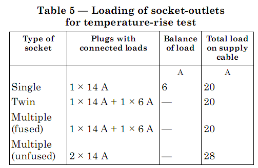

The total load on the supply cable is also specified - for a single socket it has to have an additional 6A flowing.
(A later amendment changed the multiple (fused) loading to 20A evenly distributed)
Please see Appendix 15B.

How sockets perform with a load on the supply cable >20A is undefined.

How sockets perform with a load on the supply cable >20A is undefined..
Are you trying to say that domestic sockets are not suited for use on a (standard) 32A radial, ever? I find it hard to believe this would be unsafe, but what would you have me do here?
Why?
What does that mean when there is a 20A loading at the socket?

What about 433.1.204?
Are we to wire all sockets on a short spur form the main circuit - ring and/or radial - cable?
To replicate the design point of a ring final, which is no sustained current in any part of the circuit > 20A?
Not 14A + 6A any more.
What are we to make of today's revelation?

Not on a 32A ring, but I would give serious consideration to doing that on a 32A radial, for the simple reason that you cannot buy a BS 1363 socket which has had to demonstrate any capabilities wrt circuit cable currents > 20A.

Realising that BS 1363 conformance does not guarantee that a socket will not overheat when the load on the supply cable exceeds 20A.
Run the cable for the 32A radial, and take short drops to each socket.

I take it to mean 20A evenly distributed between the outlets.
"Evenly distributed in the supply cable" makes no sense, as the supply cable carries 20A.
Yes, but the socket conditions are the same
Indeed they are. No more than 20A on the cable supplying the socket.
and evenly distributed in the supply cable obviously refers to a ring.
No, it refers to the cable supplying the socket in the tests required by BS 1363.
