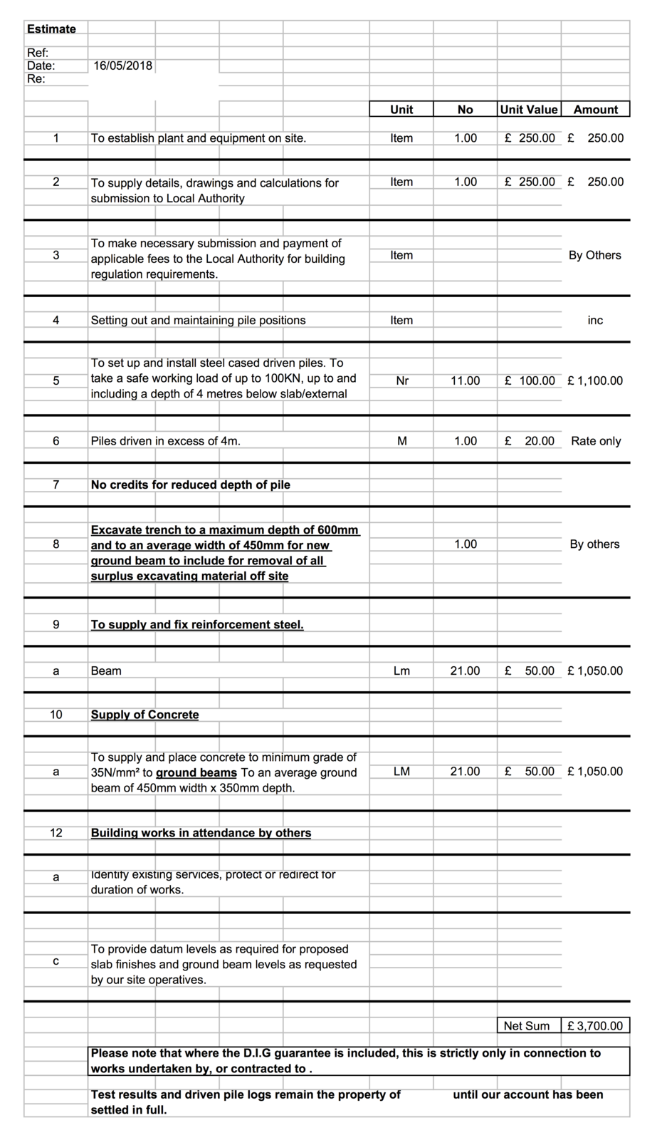

Can you brake down how much was the pilling, and the concrete? How many cubic meters you got in?
In awe... inspirational stuff! Our ground is full of bricks, old milk bottles, bones, concrete but yours' really is next level.
So difficult to sit down and cost something like this on your own so hope the costs start to stay steady. Looking great so far.
The company gave me a quote based on sending the piles down to 4m and then mine was £20 per pile per metre after that. I think three piles went to about 6m, the others were within the 4m.
They quoted the concrete in metres based on the concrete pour being 450mm width x 350mm depth and mine was for 21m length. They quoted £60 (inc vat) per metre for this so £1260 for the concrete. About the same for the re-inforced cages that ran the length of the trenches. The piles were about £1200, some site setup costs, engineer drawings etc... here was my quote ex vat.
I thought so at the time, all we had to do was excavate the trenches. We are North West too, not sure if that makes a difference!
Well I did a piling job in Sussex for a 6m x 6m extension. The driven piles plus filling the tubes in concrete and leaving rebar poking out cost £5k +vat. (Quotes ranged £4k to £9k).
The cost to do the reinforcing metalwork and cast the concrete ringbeam was about another £4k.
Pricing is significantly higher in this area (Sussex, Surrey, Kent).

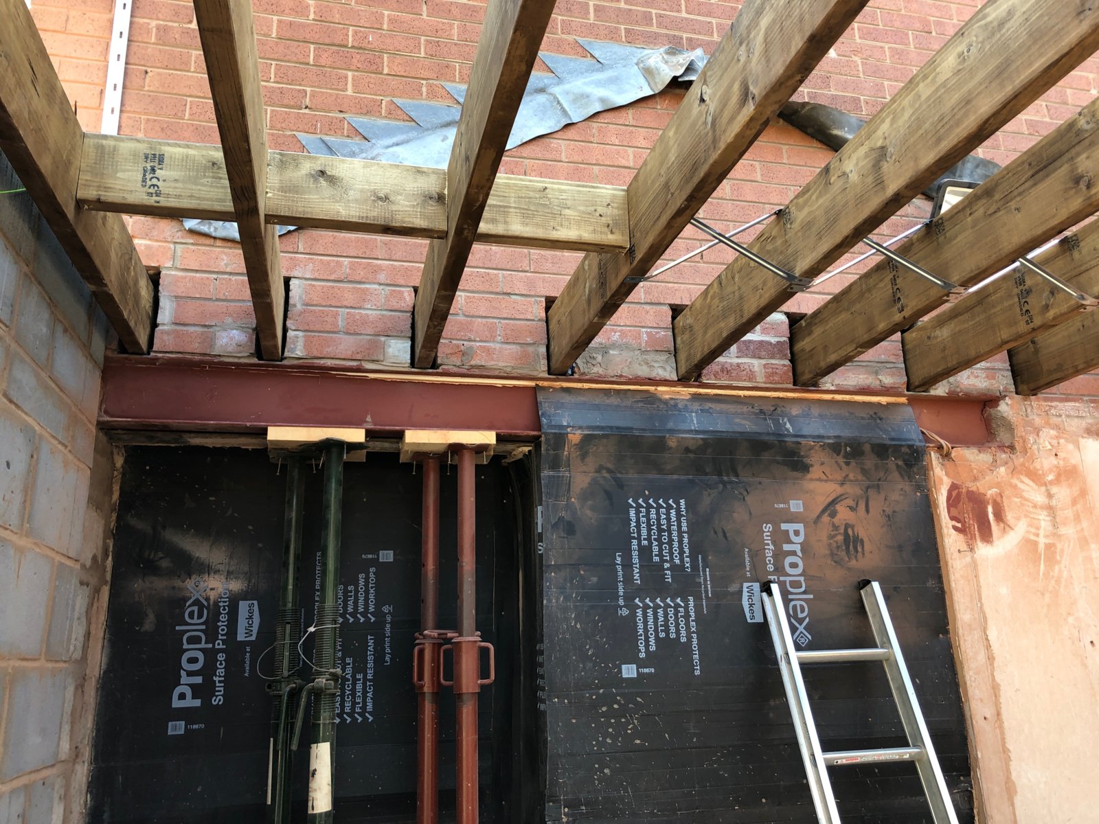

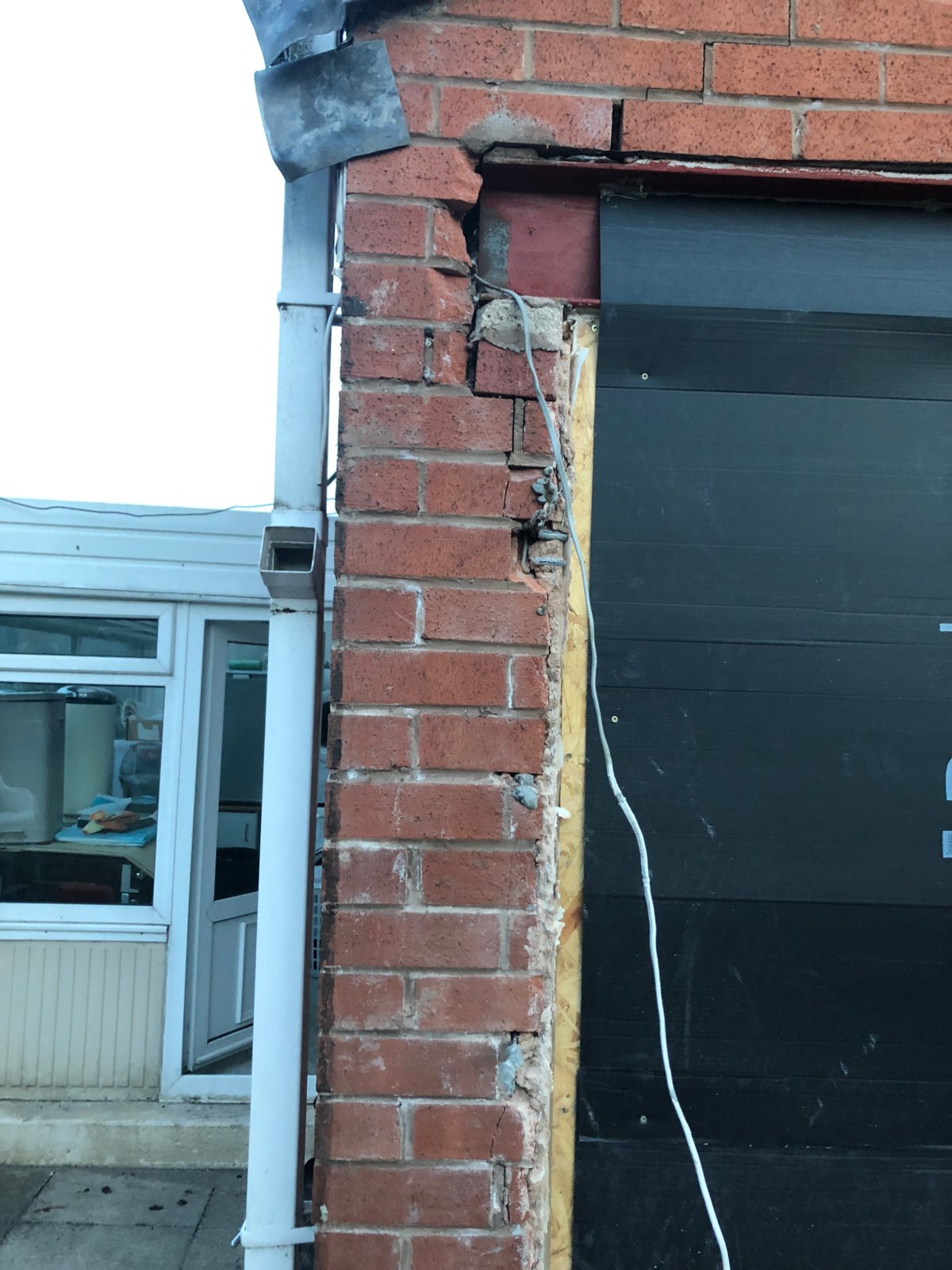

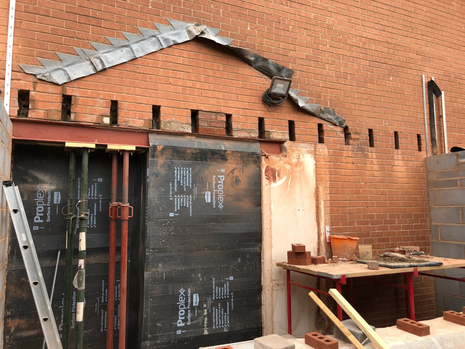

The wall where the previous extension butted up to. The building inspector has said this needs opening up for a vertical DPC so i'll have to rebuild this section of wall under the lintels.
Hello,
im a first time poster (long term lurker) but the beam lintel through the original extension looks extremely ropey to me. Its not sitting on enough of a bearing length on the top course of bricks and then because of the brick bond underneath where there are 1/4 or 1/5th bricks where the brickwork was cut out. Its then sheared through at least one of the full bricks (3 courses down).
You can see the beam has consequently dropped on the left hand side, hence the cracking in the brickwork on top of the lintel.
It really doesnt look to clever at all. Could only recommend getting in a structural engineer and get a good few acrow props under it for the time being.
Hello,

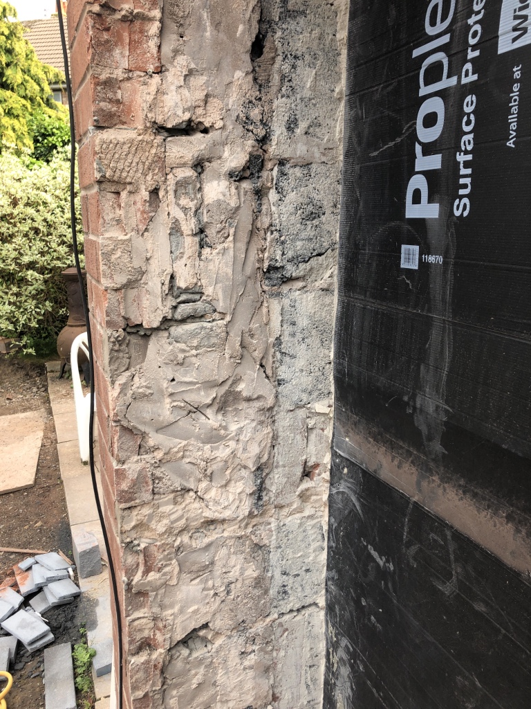

Hi

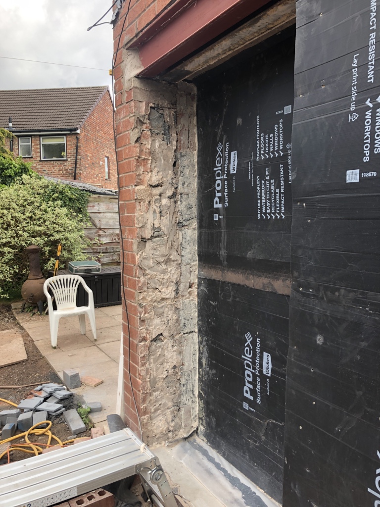

Yep, it was noticed when I took the old extension down. The movement has been like that a while from what i understand (I believe the extension was done in the late 1980's. I have had a structural engineer visit and confirm the lintel is adequate to take the weight of the new extension floor, and that the bearing was okay (although they didn't see the side you're seeing now as it wasn't exposed). When I removed the plasterboard from the wall this is what i found...
I'm going to prop the lintel and rebuild the bearing wall as I have to cut the wall end to open the cavity for the new extension.

Rebuild Lintel Bearing Wall

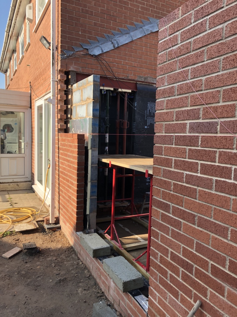

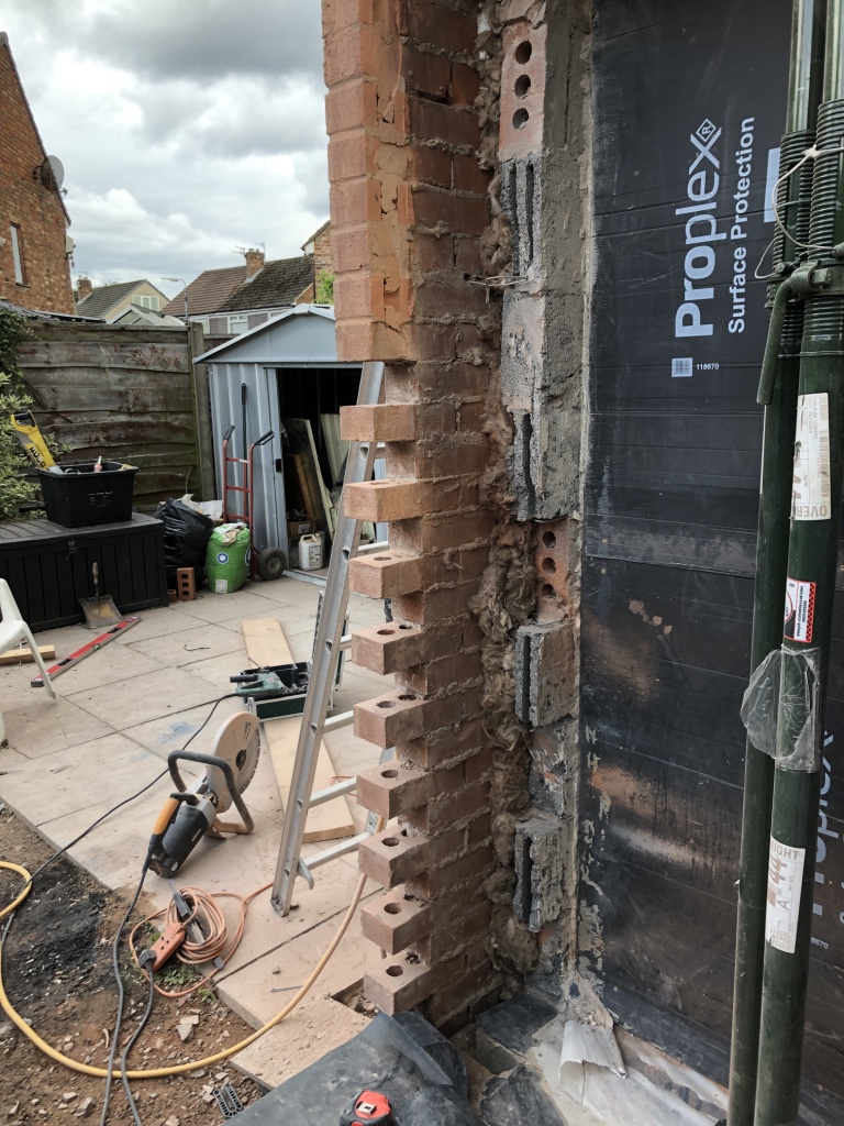

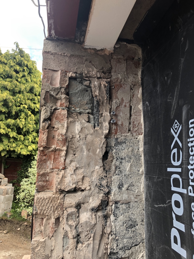

I had to prop the already in-situ lintels with props and then remove the "rubble/makeshift wall".
Most of the wall under lintel pulled away without much effort.

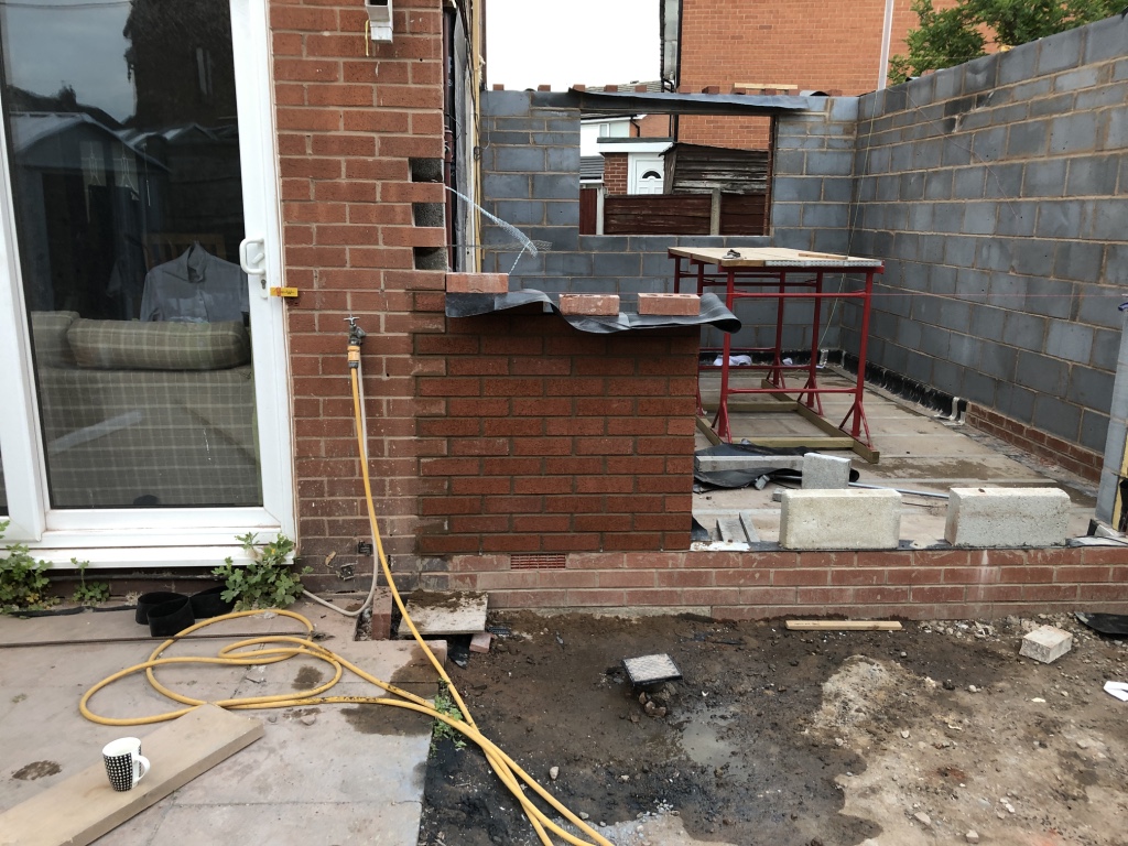

Started building that side of the wall.
Built the block wall under the lintels and then the new extension block wall. I installed a concrete lintel under the lintels and packed any gaps with slate.
The extension wall built and joined up with a lintel to the rest of the extension.

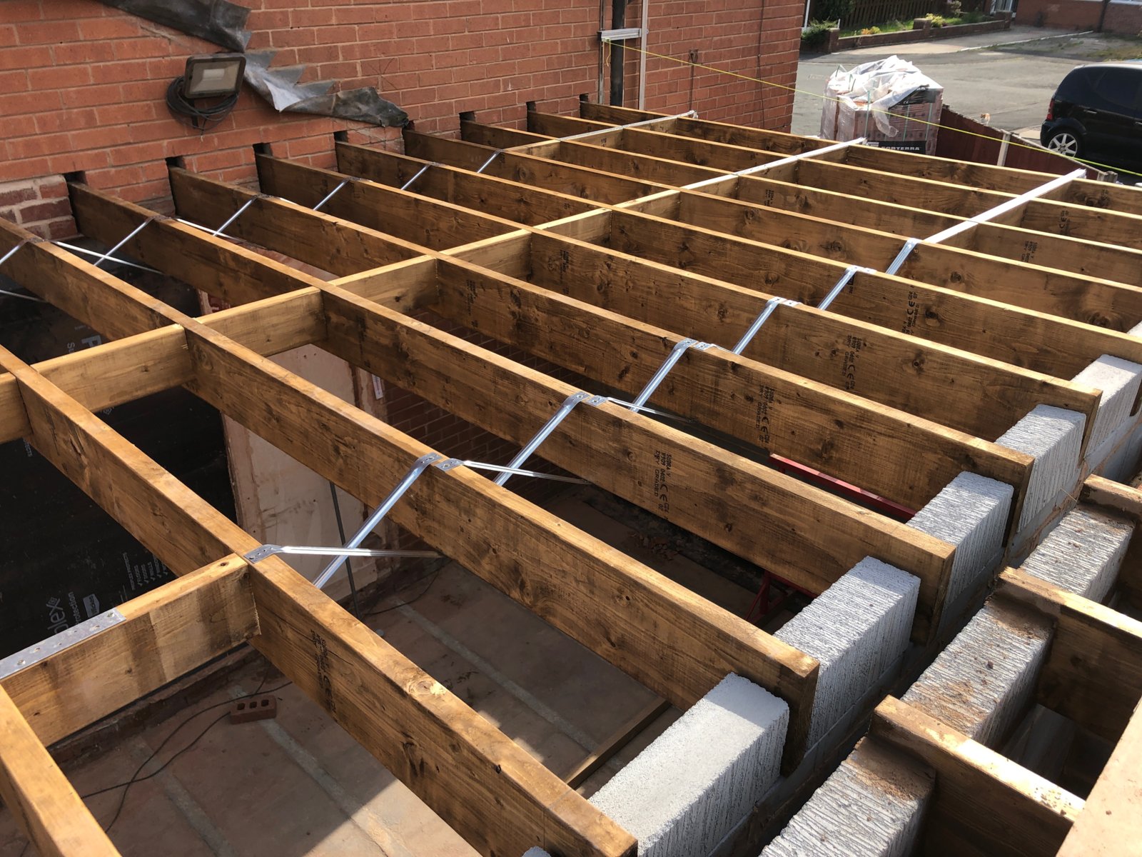

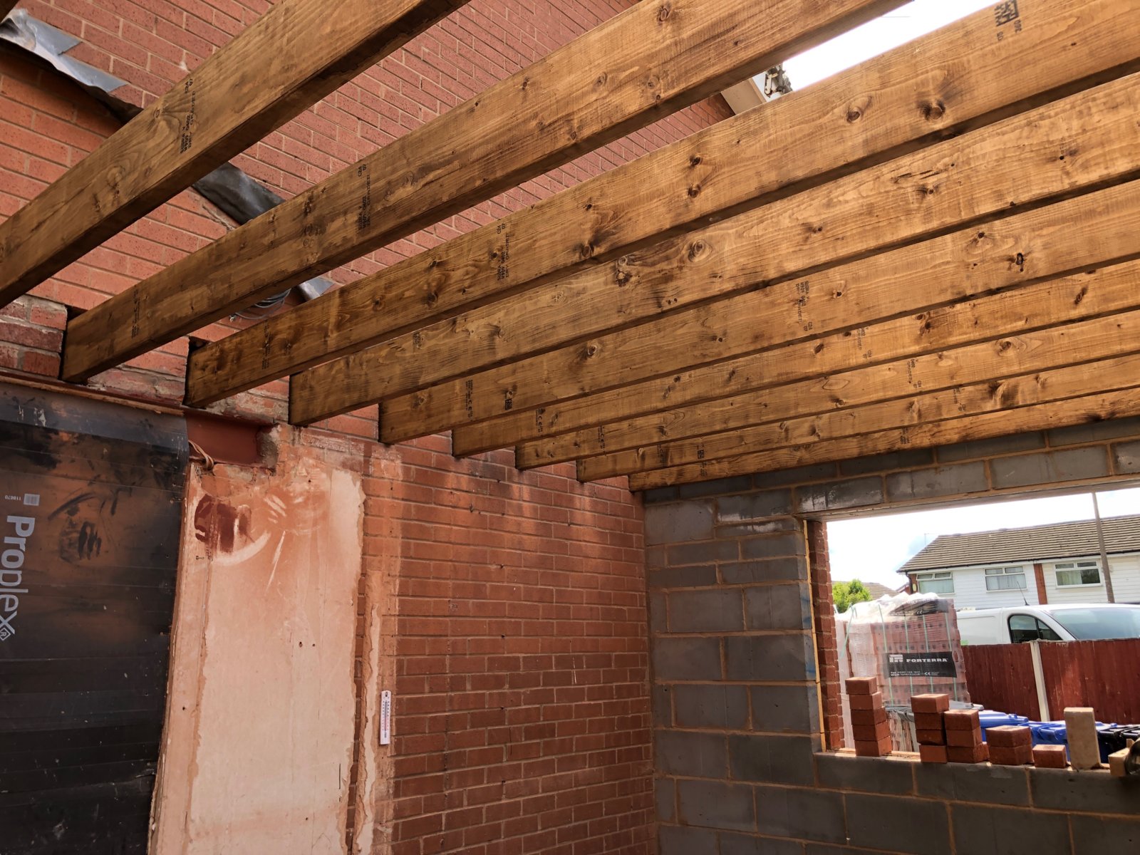

Installing the floor joists

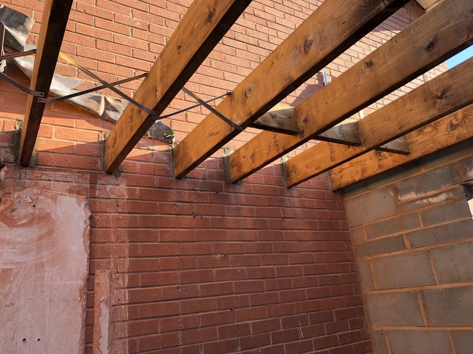

I had to find the level of the existing house floor which was perhaps easier due to the already installed lintels which support the current first floor. Even so, I drilled the first hole on the far right to try and see the existing joists. From this I could ensure where the floor level was.
The joists were 400mm centres so I marked out the positions on the existing house wall and stitched drilled the holes, then used an SDS drill and hammer and chisel to out the holes; thirteen in total. I had to make good a few bricks that had crumbled when making the holes.
I decided to treat the joists before installing them into the walls.
I mortared the gaps around the joists.

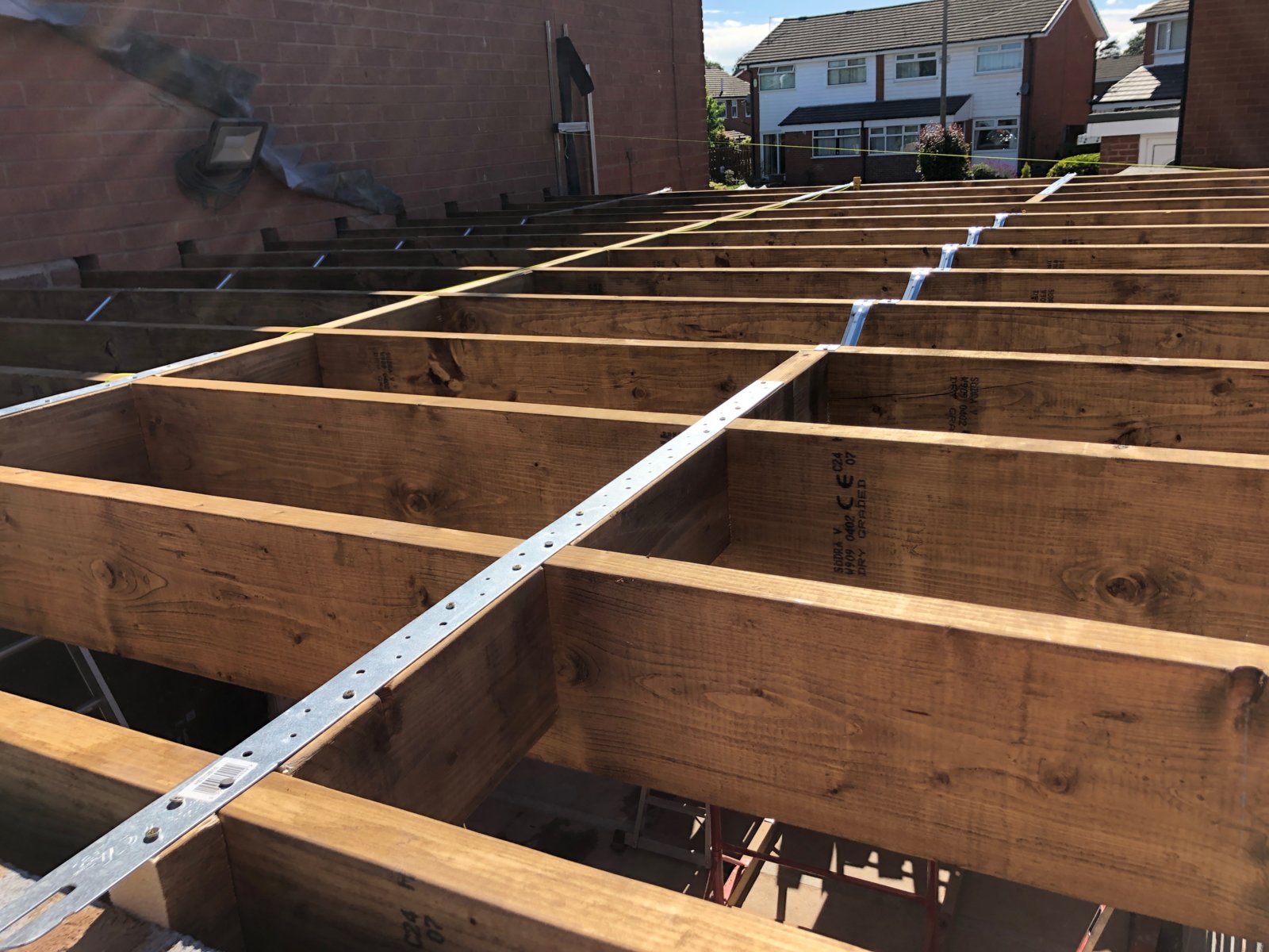

I installed noggins at the midway point across the floor and herringbone straps at 1/3 and 2/3 positions using a string line to ensure they were in line. Lateral restraint straps were also installed at 1/3, 1/2 and 2/3 positions; perhaps a little overkill!
Joists from above.

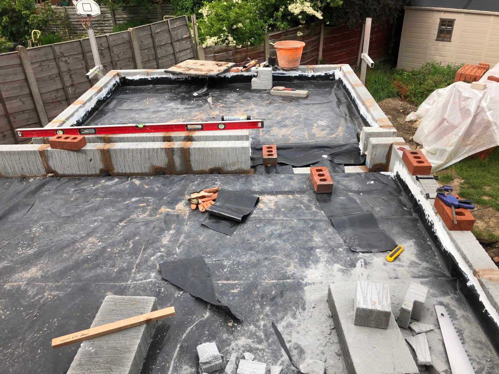

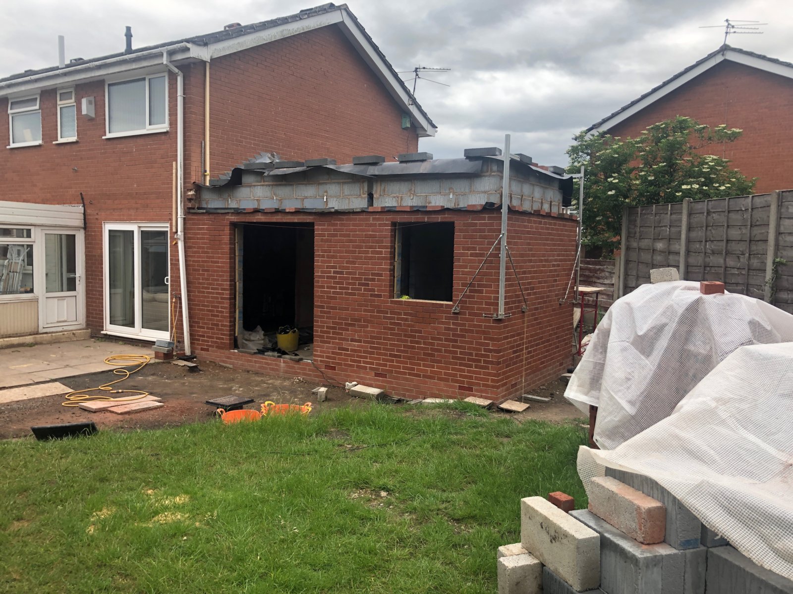

Chipboard floor laid and covered with DPM sheeting to keep the rain off. Of course it lashed down for about two weeks after this! :rolleyes:
Block work going a little higher.
