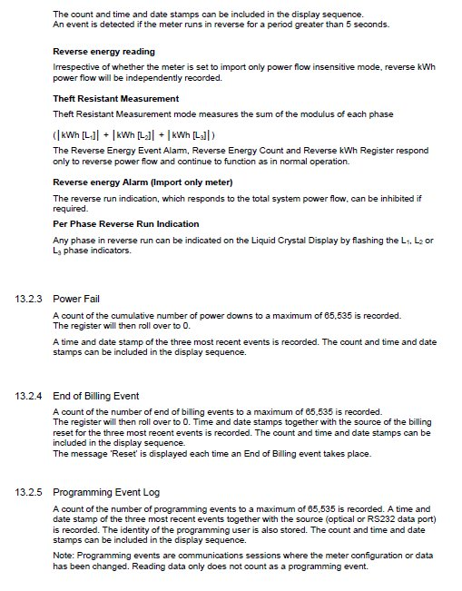

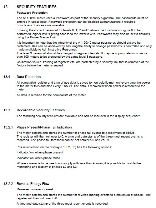

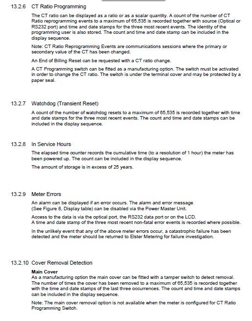

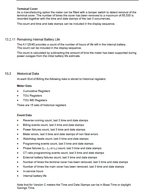

To return to at least partially addressing the question in the title of the thread, it appears that at least some of these meters do have a fair degree of 'tamper detection' built in. I think that my meter is potentially 'smart', although it isn't being used as such (doesn't even have the communications module installed). The following show the 'Security Features' part of the manual, which show that it can (as an 'optional extra'!) detects, counts and records the number of times both the terminal cover and main cover are opened, and also records the date/time of the last three occurrences of each of these events ....
Kind Regards, John
