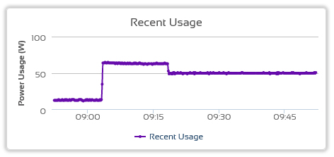

I have no problem with a electric meter with telemetry, I do however have a problem with auto disconnection, and a meter which is hard to read, a meter using some thing like IFTTT so it can tell other devices when power is cheap so I can use it during cheap times seems good.
However I have seen this before, I can see the power I am using on the PC,
but I have no way to use this information without human intervention. I can't set it up so when it stops using power some other device switches on automatic, I need to read the display and use another program to switch some thing else on, I have good telemetry but nothing is really Smart.
I see we can get EV charging points with monitor rest of house usage and adjust the EV charging to ensure no overload, and we can get devices which can use excess electric power to heat our water, but when my father-in-law had a smart meter installed we thought we as his children could monitor his power usage to see when he was using the kettle, etc. This would show us he was OK without intruding too much, my mother we had pet cam set up, but the smart meter readings would have been enough, but no one seemed to know how to do this, which seemed rather dumb.
Until the information from a smart meter can be used by the home owner to automatic do things, like turn on a washing machine when the rate is cheap, without human intervention, they are dumb meter.

True, but it helps considerably if you know what is using power and how much. Most people are pretty clueless as to where there consumption of power has gone ...
