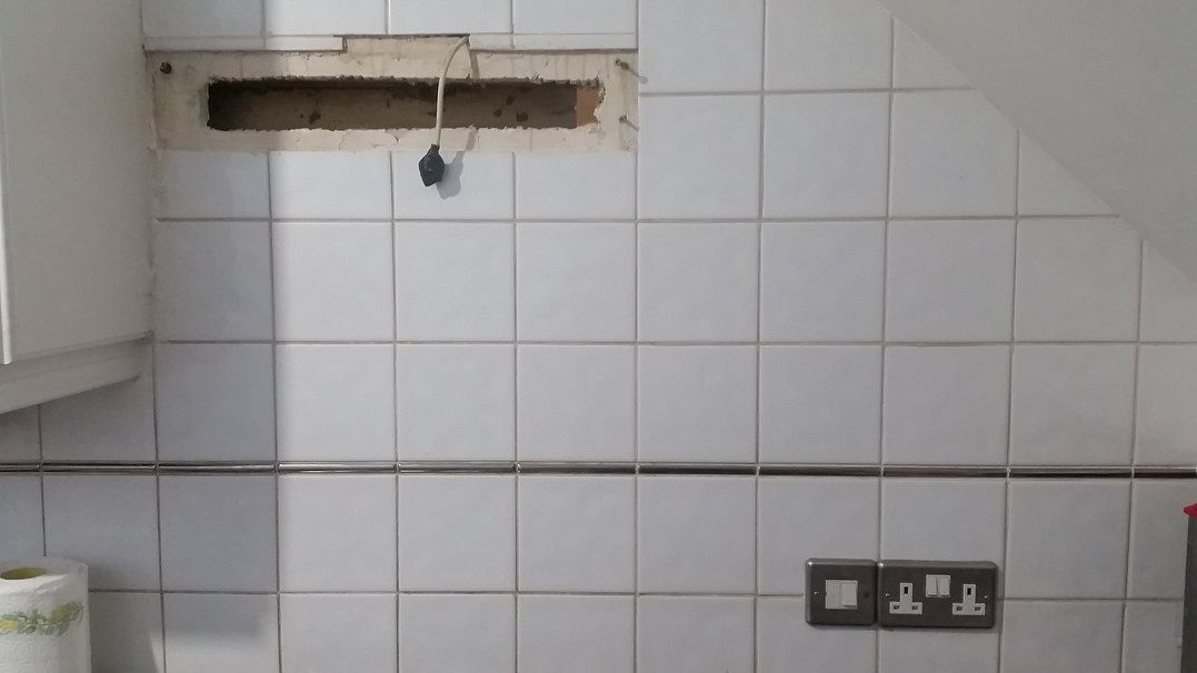

I have removed an old extractor (installed by previous owner) to be replaced with a new one.
The old one did not have a plug but the cable was attached to a live cable behind the wall using a connector block.
My handyman says the new extractor fan has to plug into a plug socket?
Does it? Could I not just cut the plug off the new extractor and connect it in the same way as the old one? Should I first find out if there is an isolator switch? and should it be a certain distance from the extractor fan.

I can just see a live cable behind the plaster.
I've wrapped the end with amalgamating tape.

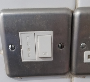

EDIT: Just confirmed there is an isolator switch on the wall I've never used and it does appear to make the cable live (using AC proximity test tool on laser tape measure)

Some pics. Previous owner put in metal mains Sockets in the kitchen only but all tested and signed off. last year. (unrelated note - all light switches are plastic but the electrician also made me put in plastic screws on all light switches because the lighting circuit is not earthed ) [edited for clarity]

As a non-spark, I find that odd...I'd prefer a proper earth with metal fittings. I look forward to n expert coming along to tell us.
Ah whole house really needed re-wiring - I think its original wiring in 1930s house? Plastic screws was the cheap stop-gap option for certificate. I had limited budget. He also downgraded main fuse from 30 something to 18amps IIRC (approx number from memory!) Only the kitchen has relatively modern wiring ..
I think the point is that should a live wire become loose and into contact with the metal back box or front plate then an earth wire will protect you. Fitting plastic screws won't help, but as I say, I'm no expert.
Ah, light switches are standard plastic ones. Only the kitchen has metal switches / sockets on the mains circuit (not lights). So there is no exposed metal at all on any light switches in the house. And it will be a clause in my tenancy agreement not to tamper or change switches nor install metal light fittings as the light circuit is not earthed.
The front plates must either be plastic, or be earthed. Fitting plastic screws makes them more dangerous.
The front plates are plastic. Given the non-earthed back box, the plastic screws make them safer.
