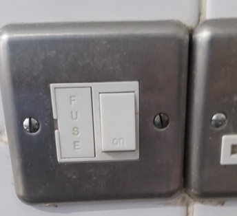

Does a new cooker extractor need a plug socket if it has a plug?

I don't want to be the pedant, but a double pole isolator is needed somewhere, but only at the origin, i.e. the main isolator. All others don't need, although usually instructions for things request double pole isolators anyway, presumably local to the appliance.
Also BS requires polarity to be correct (basically for that reason), but if it's not for some reason, then a double pole isolator is the next best thing.
Would it helped if I took a picture behind the isolator switch ?
Had a new metal fuse box + RCD put in last year too BTW.

ydrol - do you know what route the cable(s) take between these two points?
Also, that's flex coming out of the wall, so unless there's flex leaving the switch you've got a junction box hidden away somewhere.....
I've no idea but the tiles are being changed and the handyman suspects the plaster will come off with them :) I'll see if I can get a pic via phone or action cam (and try not to drop it!).
It is an old installation, what you are doing is replacing your old hood with a new kitchen hood, with minimum fuss, you are not rewiring your house, so just connect your new hood to existing terminal strip, and wrap insulation tape over it, tuck it back, and you already have a fused isolator switch, just make sure the fuse is not 13amp, as fan doesn't need much more than 3amps, so why do you want to prolong your task, or pull your tiles away and try and fit a back box, you never had one for so many years why now? would be different if you were rewiring all your house and so new and latest standards would apply, it is not like H&S is going to dream that you haven't used a back box and would come to inspect your new fan and order you to put it right to latest regs. It won't make your installation any unsafe if you didn't use a back box, long as your terminal strip is well rated for the current and all wires inserted without any strands or insulation pulled back, screws should be tight so no lose wires that can cause heating. If it was my house I would do it with minimum fuss.
The likely route for the cable would be straight up and then turn left towards hood, that is how most buried wires are done, not diagonally, but strange things do happen and many self proclaimed electricians do not follow standards. Original installation was most probably done by a self proclaimed electrician. In other words done by a kitchen fitters.
Thanks - I agree on just cutting off the plug and putting the new one in place. I just wanted to double check because the handyman said I might need a plug socket. On balance of what's been posted here, I'm happy to just cut off the new plug and join it on to the existing connector. I'm assuming having a terminal strip ( plastic connector with little screws) is fine. with plenty of insulation tape on it like you said.
Regarding the rest of the kitchen , I'm not just doing the extractor fan, I'm getting a fair bit of other work done to *hopefully* attract a good tenant towards top end of what market will bear in this area (new worktops - mitered join, new sink , hob, oven, under counter fridge & freezer and yes changing the tiles - the bottom row will likely get damaged anyway when the old worktops come off, and the cupboard under the sink is partly water damaged)
