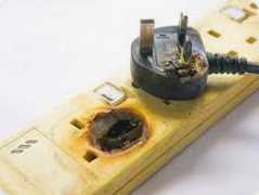

Yes, on page 1 I mentioned the problem is our horrible plugs which overheat.
...In my experience it's more common for the plugs to overheat which then burns the socket frontplate, as such I would say the good thing to do is just feel the plugs when been in use for a little while (say 10-20 minutes) to see how warm they get. If they get hot then come back here and ask for further advice.
... I guess I was just indicating the biggest issue is the presence of the fuse/the way it's fitted. Without it the connector is very likely to handle the full rated current without problems
What I'm really saying is our BS1363 plugs are not fit for purpose, especially those with fixed pins (such as MK) which can stress the socket contacts. However I have many plugs and sockets from 50's and 60's which I treasure as they are built so much better than modern ****
Our 13 amp system has been altered, with insulators on the pins, which reduce the heat transfer, but also we have non-compliant fuses, which in some cases are near impossible to see they are fake without breaking them, and also non BS1363 lumps of plastic forced into the sockets, straining the contacts, 1722689135739.pngand heavy transformers, 1722689242423.png hanging from sockets, and other abuse, 1722689323973.png is there any wonder why they fail.
It is typical to see the damage to the line pin where the fuse is, ⁣ but1722689484338.png rare that we actually look as to why. I am no angel1722689811335.png not overloaded, nothing of any size plugged in, but the bottom adaptor has no fuse, OK as there is a fuse in the plug for the extension, but we all abuse the system, then wonder why it failed.
