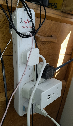

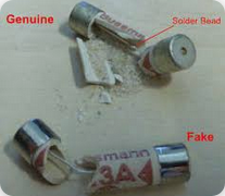

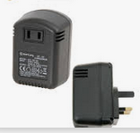

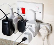

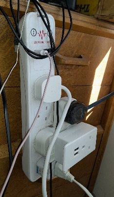

Our 13 amp system has been altered, with insulators on the pins, which reduce the heat transfer, but also we have non-compliant fuses, which in some cases are near impossible to see they are fake without breaking them, and also non BS1363 lumps of plastic forced into the sockets, straining the contacts, View attachment 351054and heavy transformers, View attachment 351055 hanging from sockets, and other abuse, View attachment 351056 is there any wonder why they fail.

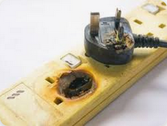

It is typical to see the damage to the line pin where the fuse is, ⁣ butView attachment 351057 rare that we actually look as to why. I am no angelView attachment 351058 not overloaded, nothing of any size plugged in, but the bottom adaptor has no fuse, OK as there is a fuse in the plug for the extension, but we all abuse the system, then wonder why it failed.
None of your pictures are different to the way other European countries plethora of sockets are mistreated, in fact I'll go further and say they tend to use far more multiway and interseries adapter than us and they don't seem to have the heating we do.

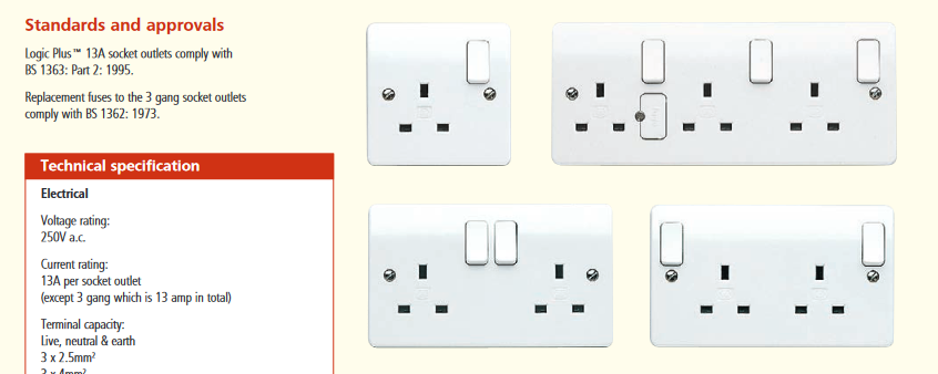

Indeed it is, hence all the discussion/arguments. The specs are frequently ambiguous, particularly in that they often refer to 'socket outlets' without explicitly defining what that means. Common sense seems to suggest that a double socket has two 'outlets', in which case, for example, MK's spec of "13 A per socket outlet" presumably means 26A total - a view which seems to be reinforced by the fact that they go on to add "except for triple sockets, for which the rating is 13A total)".
However, for a start, a double socket which could only safely (in terms of temp rise) carry 13A total would not even pass the BS1363 temp-rise test - and, indeed, any double socket which passed that test (which it has to do to be BS1363-compliant) would be able to carry at least 20A total.
But there is nothing to stop manufacturers marking as 13A max

True, but I think the 'autopsy evidence' usually suggests that the problem is commonly the connection between the fuse and its holder- particularly those cases in which that connection is achieved by 'jamming' the fuse into a hole in a bit of brass, rather than having a 'sprung' connection.
I'd say the sprung clip is the bigger problem as it goes through multiple heating and cooling cycles. There is a term for it; annealing.

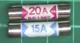

Without smashing open, could you work out which is fake? Some we can see as fake, ⁣
but although we know you can't get a BS1362 fuse at 15 or 20 amp, would the man in the street know?

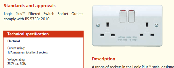

The filter sockets, and other specials are quite often rated at 13 amp for the pair,
They seem to be, but (as you illustrate) that's not the case with the ordinary MK sockets.
However, that does indicate that MK DO write "13A total for two sockets" when that is what they actually mean, which strongly suggests (at least, to me) that their "13A per socket outlet" means 26A total for a double socket
View attachment 351061 Without smashing open, could you work out which is fake? Some we can see as fake, ⁣ View attachment 351062but although we know you can't get a BS1362 fuse at 15 or 20 amp, would the man in the street know?
Now going back a long way there was a well known fuse manufacturer who did make fuses which conformed in every respect to the BS1362 standard except they made up to a higher rating, I feel16A although being so far back I'd not make it a statement.

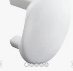

While the half-insulation may "reduce the heat transfer", I do not believe that any such reduction would be "significant".
The pins on a BS 1363 plug are 4 mm (0.16") thick and 6.35 mm (0.25") wide.
[In comparison, Australian plugs have pins of 1.6 mm (0.06") in (total) thickness - and are also 6.35 mm (0.25") wide.
The "half insulation" reduces the thickness of the "metal component" in each shank to about 1 mm, a 0.6 mm reduction.]
If the thickness of the half-insulation on a BS 1363 plug is similar in thickness, there would still be 3.4 mm thickness of metal - 85 %
