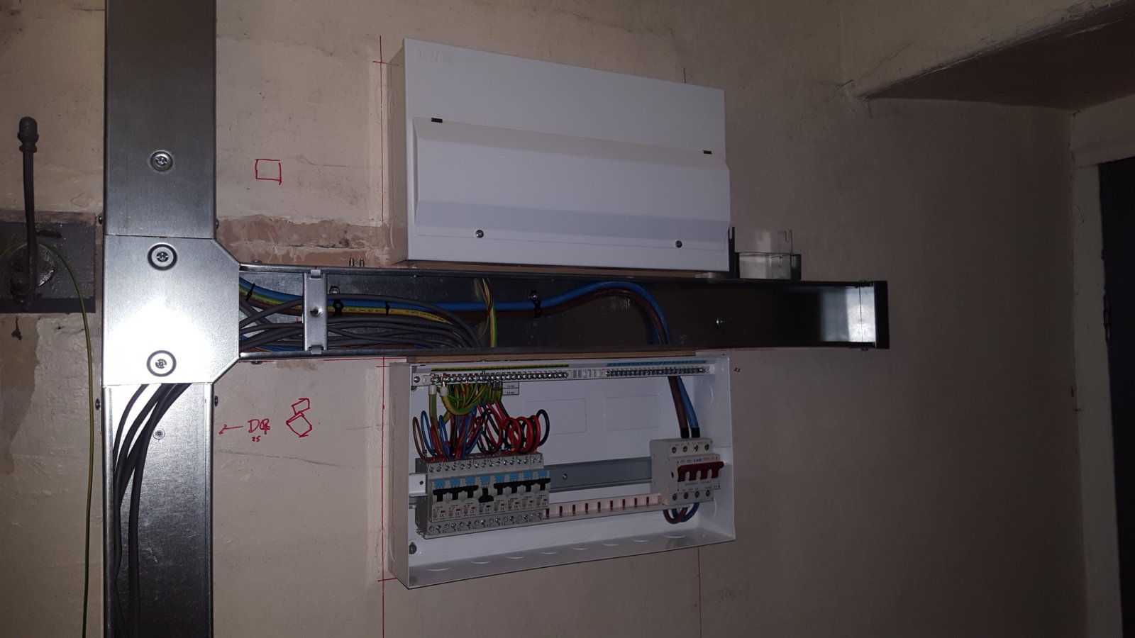

SBS trade Sales (other makes & suppliers are available) do compact RCBOs which use a neutral bus bar rather than flying leads - so a much neater board. Also SPSN, and the range is switching to type A sensing so suitable for pulsing DC loads.
If you want an MCB only circuit, he has half-width MCBs and a connector for the neutral cable to the bus bar.
Neutral bus bar for RCBs. Sounds neat. Sounds so obvious.
Yes it's neat, yes it's obvious :whistle: And several (smaller) manufacturers do them.
But from the PoV of most manufacturers, they have an investment (both in tooling for what they sell, and installed base they need to support) in single bus-bar CUs. Basically there's zero compatibility between "traditional" CUs and dual-bus-bar CUs like the SBS ones so to introduce these dual-bus-bar devices means a new range of CUs, with all the tooling, stocking, distribution, and marketing costs - all while trying to persuade the industry that flying neutral leads are a PITA.
Being small is definitely an advantage. SBS will do you a custom arrangement - so if you want a few MCB ways, you have the option of custom bus-bars with a few ways that only fit single pole MCBs while the rest of the board takes the double pole devices. Or you can use the 1/2 pole MCBs which he only has in a limited range of ratings.
If you look carefully here, you can see the ends of the bars - the tabs are bend at 90˚ so that the bars sit flat along the bottom of the devices, one behind the other.
