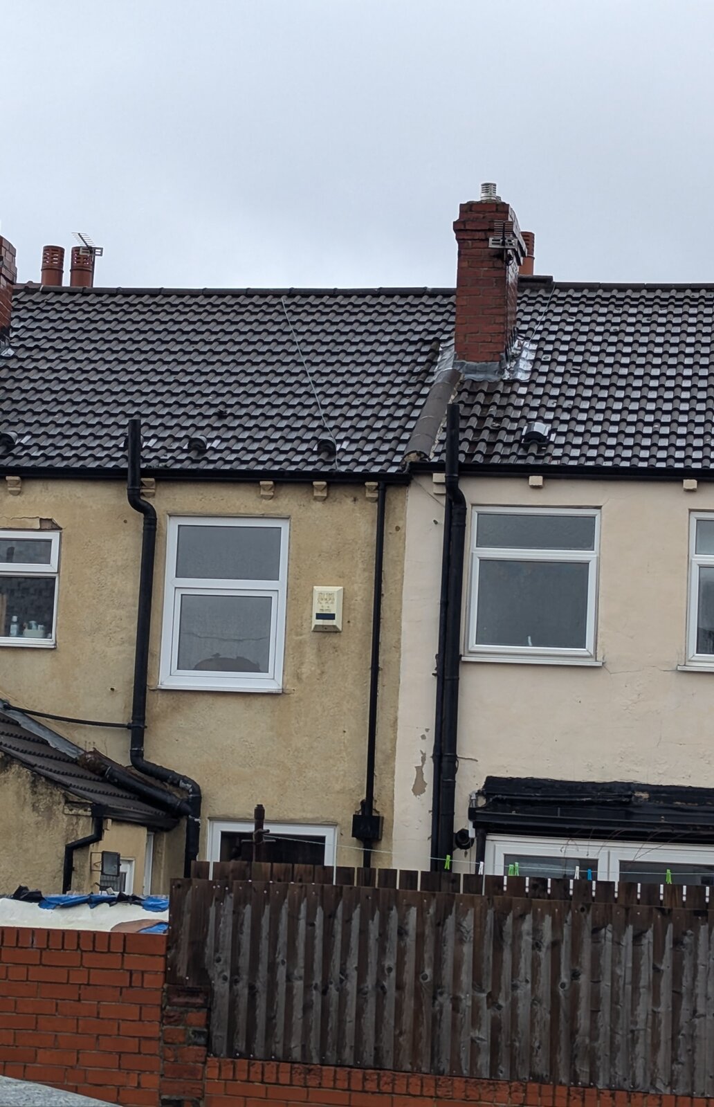

As requested earlier - Can you draw a diagram, looking from above, showing where the damp is, in relation to the chimney, and post it please?

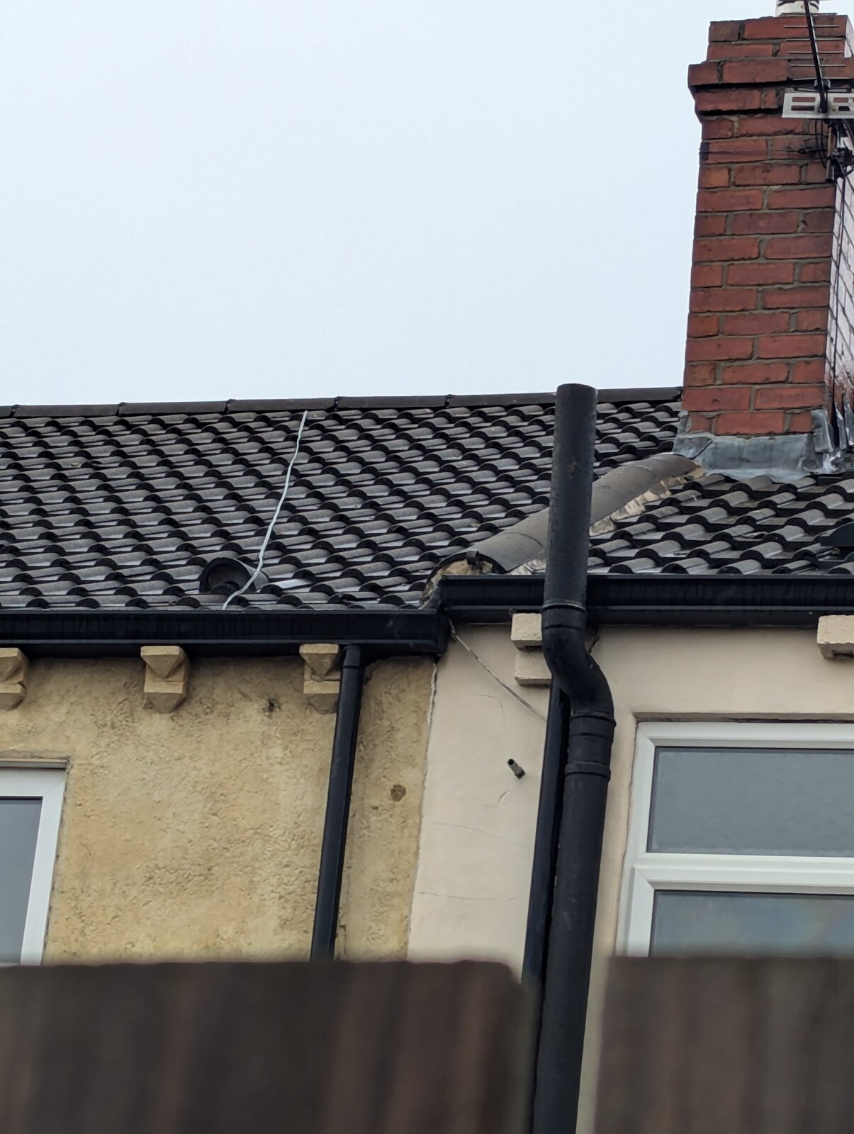

As said, a roof leak would first show up on the walls of the upper floor. It is not a roof leak. It could be water running down the inside of the chimney, unlikely, but we don't know where the chimney breast is, in relation to the damp - hence the request for a diagram.

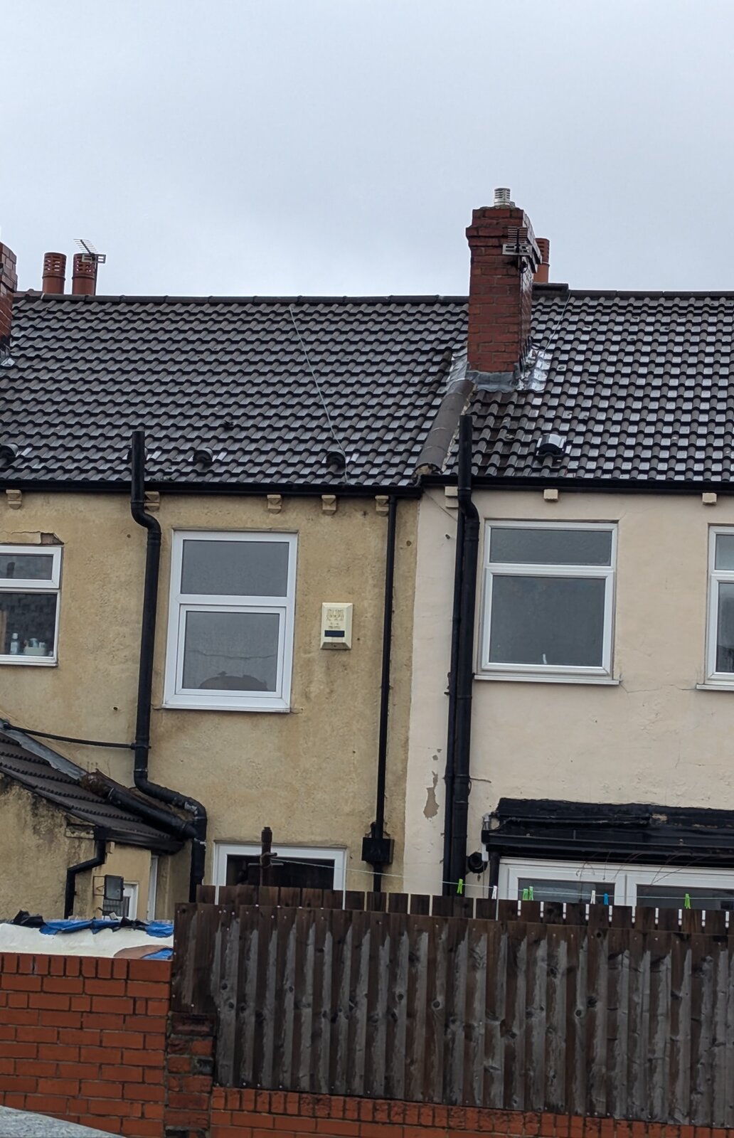

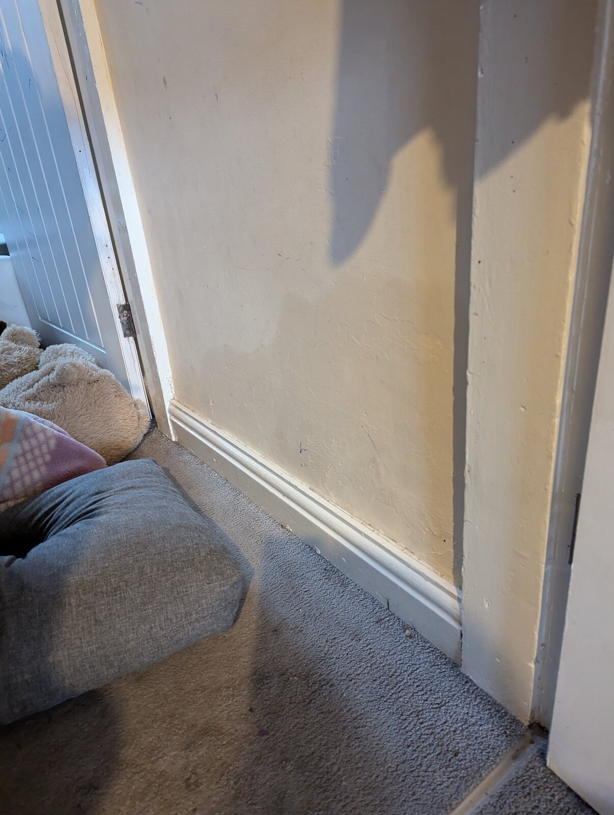

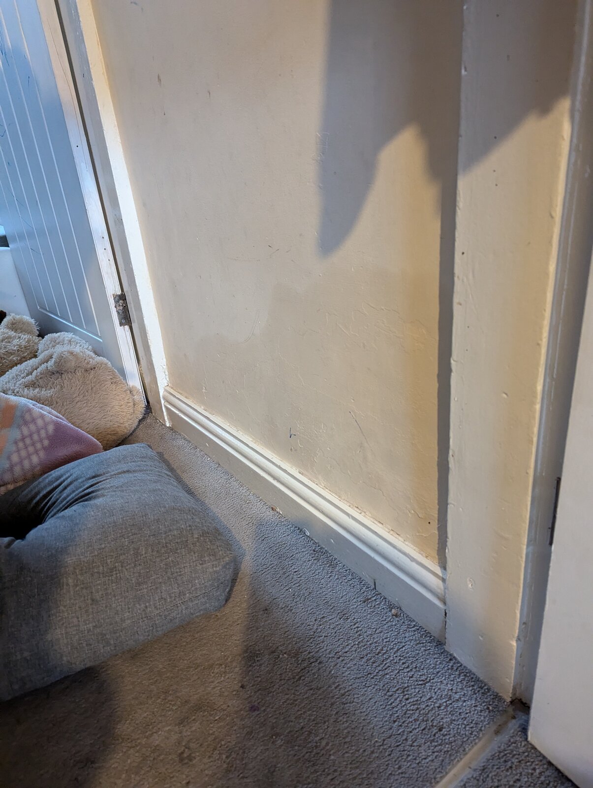

I have attached a photo I would say the chimney is central to the wall in question. My house is the bright yellow one. Thanks

I understand the damp is on the party wall, and not on the external walls.
Please stand back and take a wider pic of the entire wall, floor to ceiling and end to end.
Also of that party wall in the other room(s)
And draw us a floor plan please showing the position of the damp, the chimney breast, the kitchen and internal stopcock

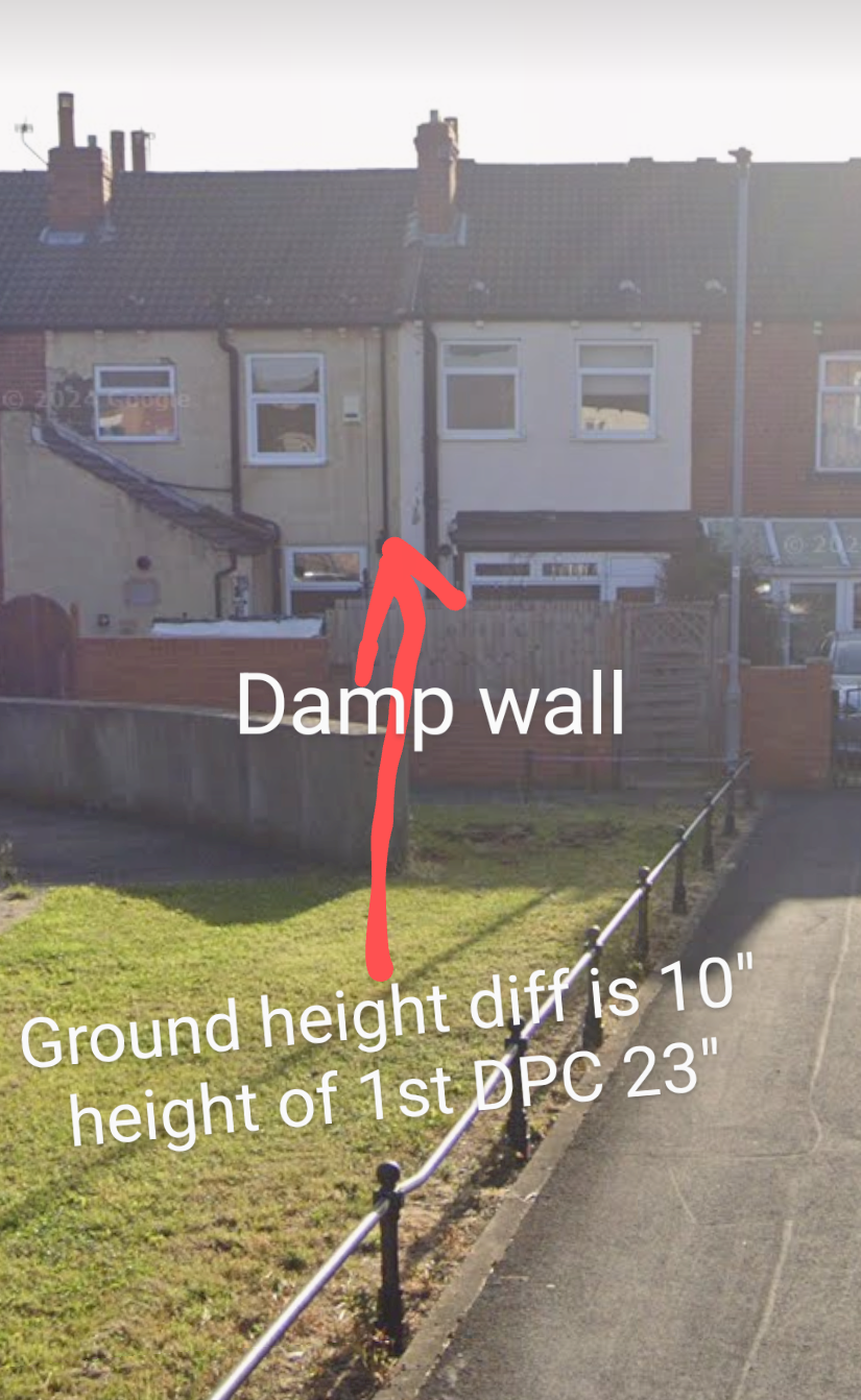

Is yours the house with the burglar alarm?
Where is your bathroom?
Sorry, I wonder if you could clarify something for me?
Is your house on the right, or left of the photo?
You said most of the damp was around the chimney area, but also that your neighbours house was higher, whereas if the photo is showing your chimney, your house is the higher one! :)

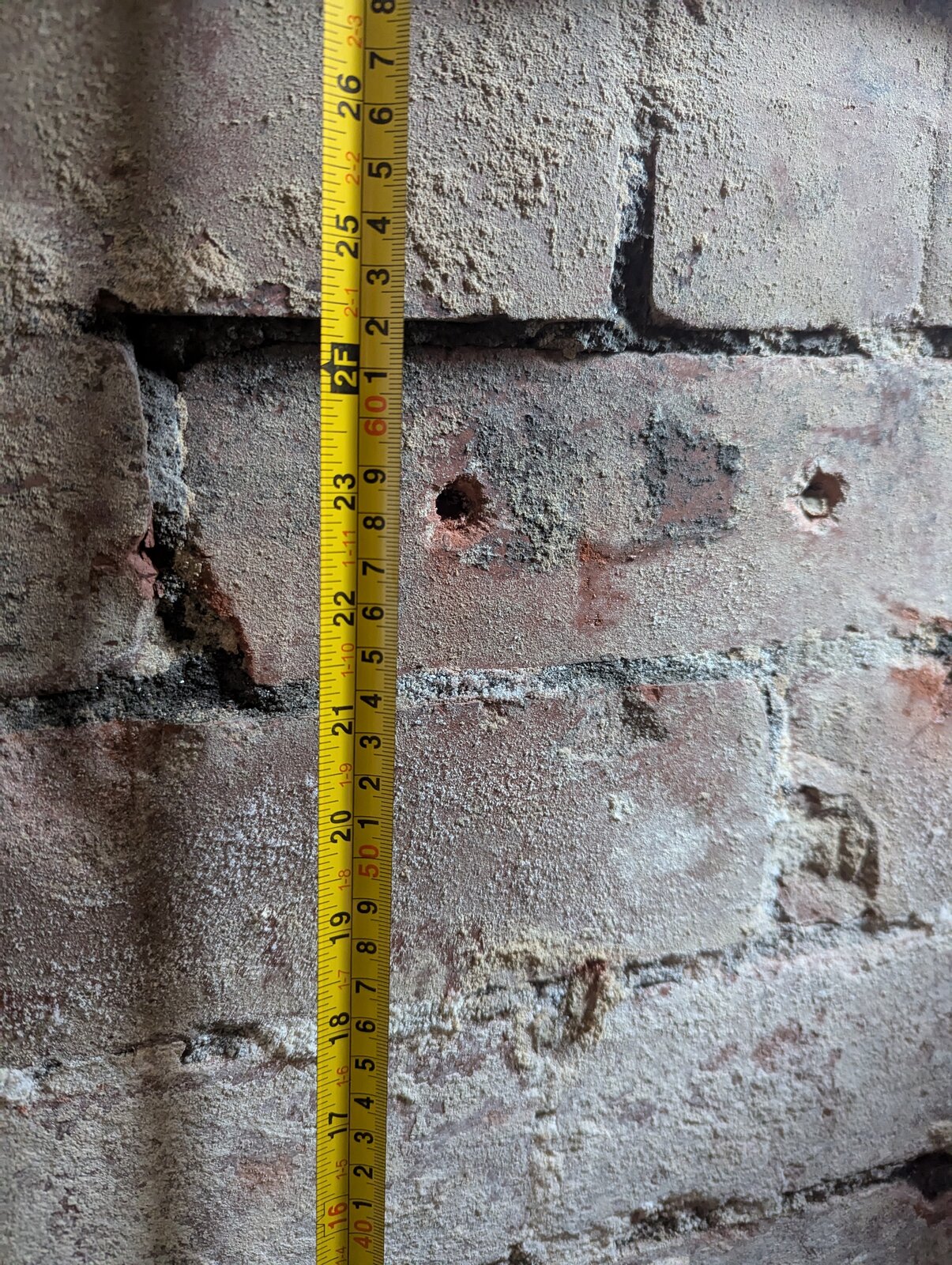

Sorry just left the house but managed to measure the difference in ground level from the outside with the neighbours property. So the neighbours outside ground level seems to be 10" higher than mine I'm assuming that's why the damp course in mine has been positioned where it has. My damp course starts at 23" from my ground level.

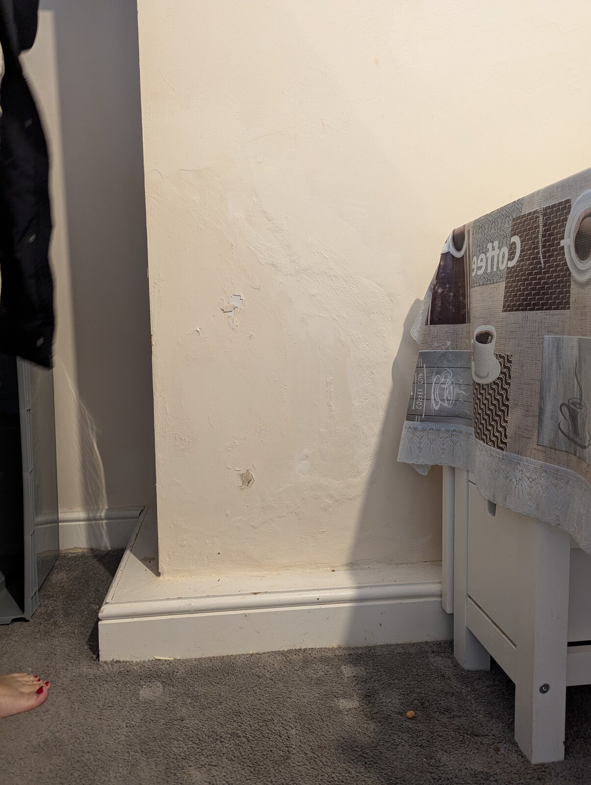

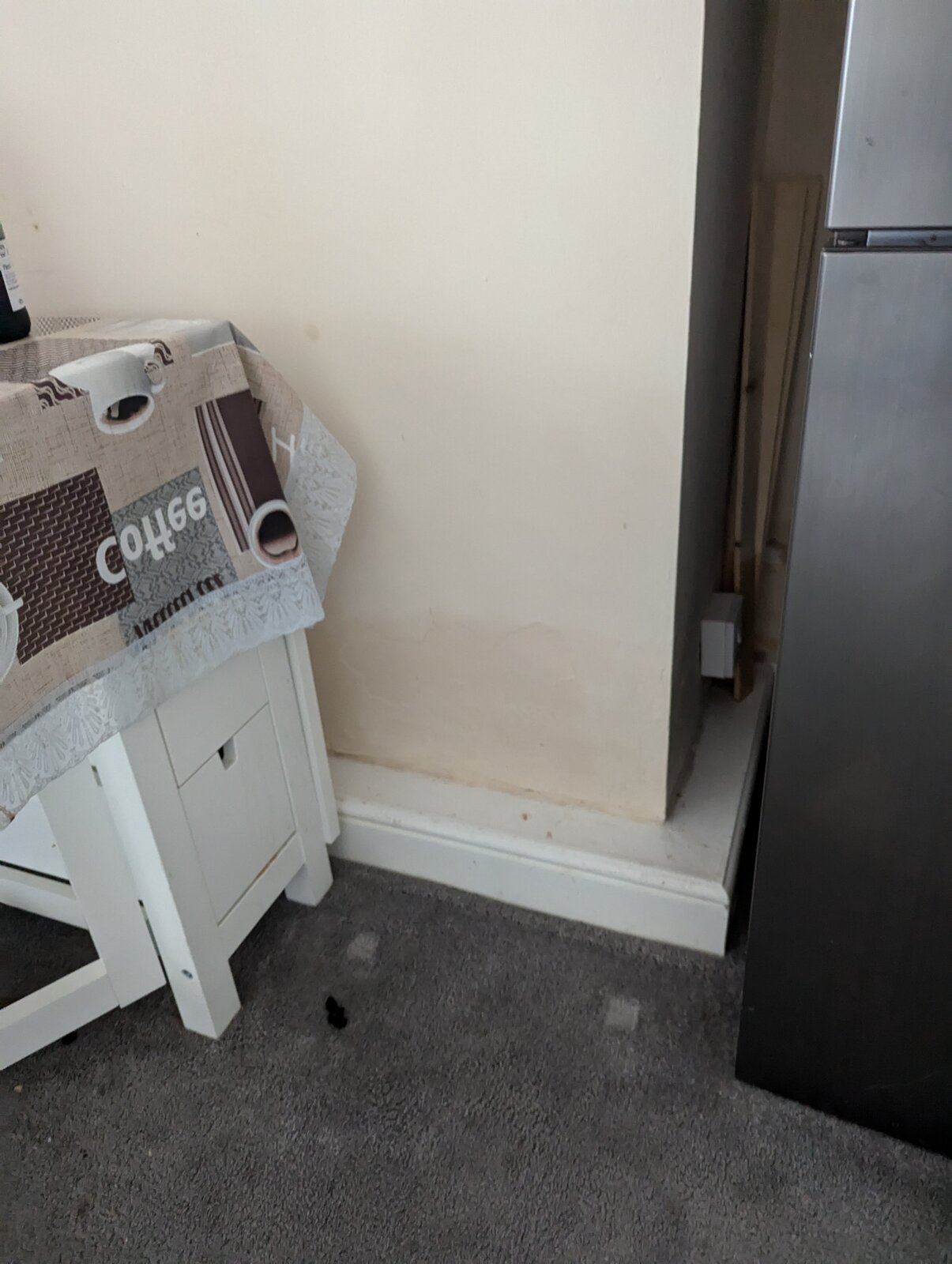

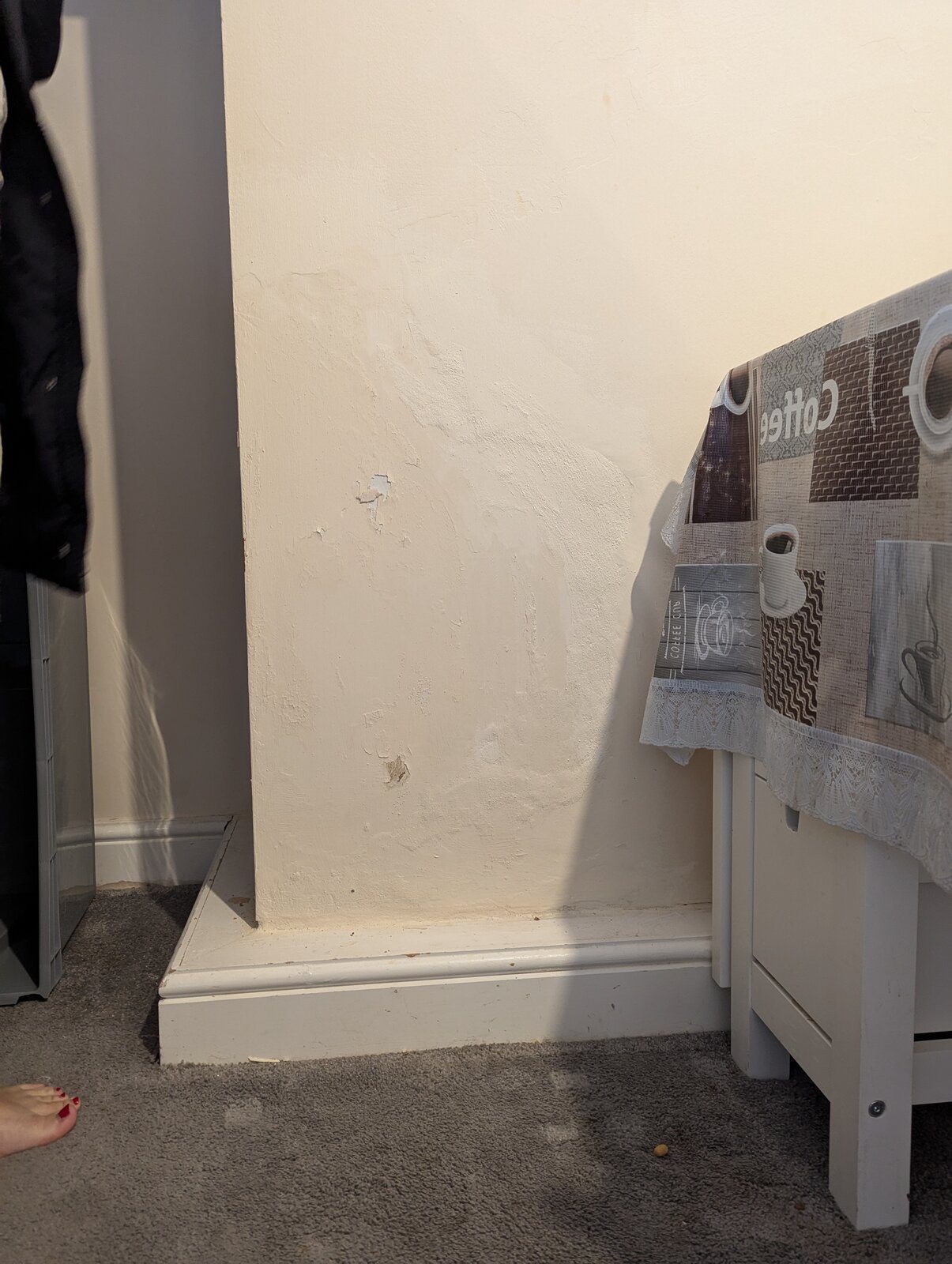

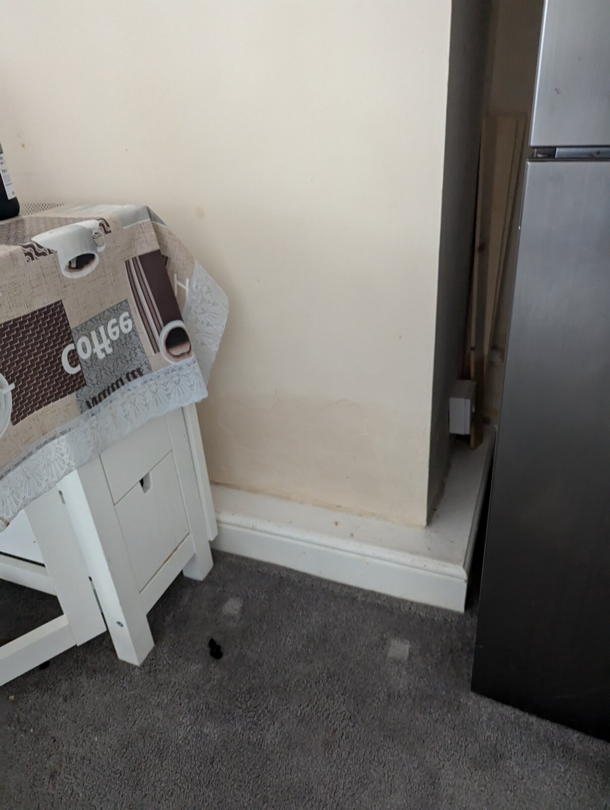

I have attached a photo of the outside of the house. I have also been able to enter the neighbours property and take a couple of photos of the party wall chimney from their side. The tenant has informed me her landlord is selling and wow I'm not surprised 6 kids the house was trashed and kids had drawn all over radiator, walls and doors! Photos of their chimney shows damp and also on the opposite side of their house which isn't a party wall with mine but has rising damp on it. The dining table was in the way so hard to see much and I didn't dare ask for it to be moved as the house was full of Polish people having a party and the lady was hesitant to let me in!

Under the warranty, it appears you have two options for a claim - one that the injected work has failed, but also (and more relevant) that the damp prevention/eradication treatment has not worked.
So, I would suggest that the work originally specified and done was not successful - ie they should have lined the wall in addition to the injection. This is more relevant if the neighbouring house is at a higher level, but even if not that section of wall between the floor and the injection is susceptible to dampness.
If you are not able to argue your case, then best get a competent building surveyor or independent specialist damp surveyor to report and argue your case.
www.property-care.org/
Initially tell the firm you don't agree with their response, and tell them that if you get an independent report and it finds in your favour and the work is covered by warranty then you expect/require the costs of that report to be reimbursed.
If you believe the cause eminates from next door, or that treatment is required next door to protect your property, then get in touch with your council who will have powers to get access and if necessary enforce the neighbours to carry out any necessary works. Environmental Protection Dept - EPA 1980.

Hi Harry, my house is the left hand side house on the photo. The house to the right is a fraction higher.
