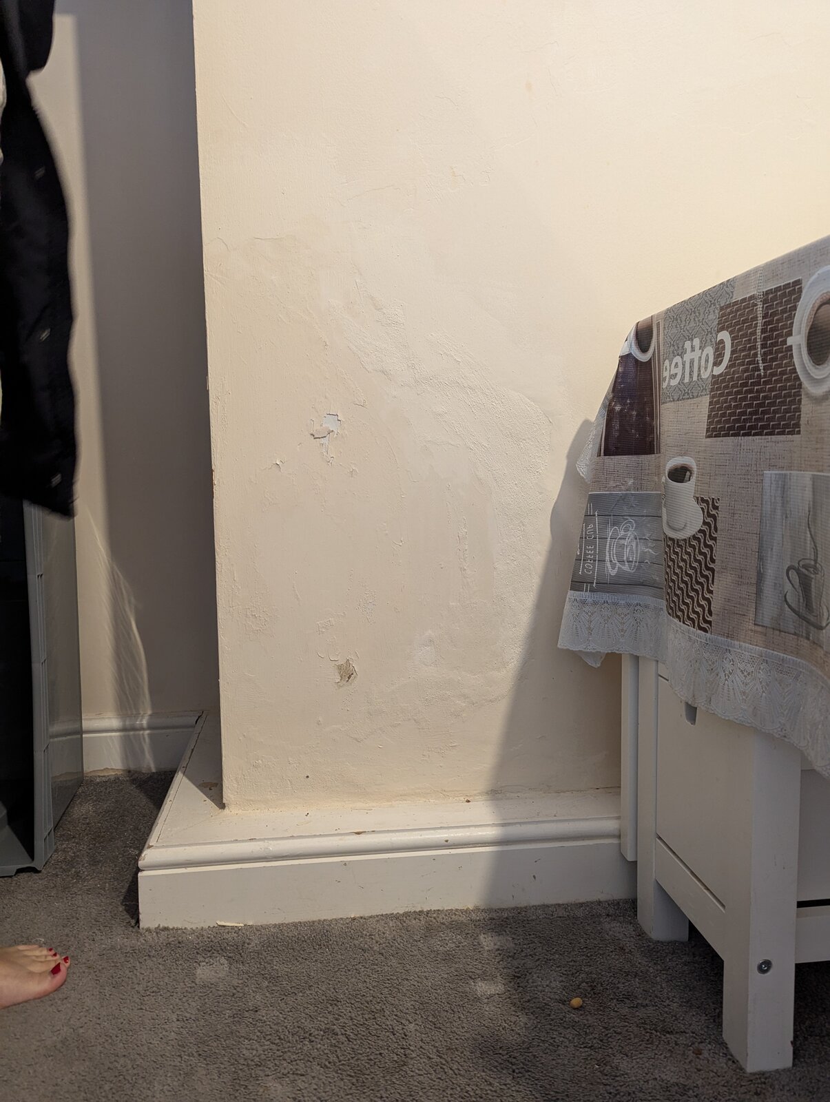

I have no idea about walls I'm just going of my EPC which says the property is solid walls with no cavity.
Your outside walls might have no cavity, but the party wall may have one. Normally, a 9" wall, would have a few bricks laid end on, so they tie the two leaves of the wall together. A cavity wall would have wall ties, tieing across the cavity gap, so no end-on bricks visible. A single brick wall would look exactly the same.
That surprises me

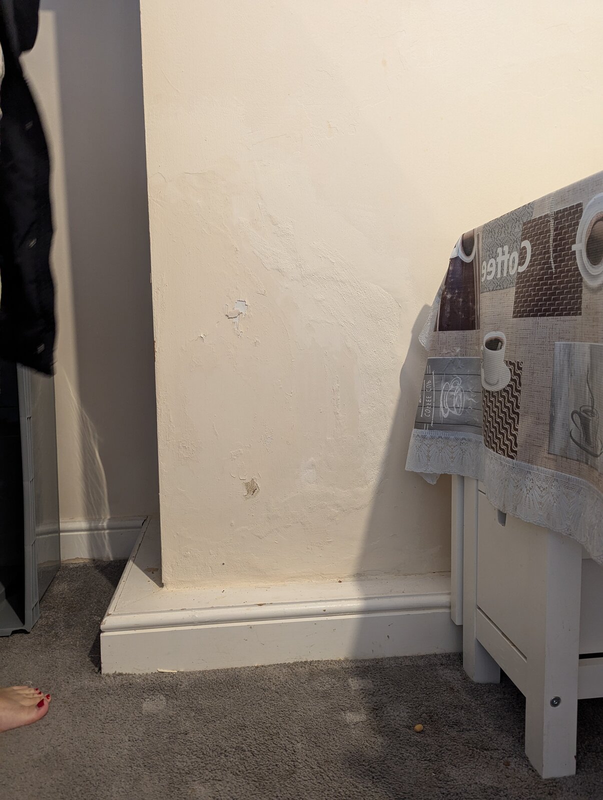

Though I can't see the damp patch in that pic. Has it dried out since you took the plaster off?
How old is the house?
Do you have a fireplace on the party wall?

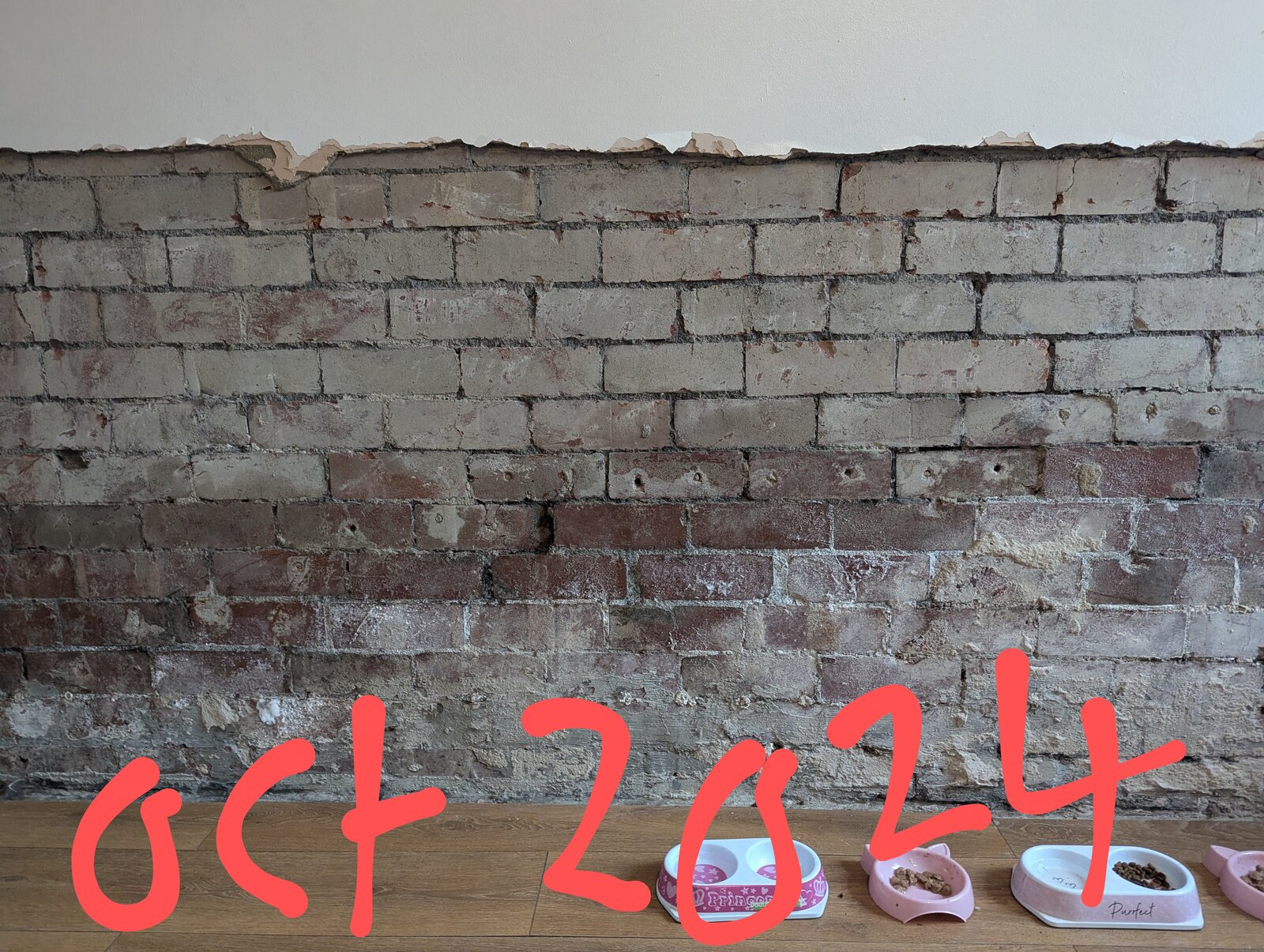

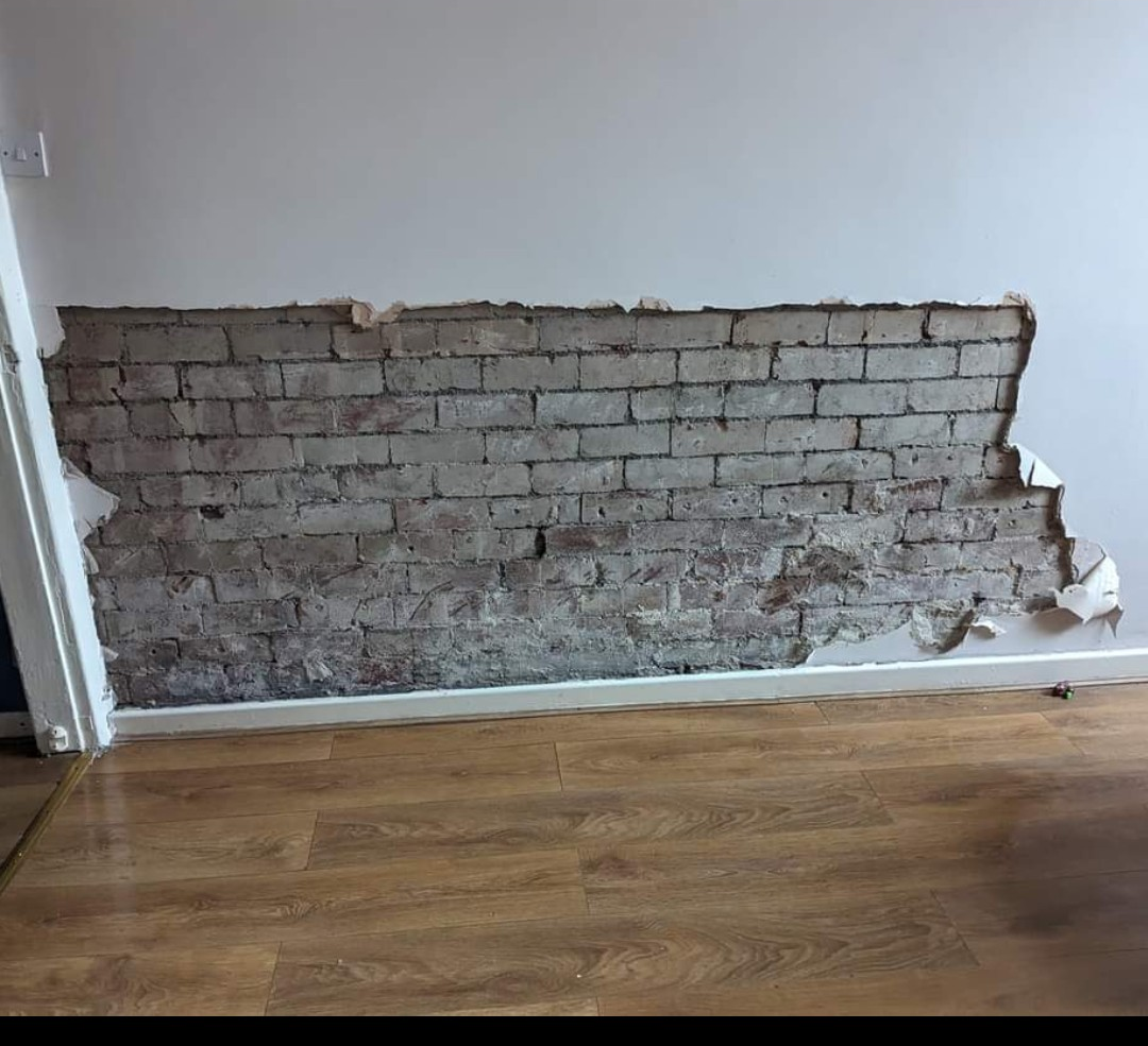

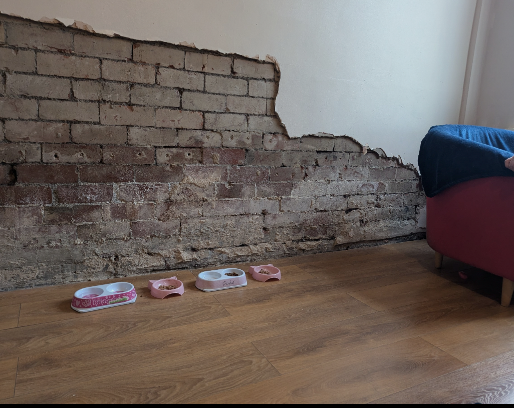

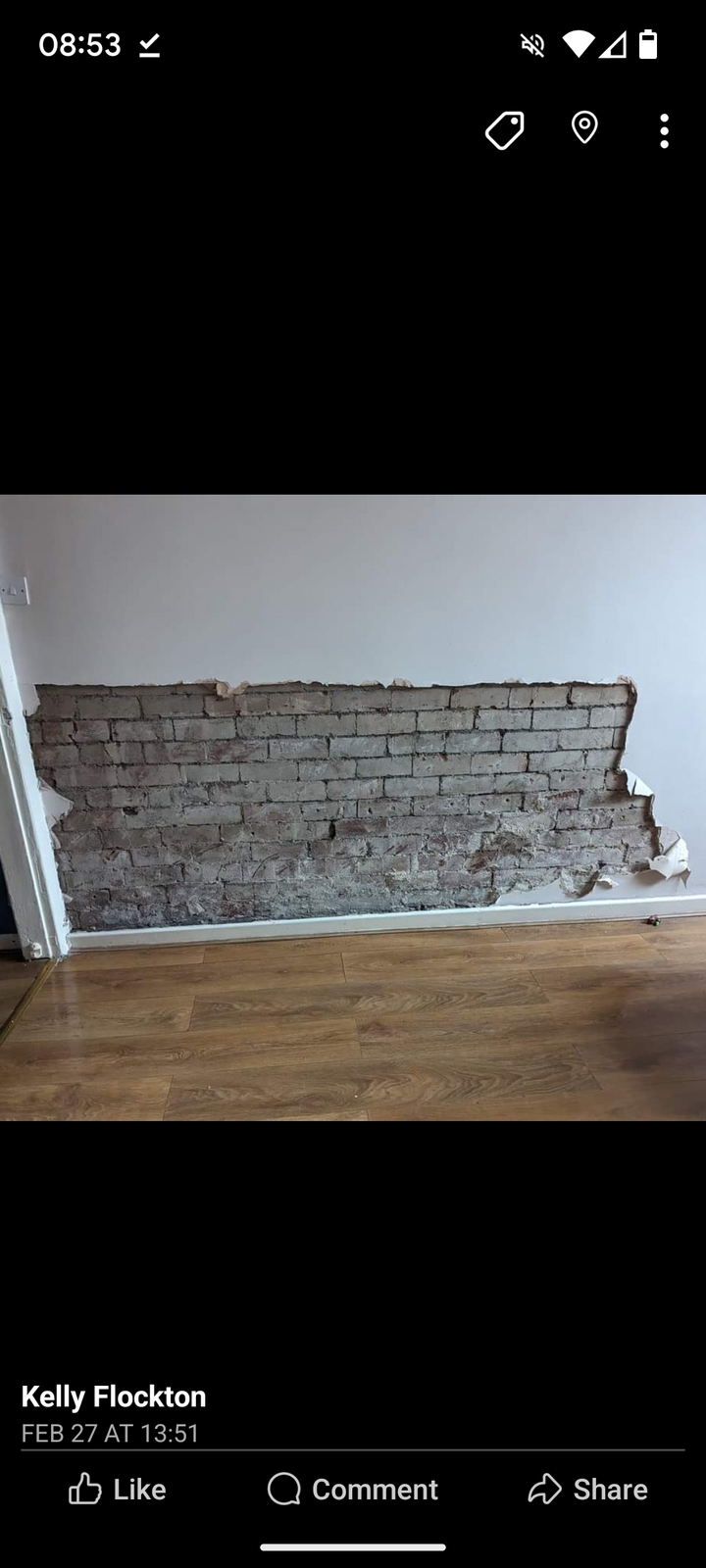

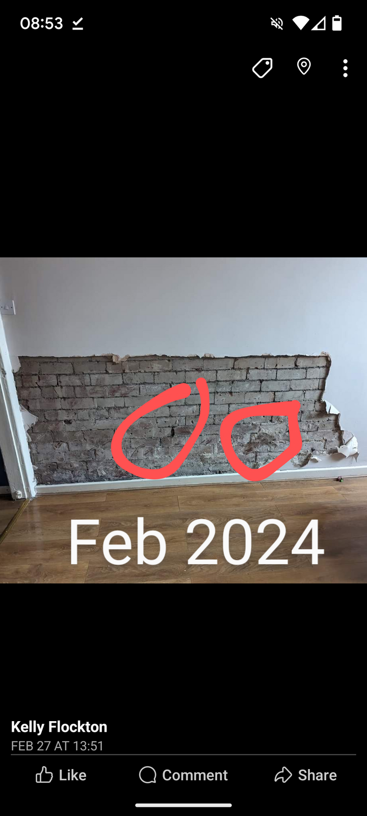

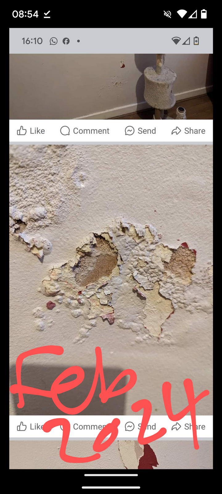

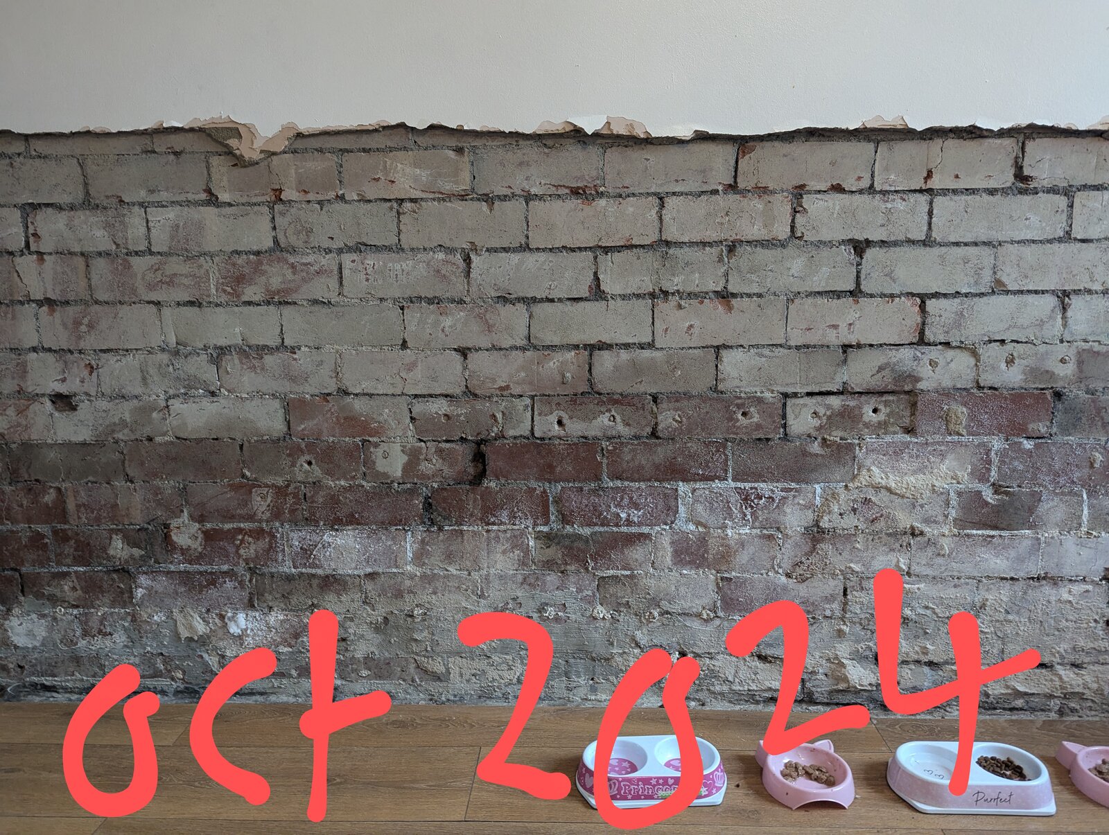

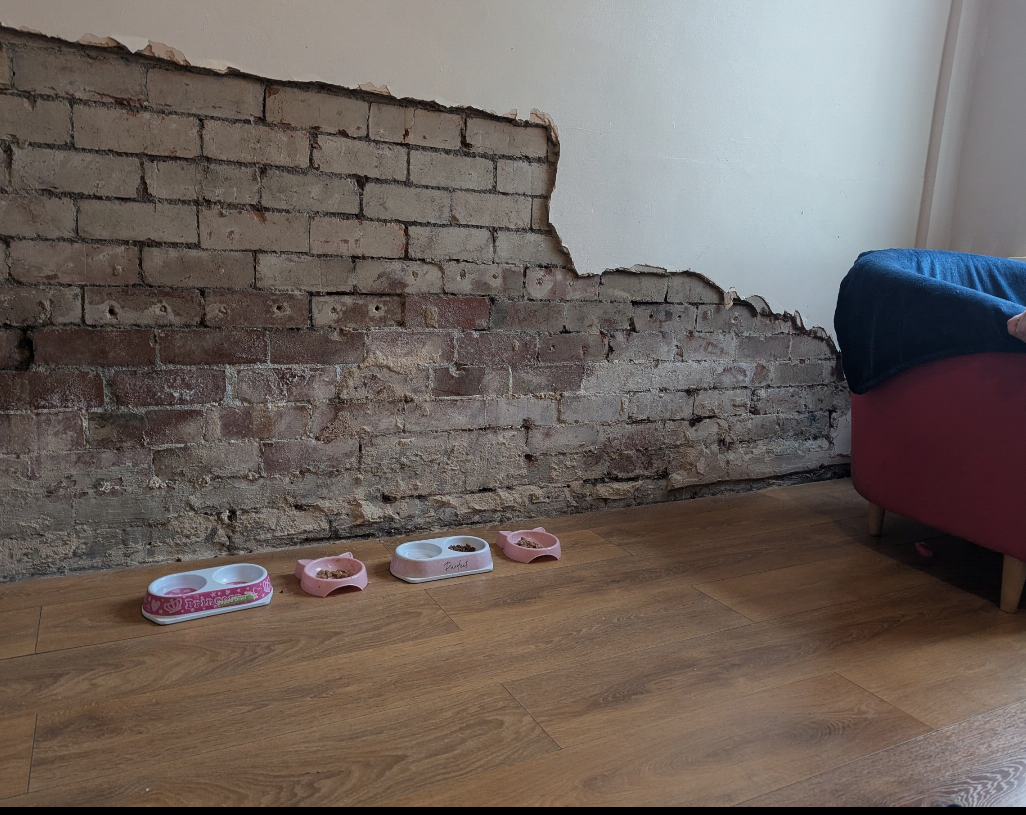

Anyways I removed the plaster of the walls and have been letting it dry out since
The photos below are ones I took yesterday and the dampness has got worse and not better that's after it drying out all summer we've had hardly any rain.

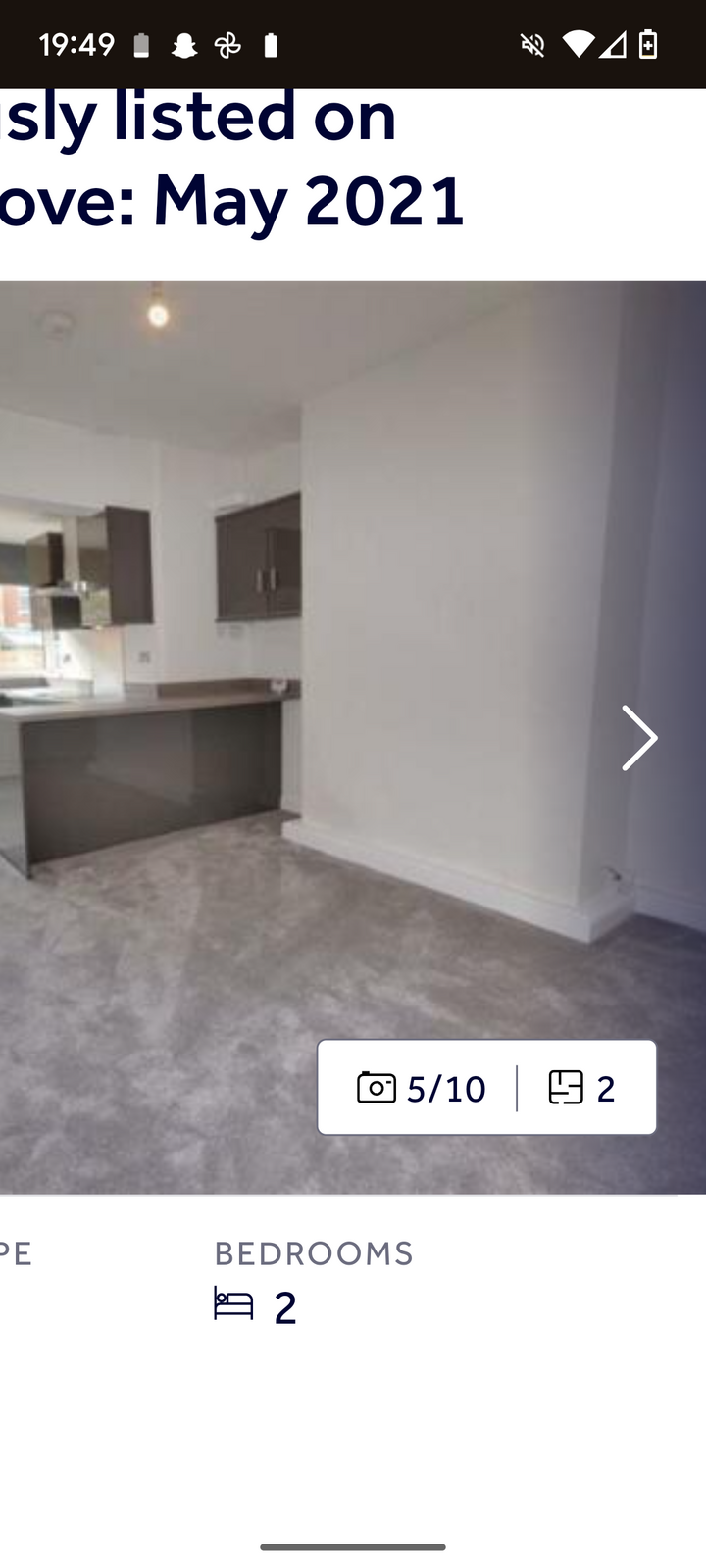

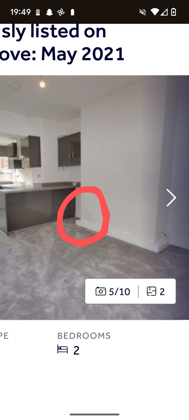

(Hopefully without being accused of cyber stalking), A Rightmove search brought up a 2021 listing for the next door property - the photos show a recent refurb, with no signs of damp, but every fireplace has been bricked up without ventilation.

I still haven't seen a pic of the entire wall, end to end and floor to ceiling. It would be interesting to see how the damp patch corresponds to the dimensions of the neighbour's chimneybreast.
The patch stripped of plaster is about 8 feet wide.
It would be useful to know if the floor is concrete.
I have just looked at the Rightmove photos!https://www.rightmove.co.uk/house-p...310ecd388af92ff7fd64d36ffaf4a0a5dadce3ef33d#/

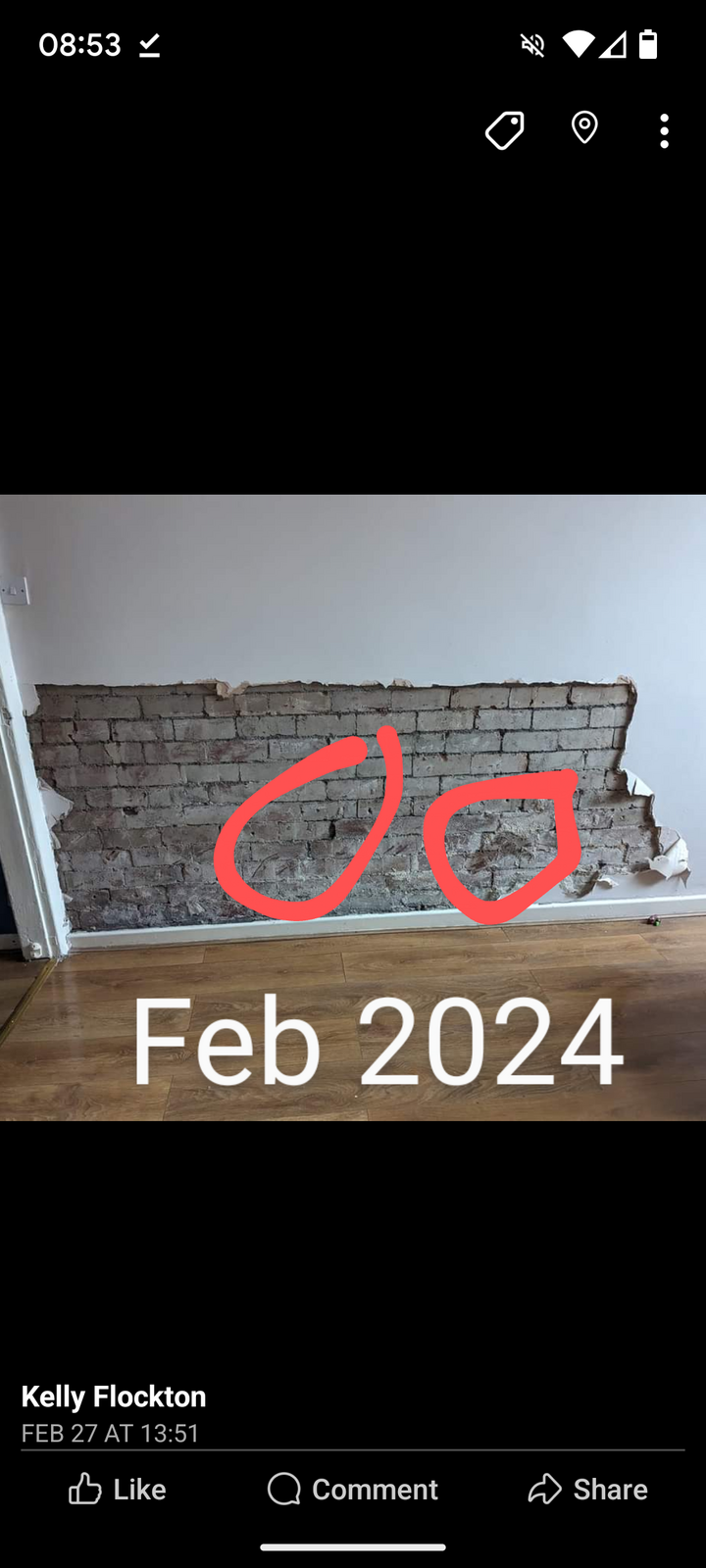

Never seen them before. The house definitely didn't look like that today I have screen shotted the photo of the damp room and if you zoom in theres definitely a patch in the exact same place where I took photos of the damp today in the neighbours property. It looks like it was already there in 2021 when they house was sold.ill post both pics. Thanks

If I was to guess that water is getting into the chimney, and collecting in rubble thrown into the bricked-up fireplace, which does not dry out because it is unventilated, and soaking into the wall and into the floor which is concrete, I would be willing to put a small wager on it.
I would want to look at the whole wall to see how far the damp spreads, and in what shape.
None of those faults would be corrected by silicone injections or replastering.

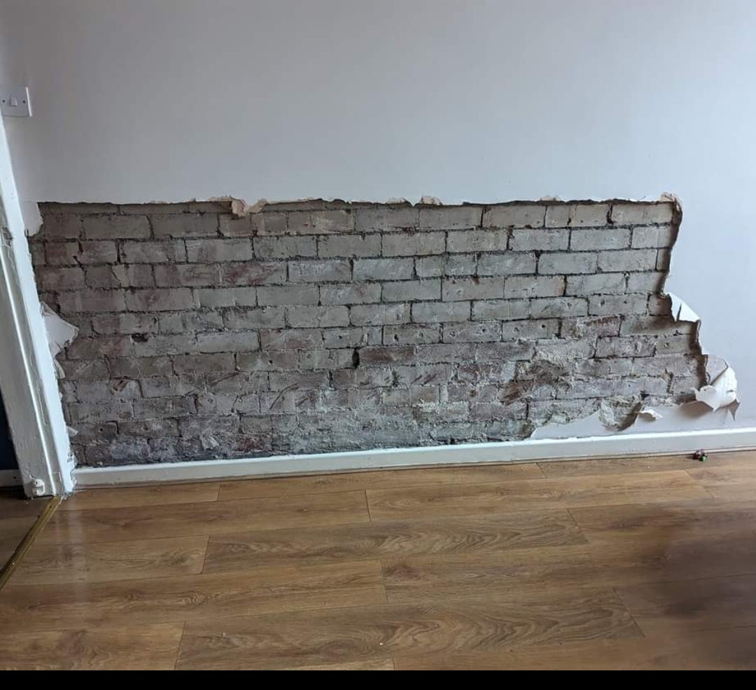

That's the whole wall in the photos below John
The door frame is at the left hand side of the right hand photo and you can see the corner of the room behind that chair. So the right hand side photo leads into the hall way where some more damp has appeared at the very bottom of the wall. It's covered by thick blue wallpaper so isn't showing up to well but I presume in a year it will be like this. It only goes about a foot into the hallway so far.

Ideally all needs stripping and properly tanking before a coat of waterproof render and skim. Good luck with finding someone to do that, it's incredibly simple but people seem to be incapable of the basic attention to detail to do it properly. You need to check the wall/floor junction as the tanking may need extending across the floor a bit.

I expect the chimneybreast is about 4 feet wide. Can you mark its position on your wall please. Is there any corresponding pattern in the damp?
Is the floor concrete?
What height is the damp in the other room?
Where is the sink?
