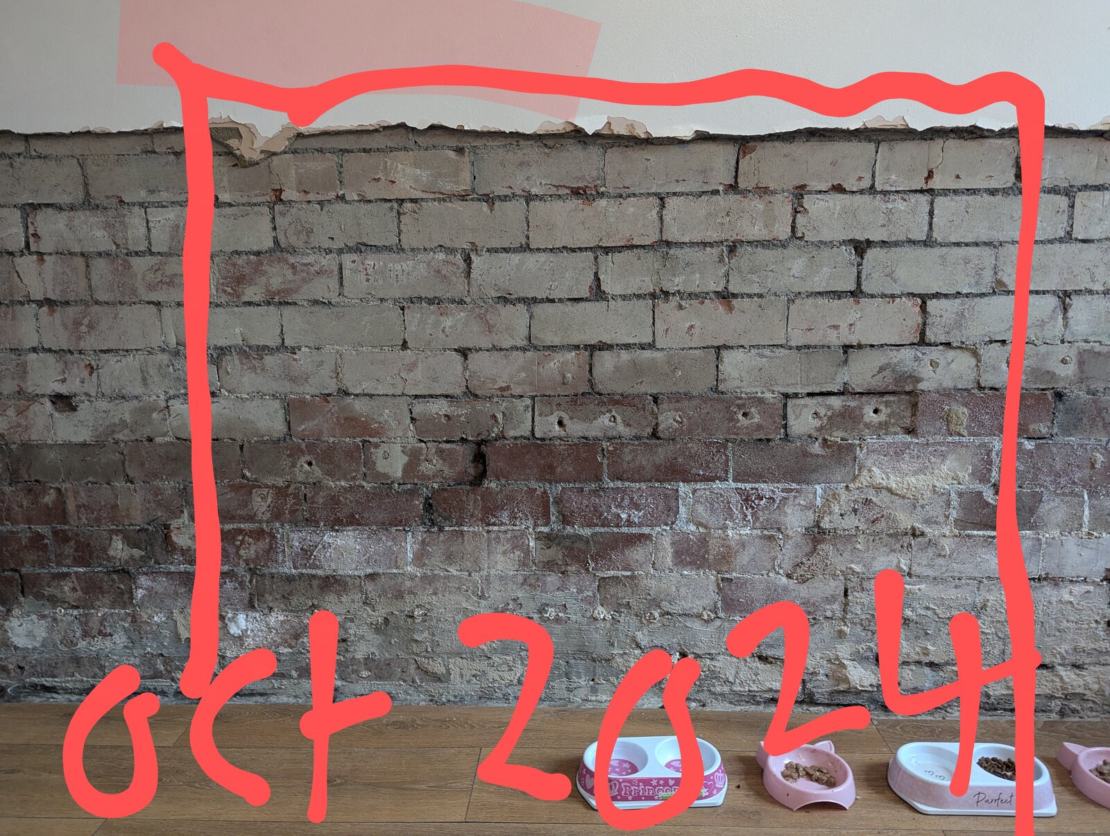

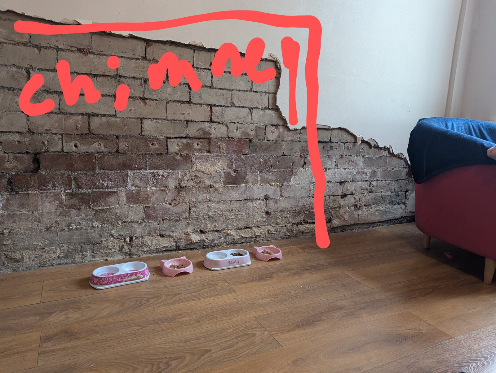

I think I'm going to email the letting company for next door and ask them to put some vents into the chimney breast as lots of comments on here regarding this! Then either do what you have suggested or membrane the wall. I was hoping the wall was going to dry out before I had it re -plastered that why I have left it over the summer months. I explained that to the tenant and luckily it is the dining room which she doesn't really use she doesn't seem too fussed but I think she's definitely ready for it to be re- plastered now. I don't think I would be on telly as I'm trying to sort the problem out not cover it up and it's been a lot of trial and error and eliminating different things. I know I could just cover it with plastic membrane and re plaster but I actually wanted to get to the root of the problem without just covering it up. The tenant also has two lovely indoor cats that have been a nightmare weeing and mark making on the floors so I don't think she can really complain as there aren't many landlords that wouldn't loose their patience with the tenant over those kinds of things.

I expect the chimneybreast is about 4 feet wide. Can you mark its position on your wall please. Is there any corresponding pattern in the damp?
Is the floor concrete?
What height is the damp in the other room?
Where is the sink?
It looks like the damp is in a horizontal line to me when I look at the photos.
The floor is concrete and I had laminate put down around 5 years ago it was bone dry. I've felt the floor today and it still feels dry I've only been able to feel where the skirting board would have been sitting then a gap of about 2-3 cm but all felt dry to touch.
My bathroom sink isn't above that side of the room. The kitchen sink is in the small extension a few metres away.
The height in the other room do you mean the hall way which leads directly on from this wall ? Is at ground level like straight above the small skirting. If you mean the neighbours there's is from the ground going up a couple of feet. Photos of where I believe the chimney is.

The wet patch seems to extend beyond the chimneybreast, especially to the left.
But the drilled holes seem not to. Perhaps they indicate where it was wettest when the injection was done.
If the water source is in your neighbours house, it is likely to have made their concrete floor damp, and this will carry damp along the bottom of their wall.
Usually it would spread, but I do not have experience of a height difference.
I think you mean the kitchen sink is on the other side of the house?
Is the neighbours bathroom or kitchen near the wet patch?
all walls are covered in damp to about 1m high

The chimneys appear to be unused, so they need to have ventilated caps fitting, to allow air flow up from the bottom, plus vents in the breasts. I would also suggest, that the base of the chimney breast needs checking, for build up of debris from the chimney. Who ever cut corners, simply plaster-boarding over the breast, may well have just boarded over a mess of debris in the chimney.

If it was mine I'd remove brickwork from my side allowing you to see inside their chimney to identify if there is any sort of venting or build up of rubble and go from there.
That was my thinking too, but I was hesitant to post it, given that the OP might be trespassing into the property next door, in doing that. Given the problem, it would be reasonable to ask for permission. The other problem is, we cannot be sure if this is a single, or cavity wall.
