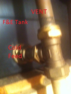

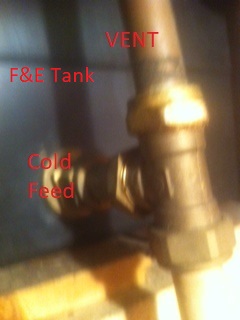

Hi John On your photo of combined vent and feed. Presume connection into tank is 15mm Vent pipe is 22mm. Is the pipe going to the pump 15mm?
The mains water to the F&E tank ballcock makeup is 15MM, with isolation valve.
The combined vent and cold feed are exactly as shown, both are 22mm.
My pump pumps into the boiler return, the boiler flowpipe goes all the way up past the F&E tank and is bent over the top of the tank (the vent), all the rads (and HW cylinder coil) are teed off this flowpipe.After passing through the rads etc the water returns to the pump suction and is again pumped through the boiler etc.
In your set up, you would cut the cold feed next to the vent on the main flowpipe to your pump and blank the stub, you would then connect in the cold feed to the existing vent as close to the F&E tank as is feasible.
John many thanks yet again for your invaluable support. So in my set up I can leave the vent pipe arrangement exactly as it is now. Do I tee the flow pipe with 15mm or 22 mm pipe. It would be approximately 200 mm long at ceiling level
Yes, vent pipe as is. It would be better to use the same diameter length of feed pipe as the vent pipe diameter. You could install a manual lever valve vent on that stub, might be handy for venting when refilling system.

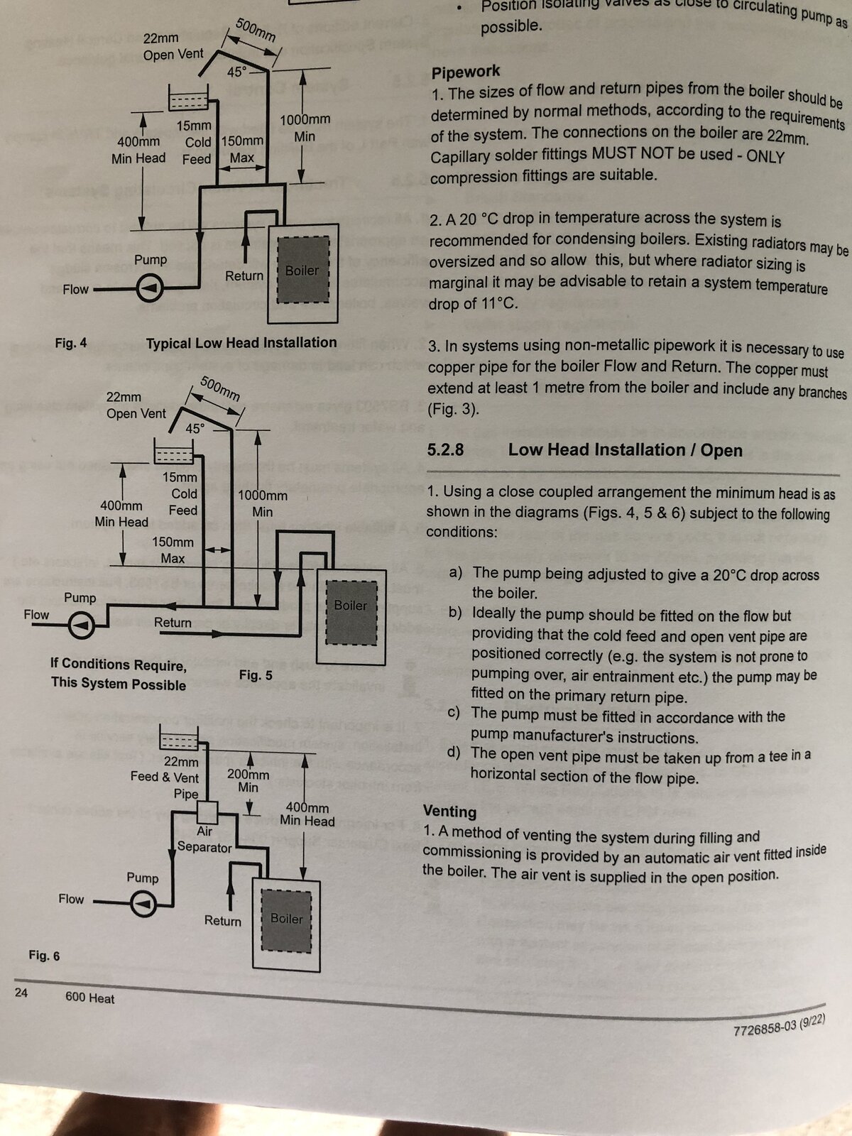

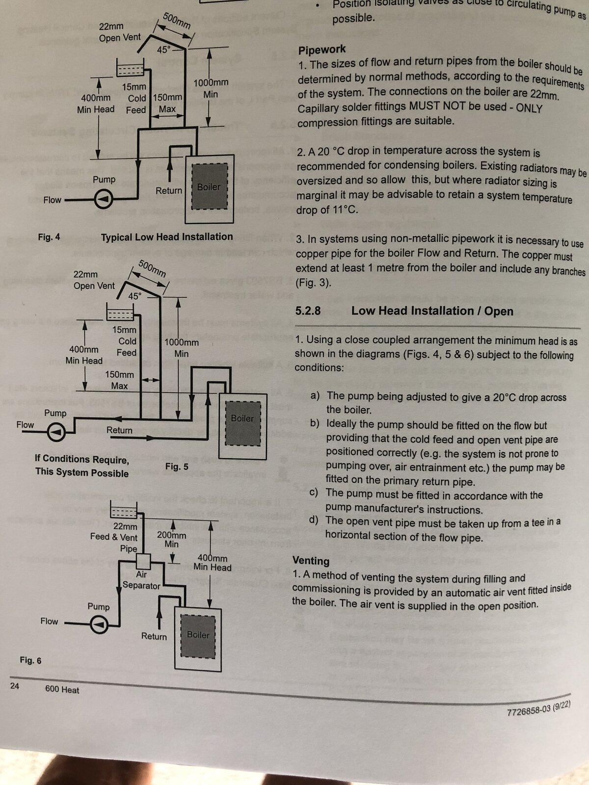

Attached is the page from Baxi manual showing 3 potential arrangements for pipe work. Any thoughts on their air separator recommendation for combined feed and vent.
The bottom one looks promising but at the end of the day my system has worked perfectly well for over 50 years so is "tried & trusted".
Personally I prefer separate feed and vent, but I believe you can have combined with just pipework, no need for a separator.

Yes, with the H system, when the pump starts the level in the vent pipe rises slightly above the F/E tank level, hence the 150mm maximum separation to keep the rise (and potential overpumping) small. As I'm sure you know, up to about the 1970s it was normal to have the cold feed to the boiler return, giving a substantial fall in level in the vent pipe, equal to the boiler + p/w headloss. So much seesawing and ingress of aerated water, not good.
I would ensure, before doing any mods, that you are happy with the flow/return pipework at the boiler
John as my cold feed is 15mm would it work to t that short piece of pipe to the vent pipe
It might, you can try it, if it doesn't you can stick in the 22mm piece, especially if doing it yourself. I'm allways mindfull of this U tube effect but probably doesn't exist with this proposed set up?.
You could just cut the cold feed high up but below the F&E tank water level and put a lever valve on the top of the pipe, vent any air (leave it cracked open) when refilling, it can then be reinstated if required or cut off low down, permanently if mods successful.
