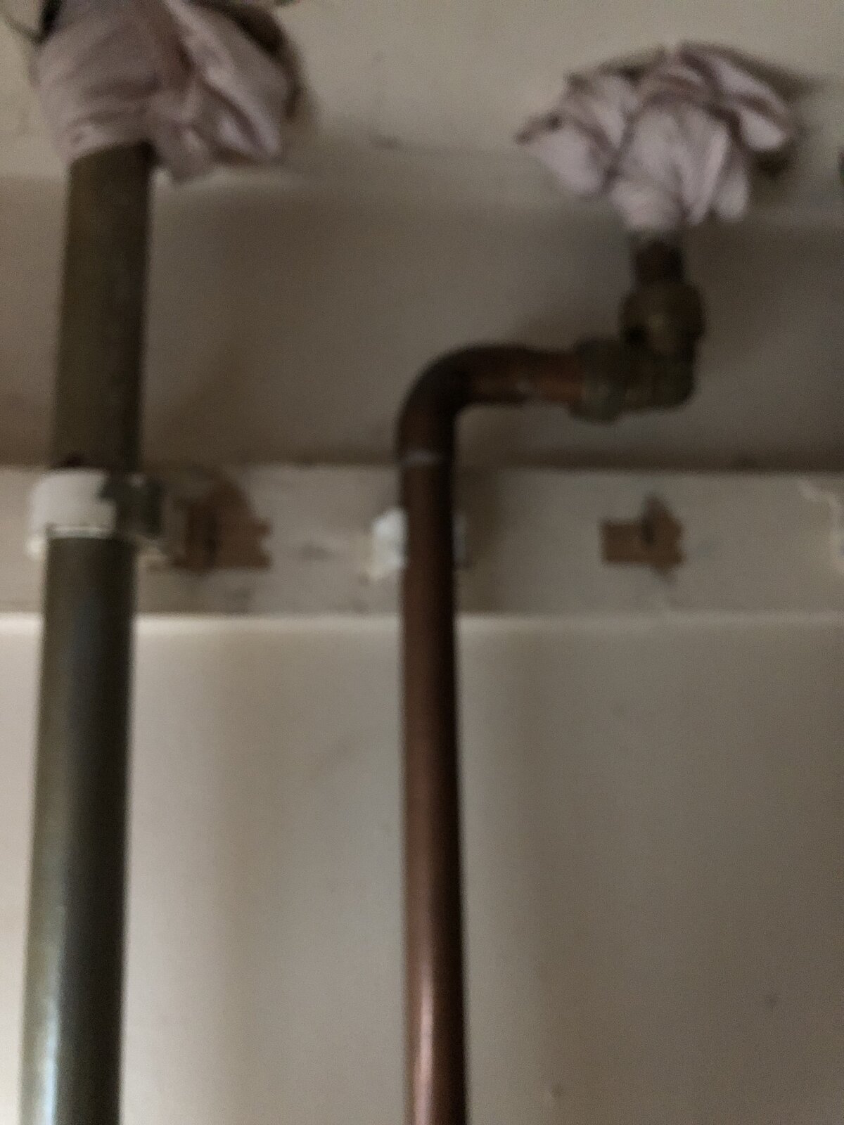

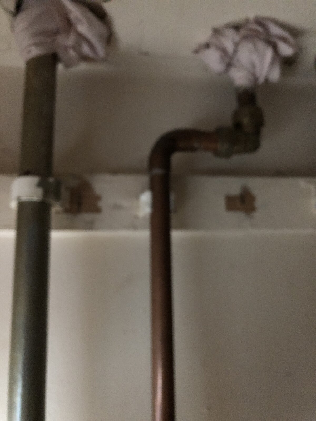

Thanks John. Will give the plastic bag a go first. This my feed and vent just before going into the loft. So I can disconnect 15 mm elbow and t into 22 mm vent? Then cap disconnected feed pipe here and connect lever isolating valve/gate valve.
ps never got round to filling ceiling gaps properly

Not sure what you mean by the other side, if you want to leave a section of the cold feed in place incase you want to revert to your original then you you cut it close to where you are Ting it into the vent, that only leaves one end open, this is where you install the valve as this leg will fill with water and the valve can be opened to vent the air out of it and closed when water comes out.
If you do a permanent mod then cut the cold feed say 80 to 100mm or so above the main flow pipe and just install a compression coupling with its end capped off.

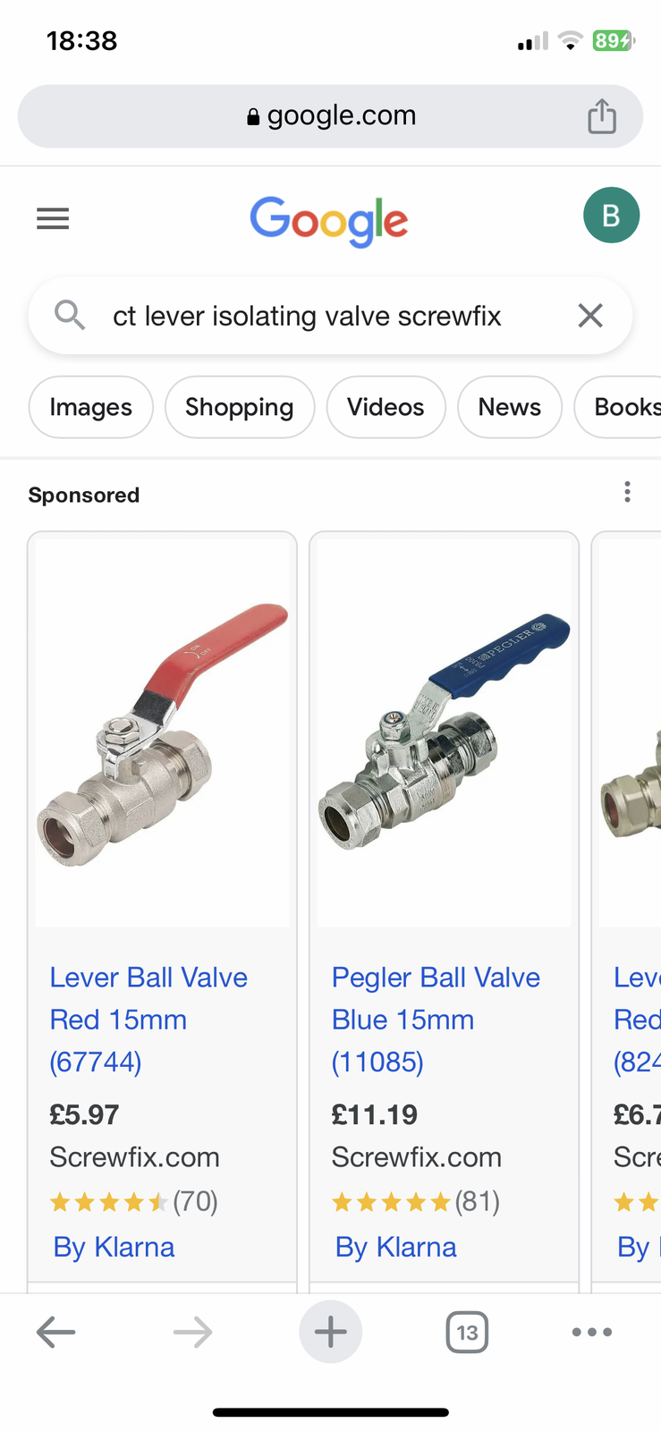

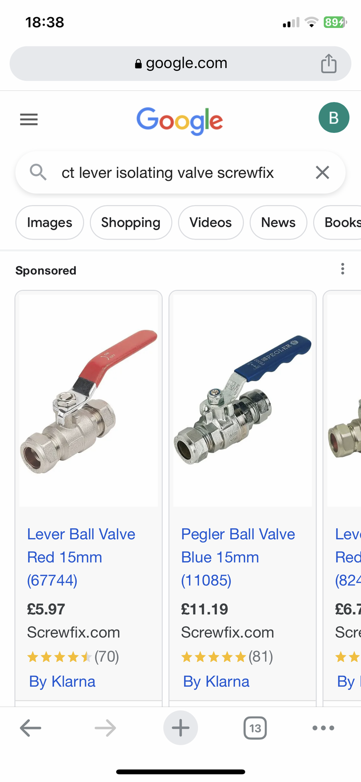

Sorry John but Looked for a valve that could be suitable. So original feed pipe goes into one side. What do I do with the other side?
